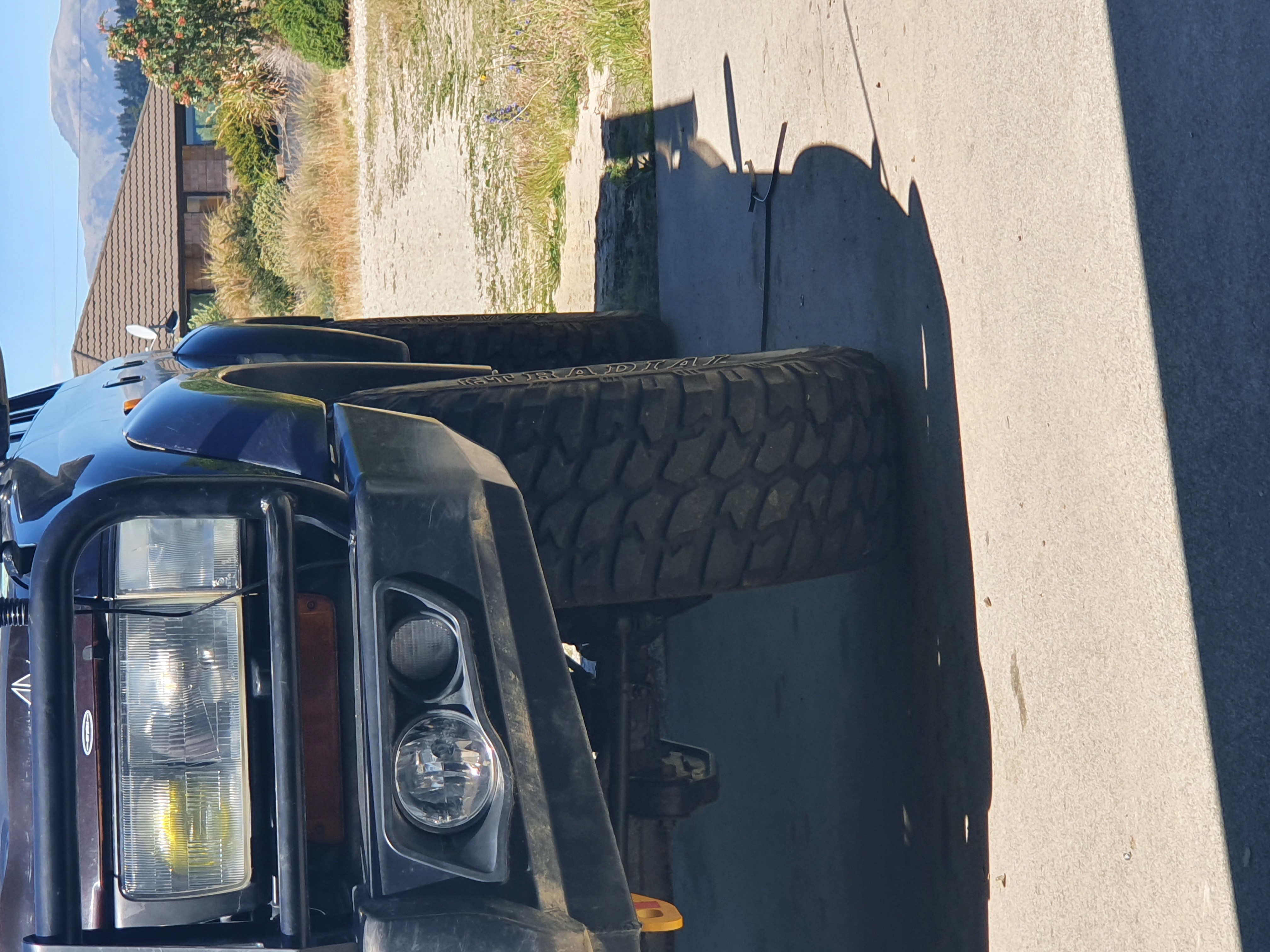

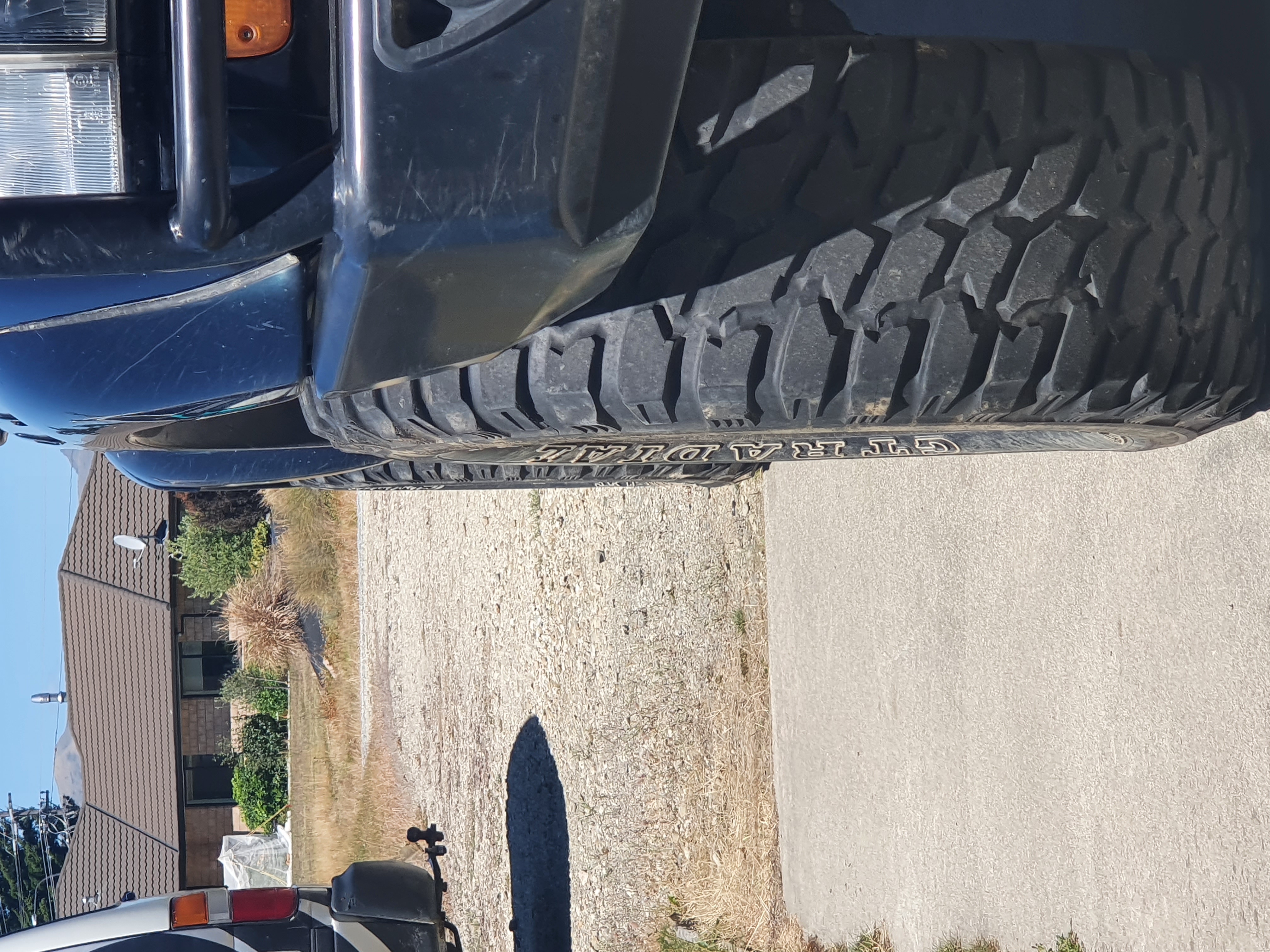

Both front wheels leaning to the drivers side at the top \ \ king pins and everything else seem fine that i can see.. would axle and housing bent cause this?

Its about the same both sides, i have checked king pins and bearings.
I suspect iv bent something serious?

looks like the king pinss have been installed wrong ? otherwise there is no way they should be like that..check them to see if they have colapsed.. lift the front axle and push pull top and botton to see if there is any movement..

No movement in kingpins, iv checked them also, and their bearings are ok too.. might just havto bite the bullet and take it to the shop

Thr drivers side looks normal, but the passenger side is the one I would be worried about. It could just be a bent housing.

Yeah man, using a straifght edge and good eyesight the drivers side is just as bad, could anyone help me in the way of finding a new housing?
