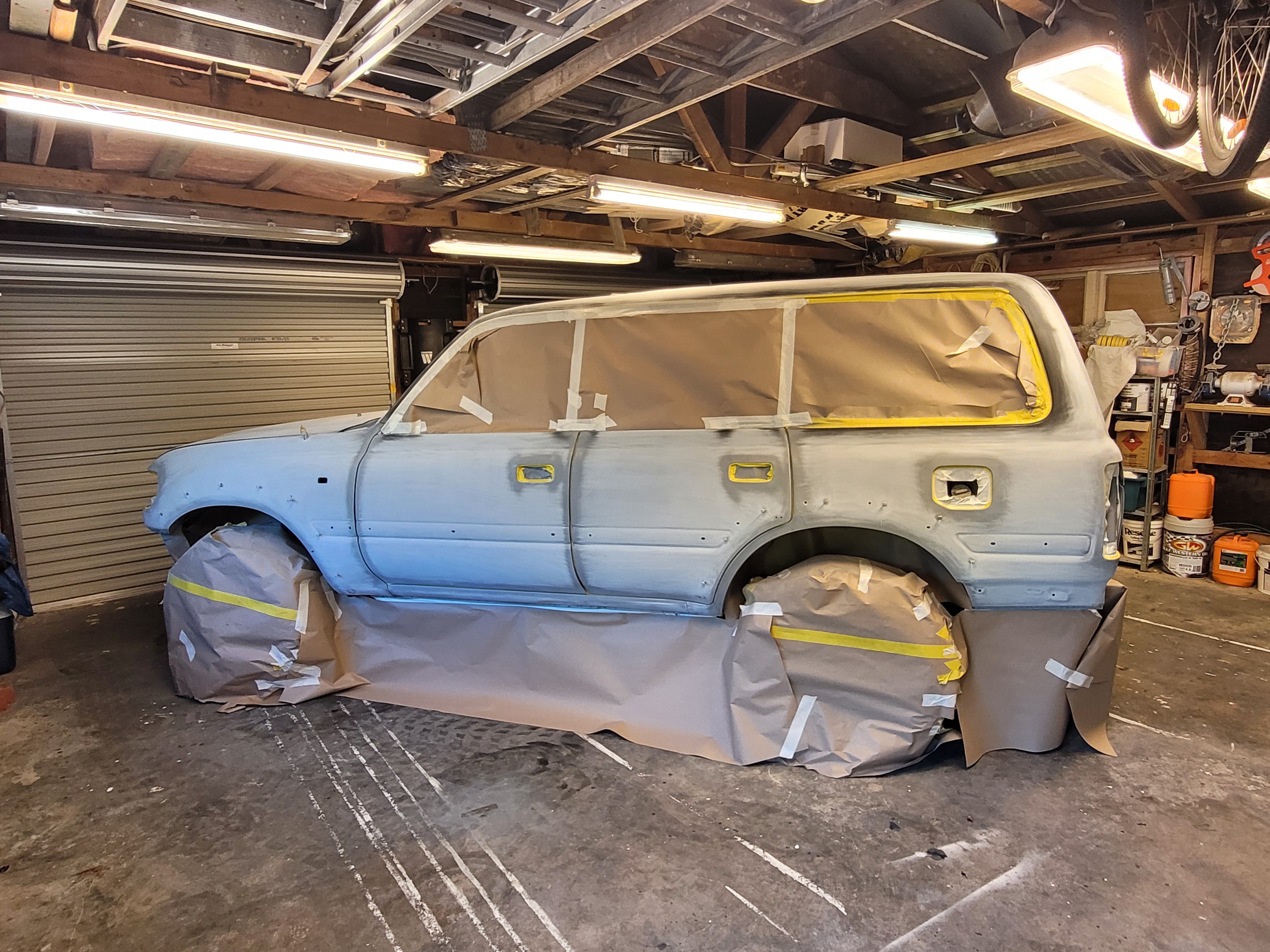

Re: My 80 matey restore
After a long break and back into the warmer weather, I've managed to get it fully primed and ready for the top coats.
