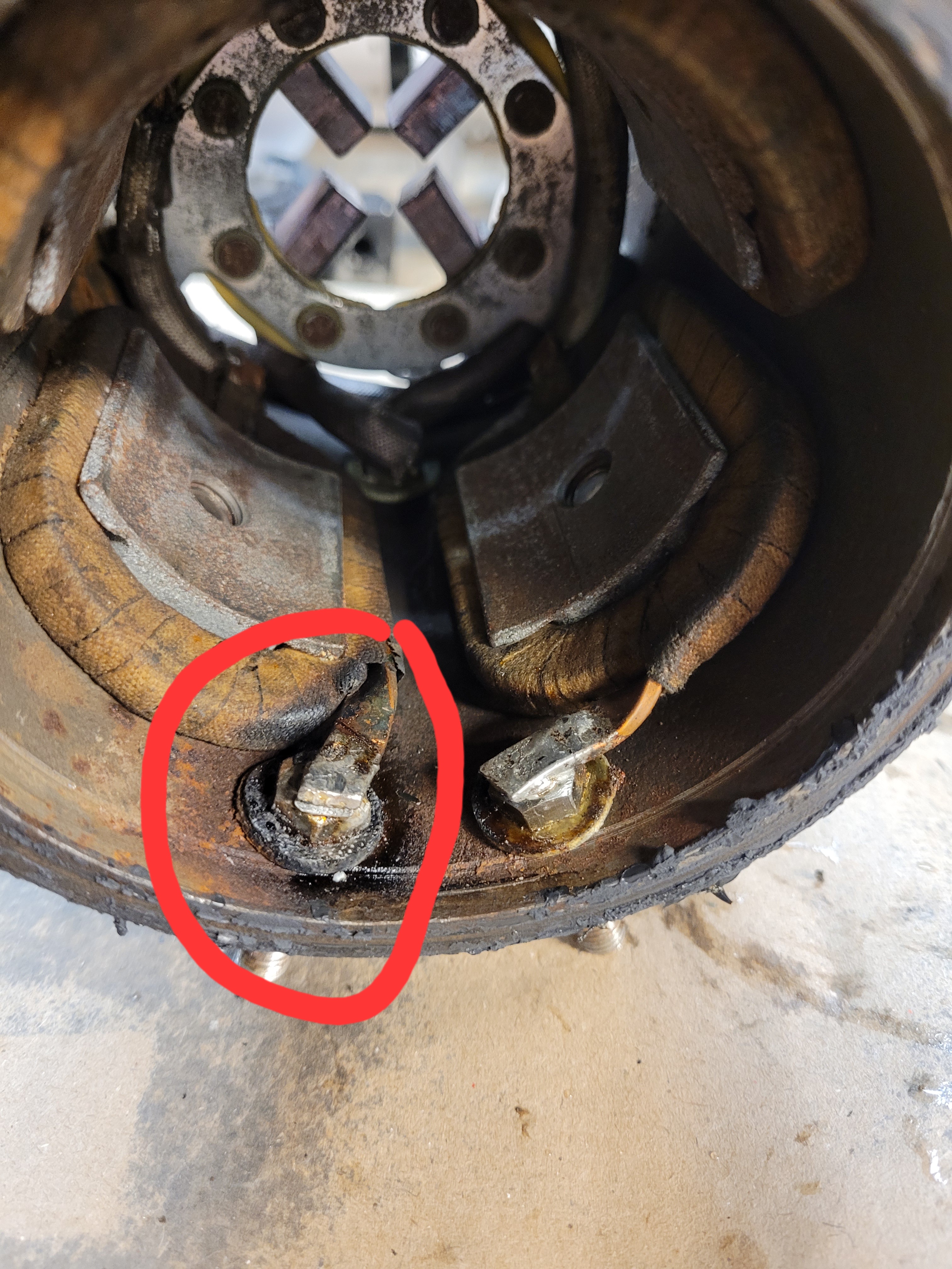

Well, it's been a bit of a slow start.
Daughter's car had to come off the road for a bit and I had to rebuild the A pillar. (Bloody 90's Hondas)
Anyway, reinstall the last CV. Wheel bearings could do with some love. The grease has certainly seem some water. Have heard that those AVM manual hubs can let a bit of water in, so will explore the pros and cons of going back to fixed. The transfer system is a bit different to the 80, where I get a 2WD option. But the whole front drive train would still be spinning with hubs fixed.
Thought I would start off with a bit of a more detailed inspection.
Front diff oil looked like grey slime, transfer case had about a quarter left in it. Home-made air box seemed more like an oil transfer system with the amount of shit being recycled from the rocker cover. Will either put in a catch can or just extend the breather into the chassis (self anti rusting technique )

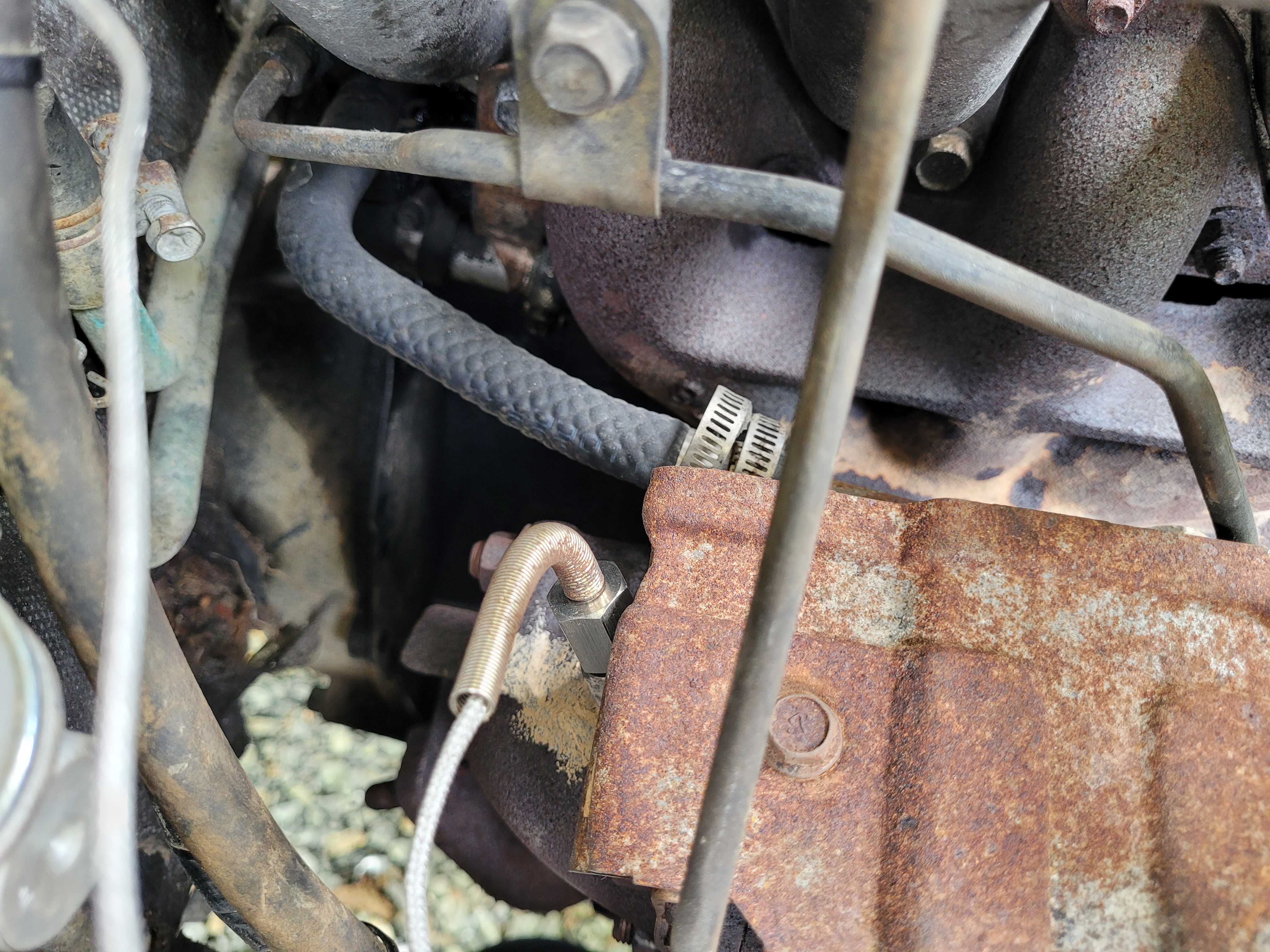

Radiator is being pressurised and so slowly blowing water out the overflow. I reckon stuffed headgasket at the least, maybe head. Will plan on whipping this off when convenient.
Found some rust in the back right cover of the boot. Easy fix and will plate it back up. Removed the remaining carpet and all looks good.

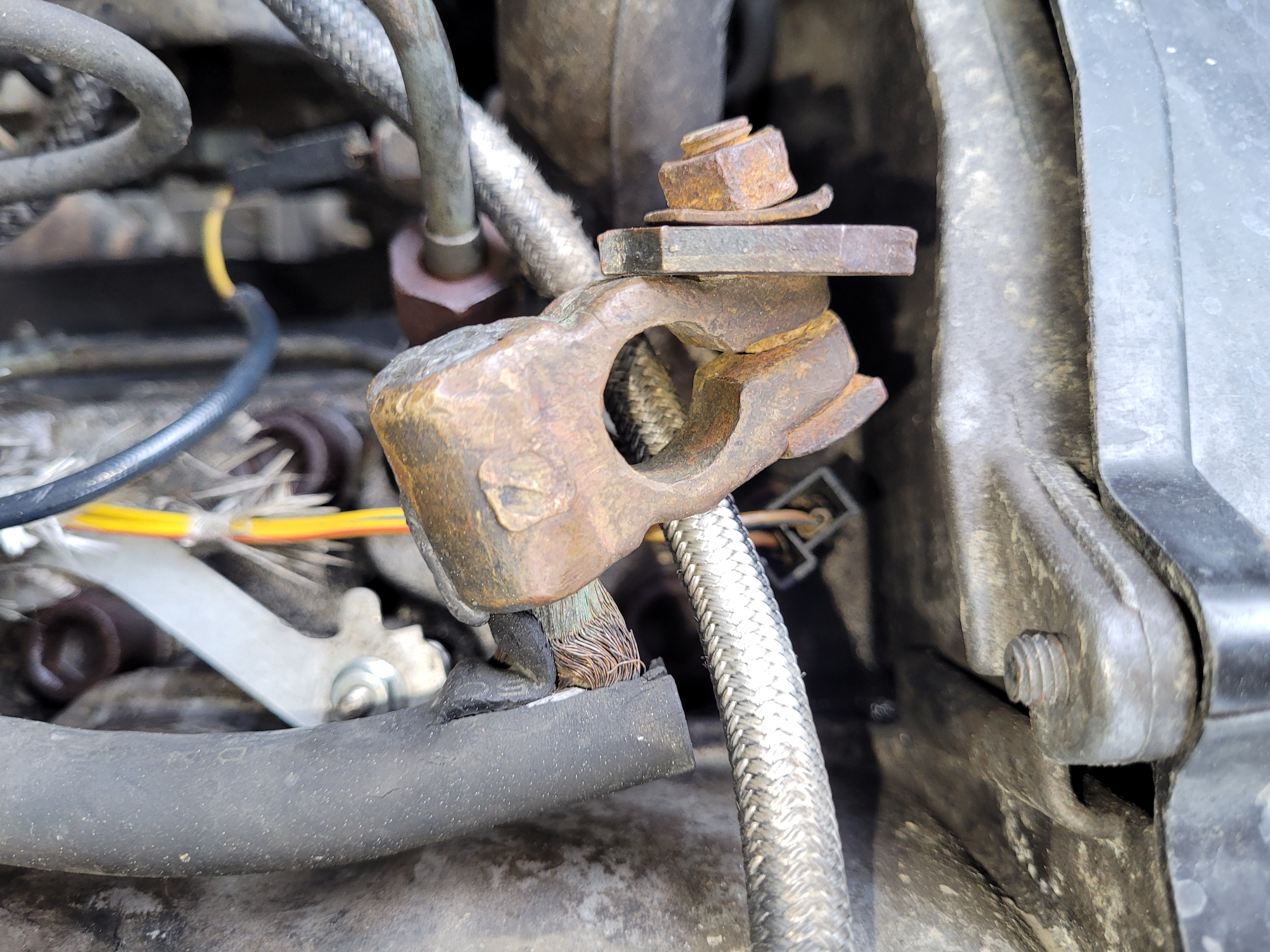

Wiring for the motor is as tidy as my teenagers bedroom. Plus seem to be missing a number of controls in the cabin.
Check out that earth srap bro...

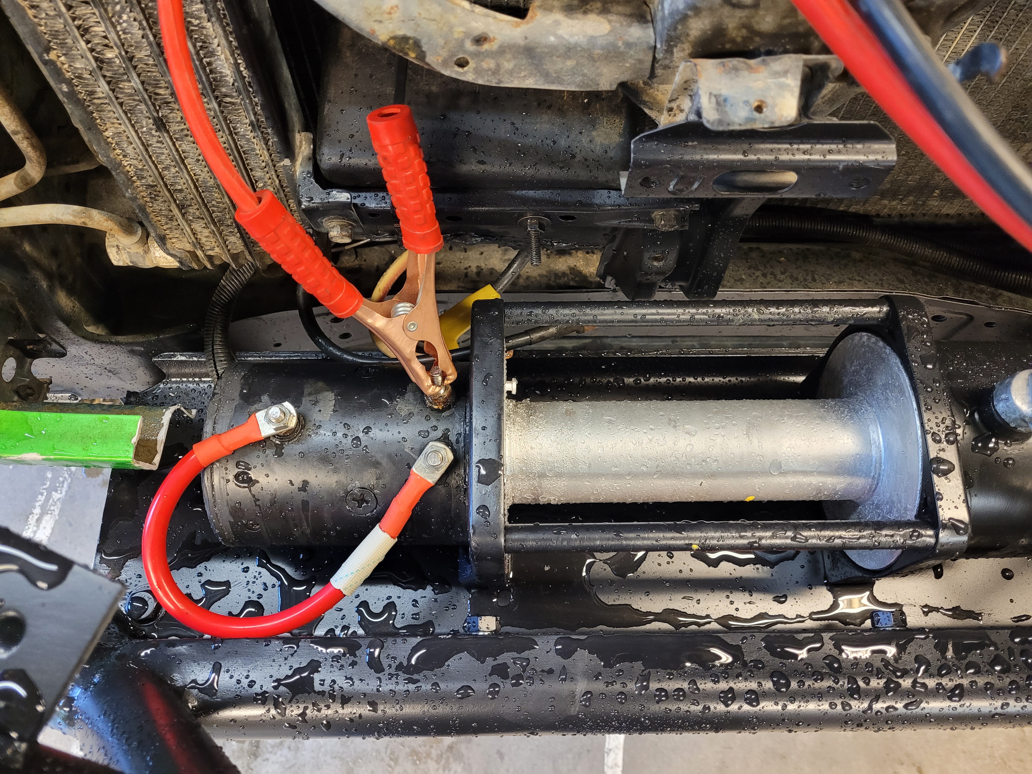

Winch isn't running, Well not even wired in. WTF
Seems like someone was hungry and had a chew on the drivers seat.
So for a start I've flushed and replaced all the oils for diffs, transfer, Gbox, Engine. Actually runs a bit quieter now.
Whipped out the airbox and will replace that useless pod filter with one of those Ryco O2 Rush filters. (Better filtration and cleanable)

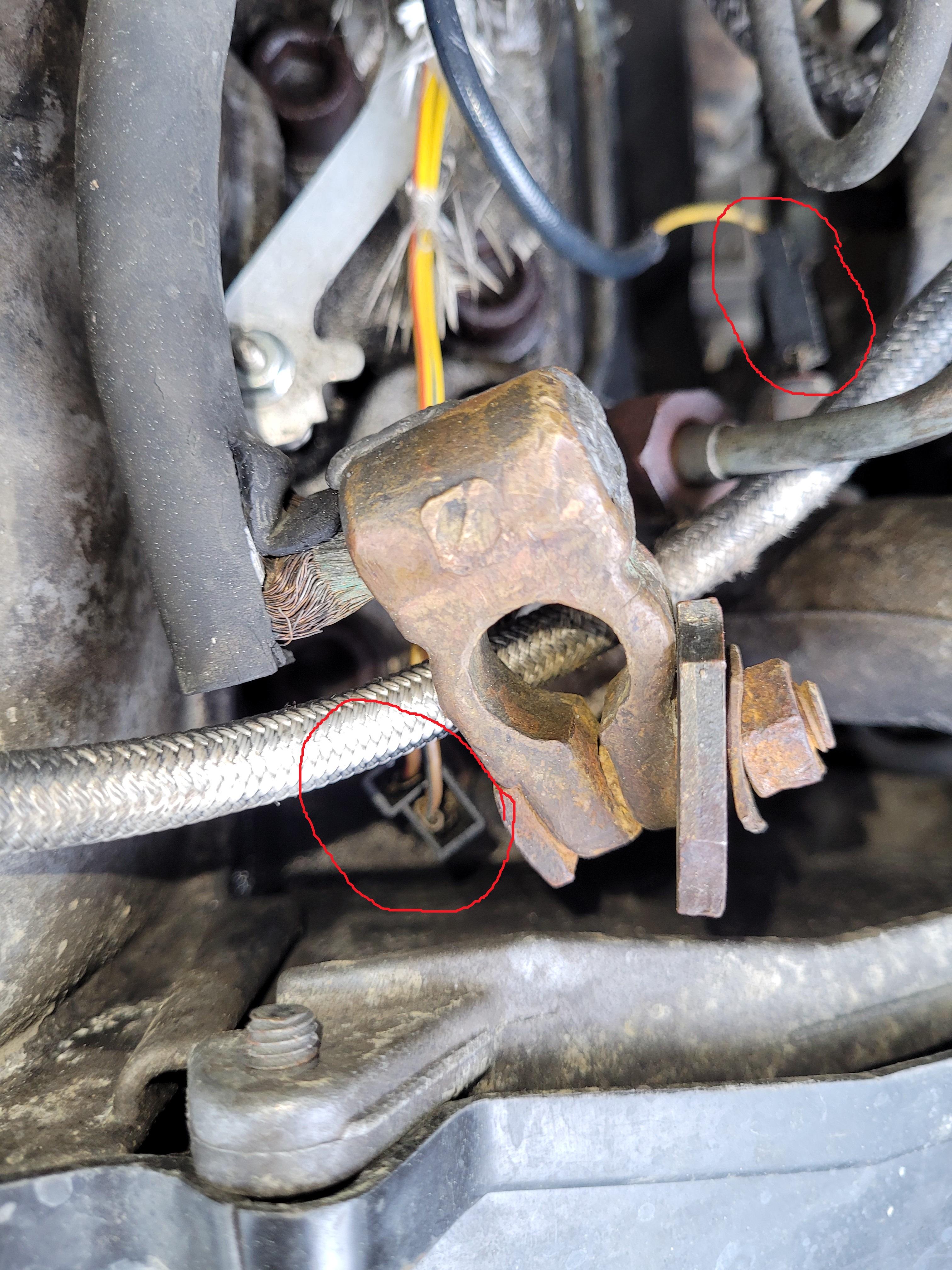

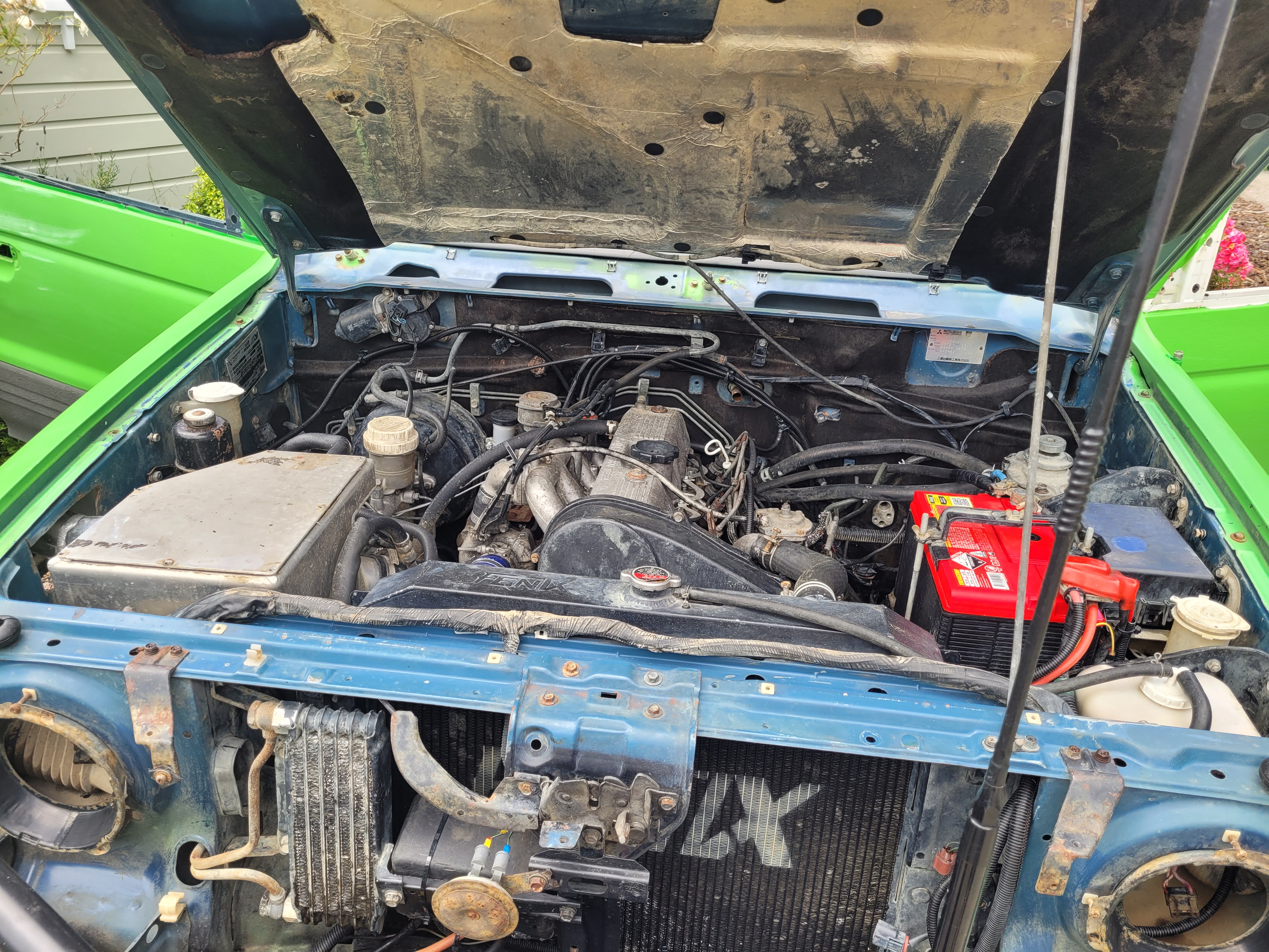

Right, decided to tackle the wiring!! What a bloody birds nest! So annoying when people just twist the wires together and slap a bit of masking tape over it
I've pulled almost all of the dash out to trace all the wiring. Since it had a 4D56T transplant, I needed to find some of the dodgy wiring and correct it. Looks like I need a new water temp gauge as the sensor wire goes no where.
There are two senders / sensors and from what I can work out, the one in the upper radiator hose housing is the gauge temp sensor (single pin) and the larger one (2 pins) in the head is for the glow plug temp sensor. (circled in RED)
LoL, that earth strap connection is a crack-up.
Anyway, I'll replace the sender unit to match the new VDO gauge.

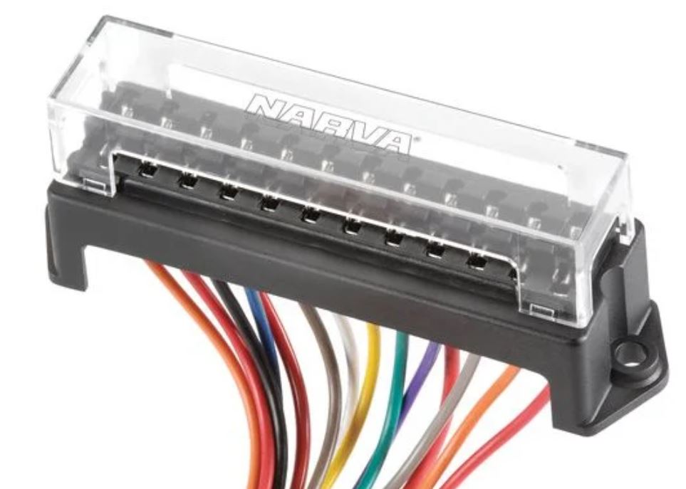

Have pulled out all the redundant wiring and ordered some new power distribution/fuse boxes to clean everything up.
I've also been through and labelled all wiring that was added with the transplant.
Still more to do, getting there slowly.

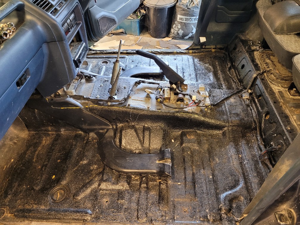

Stripped out the back end also to see if there are any more treats.

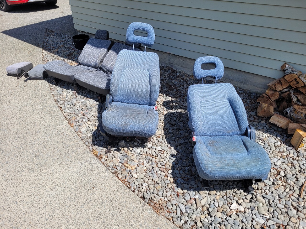

Also soaked the seats in soap and water blasted them. They will do for a while and will just put the sheepskin covers on.

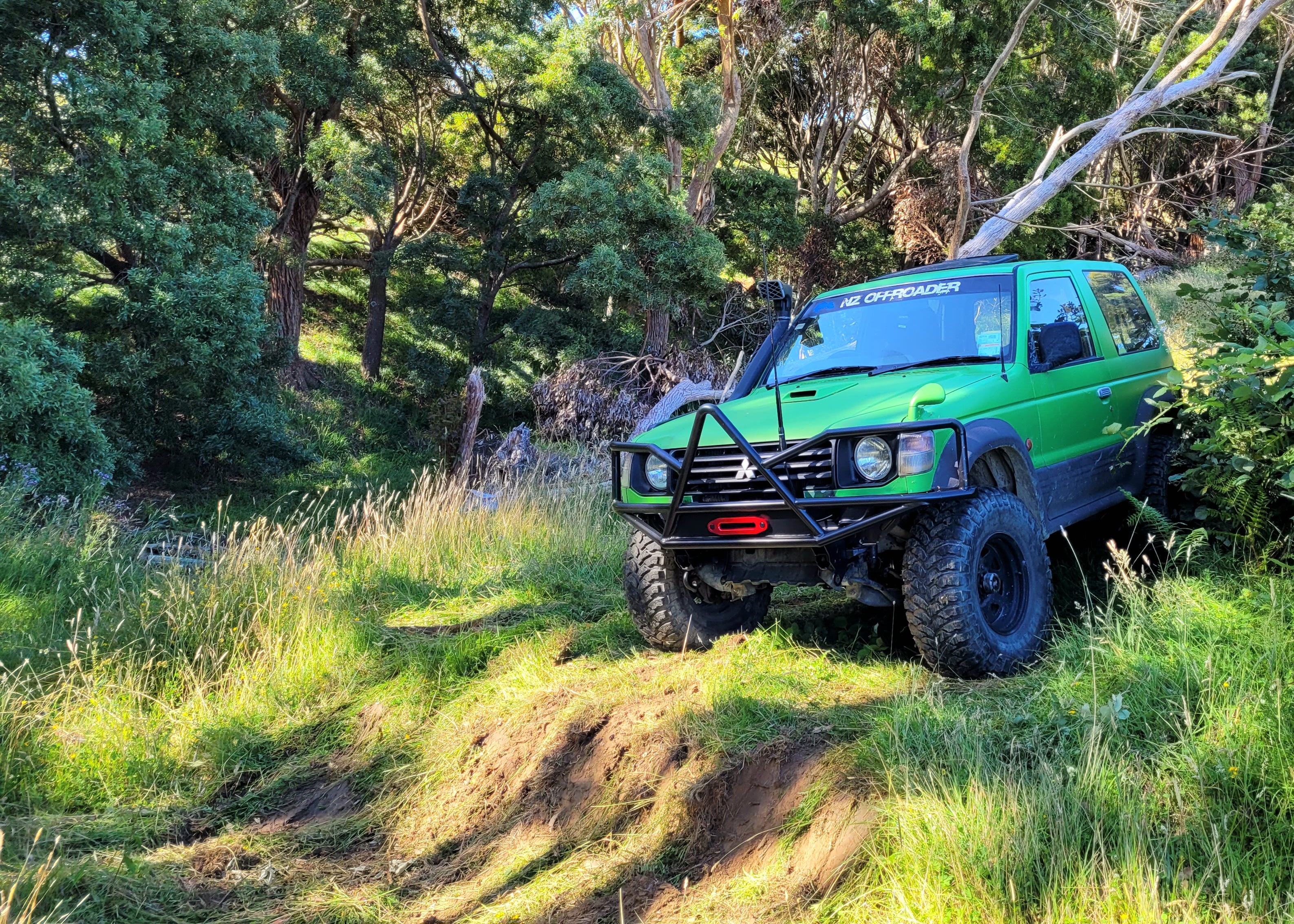

Thought I would take it for a small adventure into Rallywoods this weekend. I'm sure the rest of the lads (with their cruisers and safs) were thinking WTF is this green monster that has crept up on us in the bush...LoL.
Anyway, just wanted to see how it handled offroad. A very different experience from the 80, driving this thing that weighs bugger all, is manual and has plenty of traction.
Didn't take it down anything too hard since I haven't connected the winch and it doesn't have any recovery hooks....yet.

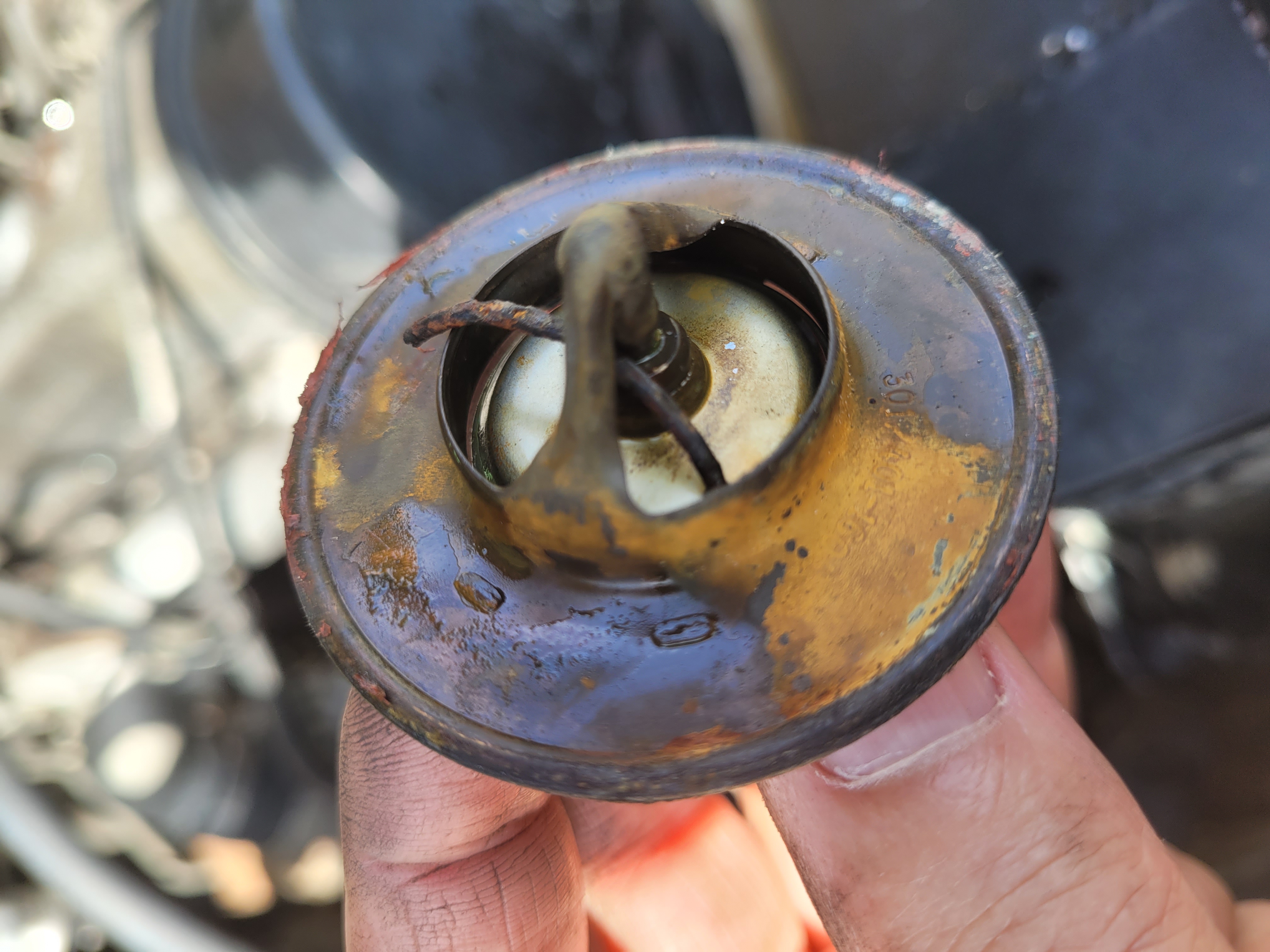

With the new gauge and sender I did notice that the temp was creeping up a bit and wouldn't maintain a normal running temp. Was sitting around 60 degrees cruising down the road.
So this weekend....

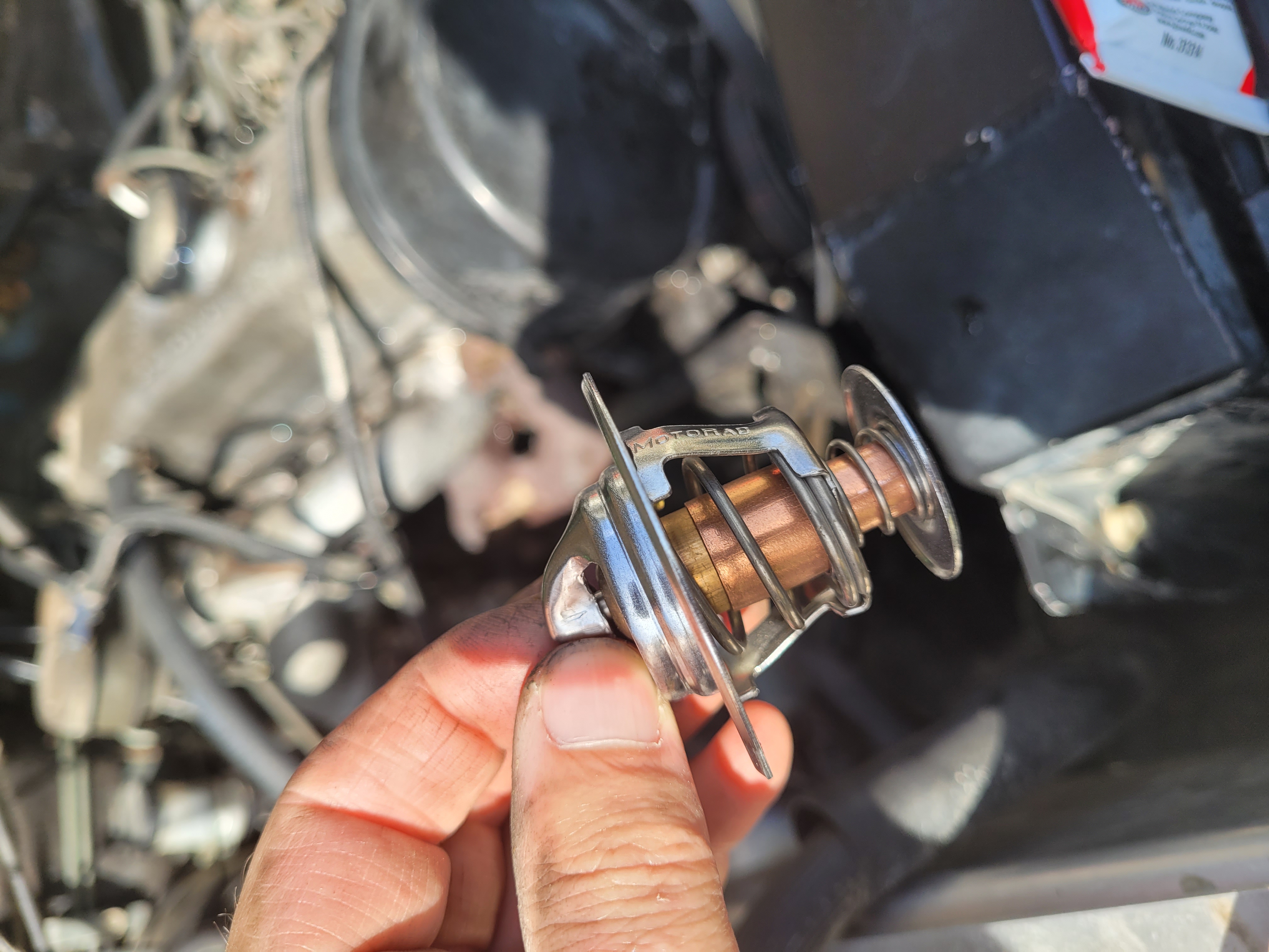

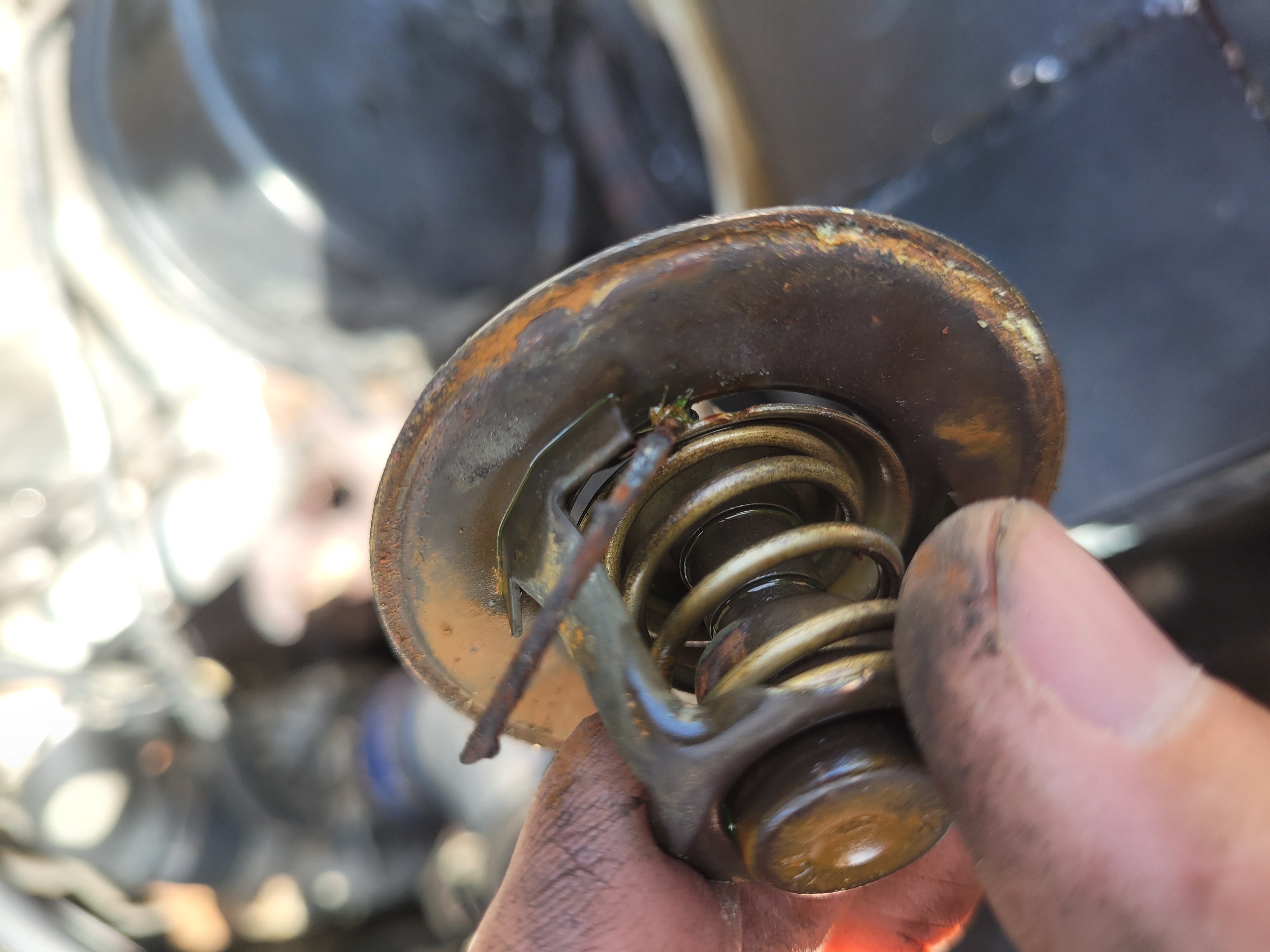

Popped in a new thermostat, and to my surprise I found the temp regulation problem.
The existing thermostat had been put in the wrong way and had been jammed open with some wire. WTF
New thermostat (correct thermostat) looks much better. A bit tricky to get in as you need to put a dab of high temp silicone to glue it in place.
Runs perfectly now. Maintaining around 80 degrees and gets only to 95 on a long uphill with my foot in it all the way.

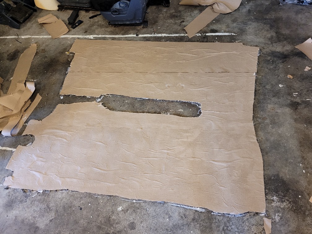

Also made a new gearbox floor moulding out of a rubber car mat. Just glued and screwed.
Looks a lot cleaner layout now. And those sheepskin covers, you would think you were driving a rolls.

Wanted to tap in the EGT probe so I could start playing around with the tuning.
There seems to be a few 4d56T variants out there, taking about inserting the probe through the EGR blanking plate, but mine doesn't have that.
Only place I could find suitable was in the turbo dump pipe. Will give me an indication of Temps.
Anyway, as you can imagine it's a right shit to get at. The nuts were seized more than my back. Applied plenty of penetration lube and soaked for a while and bingo.
Removed the dump pipe and tapped the probe in.
Took it for a fang around the neighborhood with just the dump pipe.
Neighbors love that sort of thing on a quiet Sunday afternoon. Reading reasonable EGTs now, so can tickle it up a bit.

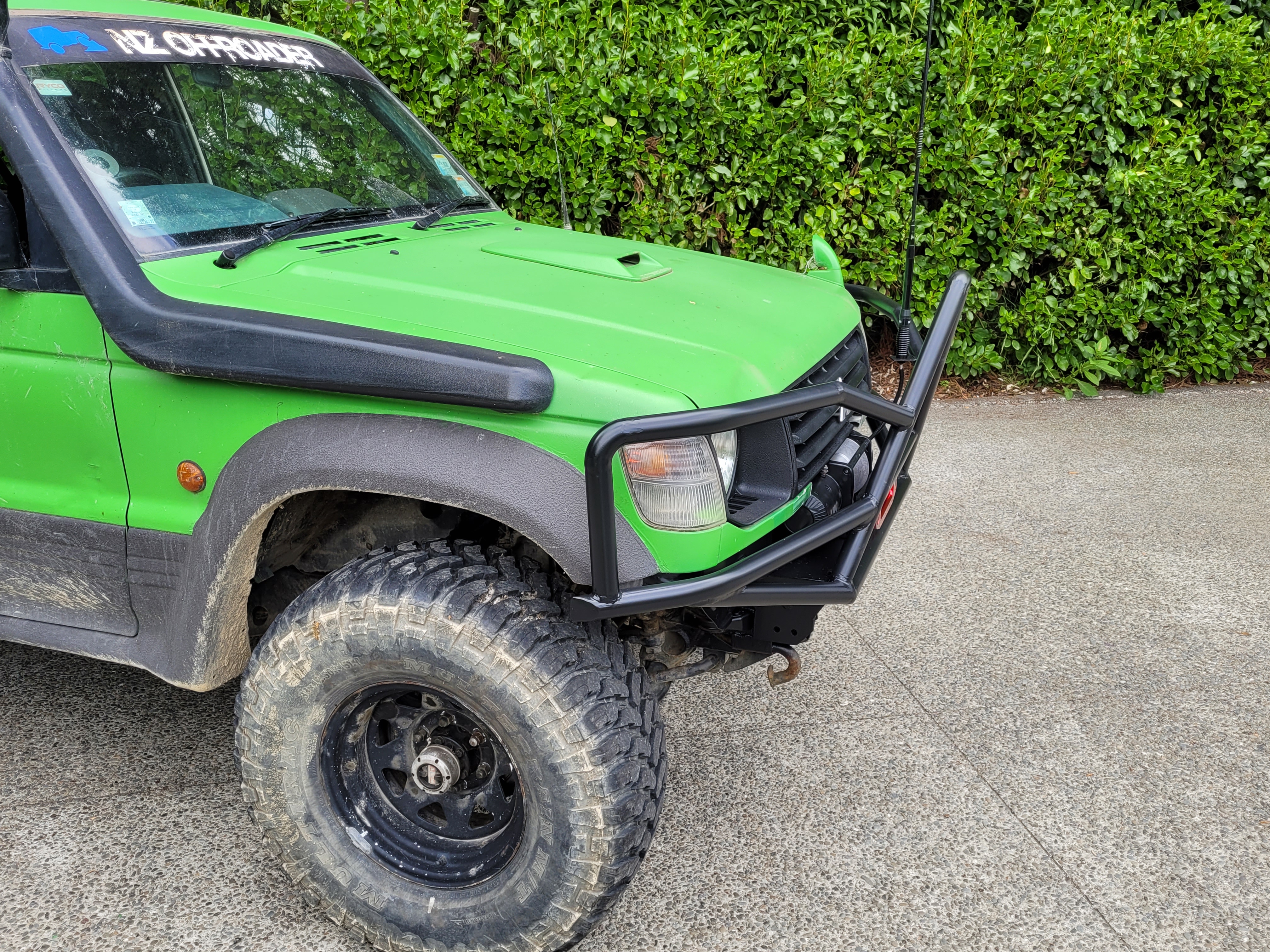

Well just before the Xmas shutdown I managed to secure a custom made (6mm) winch plate, 32mm NB medium wall pipe and some welded elbows so I can build the barwork over the break.
Best prices for the pipe was from United Steel in Seaview.
Have just tacked together the middle section today and will finish the rest tomorrow. Will then weld it all up and paint.

Well, my brand new dyneema arrived and thought I would wind it on, only to find the winch didn't work.
It bench tested fine after the rebuild, but no power. Jumped the winch to test the motor itself and confirmed it was a no go.
Pulled it out and stripped down the motor to find the problem. Under a bit of load, the solder heats up and as the connection had bugger all solder, it just popped off. Will re-solder all the connections properly.
Added some in cab controls for the winch also.

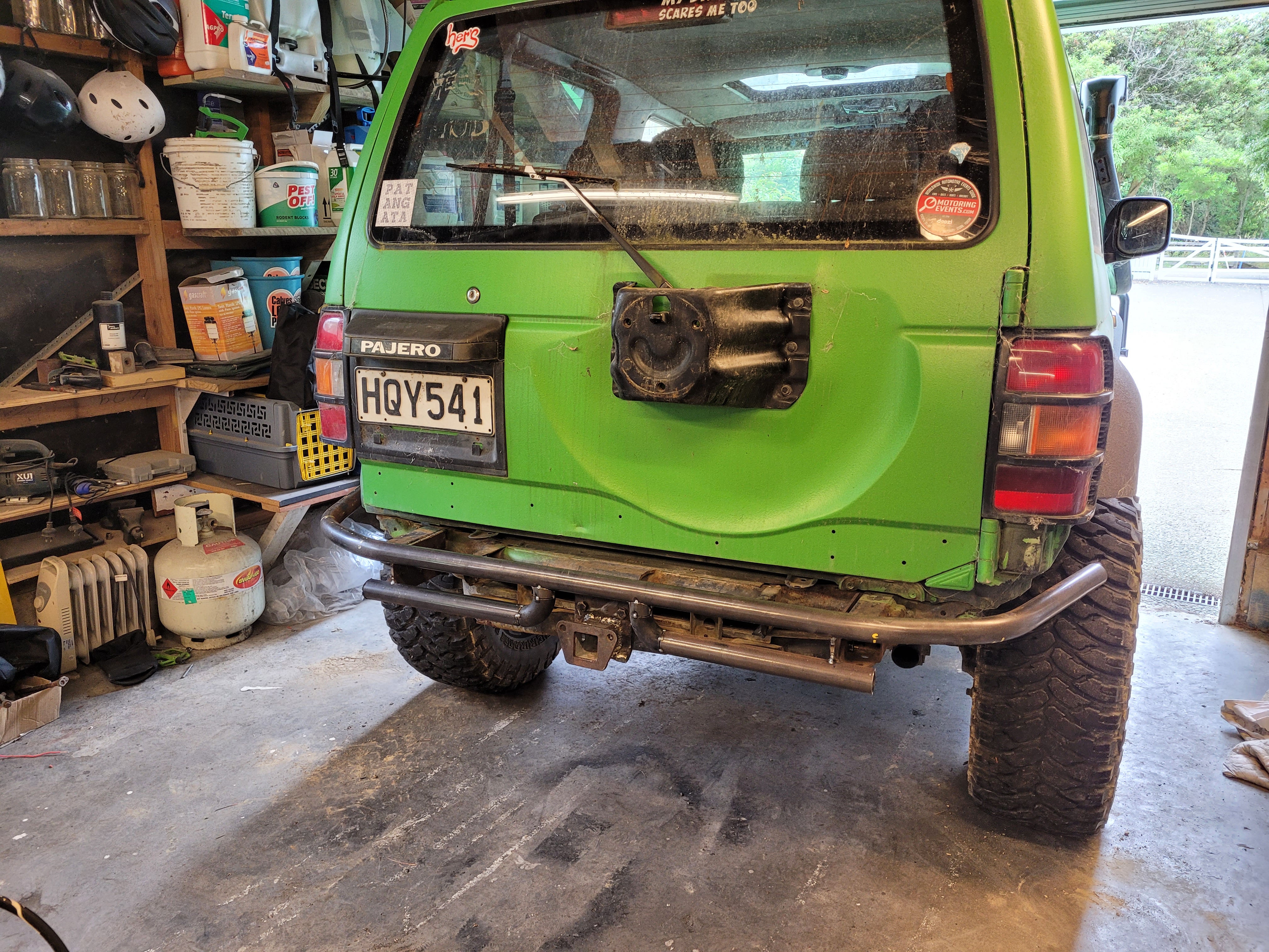

Last couple of days have been designing and building the rear barwork. Added a dedicated hitch receiver (seperate to the barwork) and got the bones of the work done.
Just need to make up the sides and weld it all up.

Well finally finished the front and rear barwork.
Whilst at it, I cleaned up the chassis area, red oxide primed and a fresh coat of black.
Will work on the sill protection a bit later.

For this weekends adventure, I thought I would put some nice new carpet in. The noisey sealed floorpan was getting to me and I like to roll in a bit of style and comfort.
SO, I had some nice leftover carpet. At $500/lm she's the best on the market. But you need to treat it.
Firstly cut it all out and into shape. Fit to vehicle with all the mounting points. Remove and coat the entire backing with aqualine PVA glue and then place a layer of high GSM paper across the back. Refit to vehicle. Bolt everything down and let it set.
What will happen is that the carpet will hold its mounded form. Be really strong and backing cannot seperate or rot out.
Put in some nice new mats and you would think the queen was coming for a spin up Odlins Rd

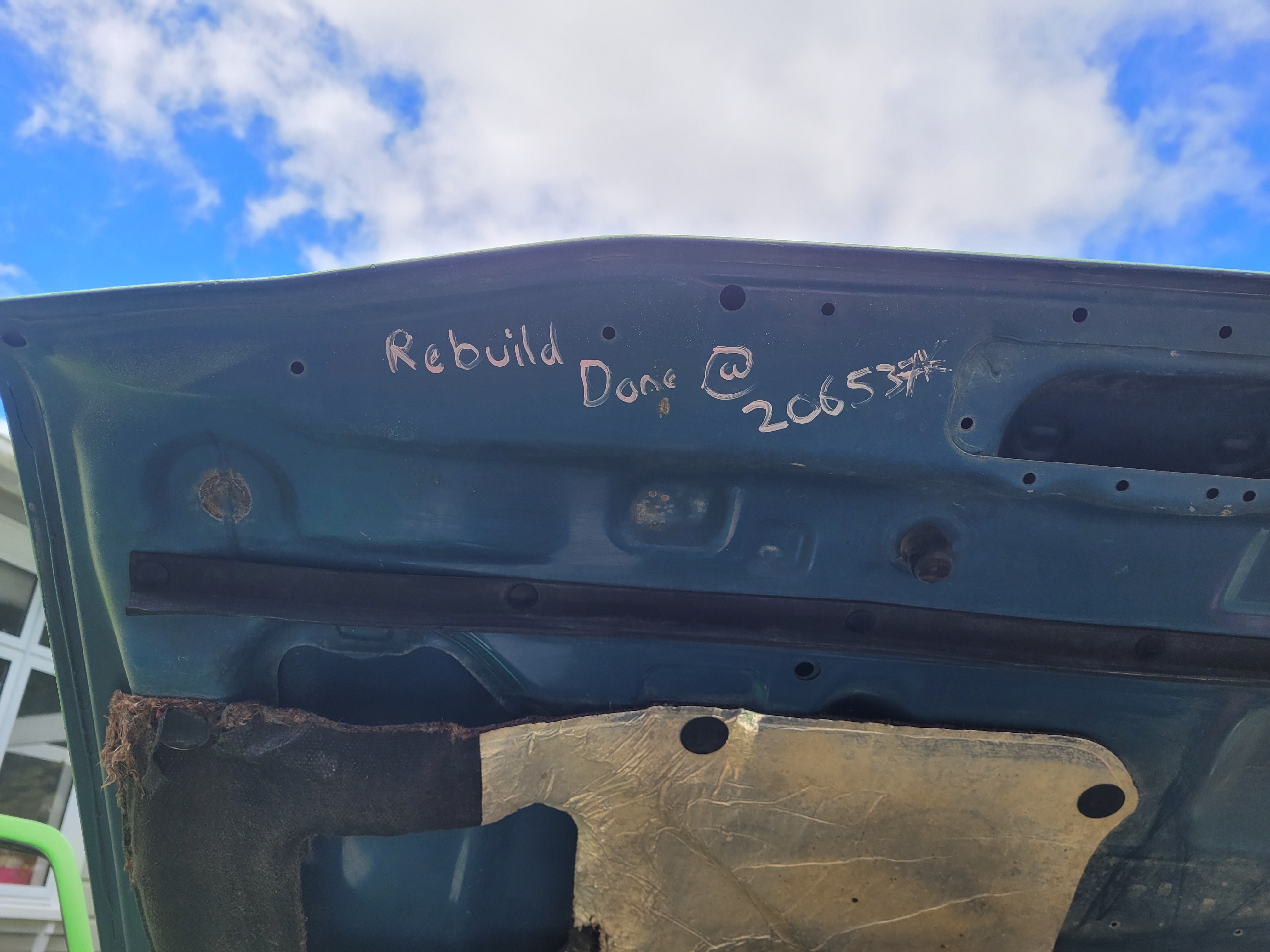

Note to self, last rebuild....before I paint over it.
