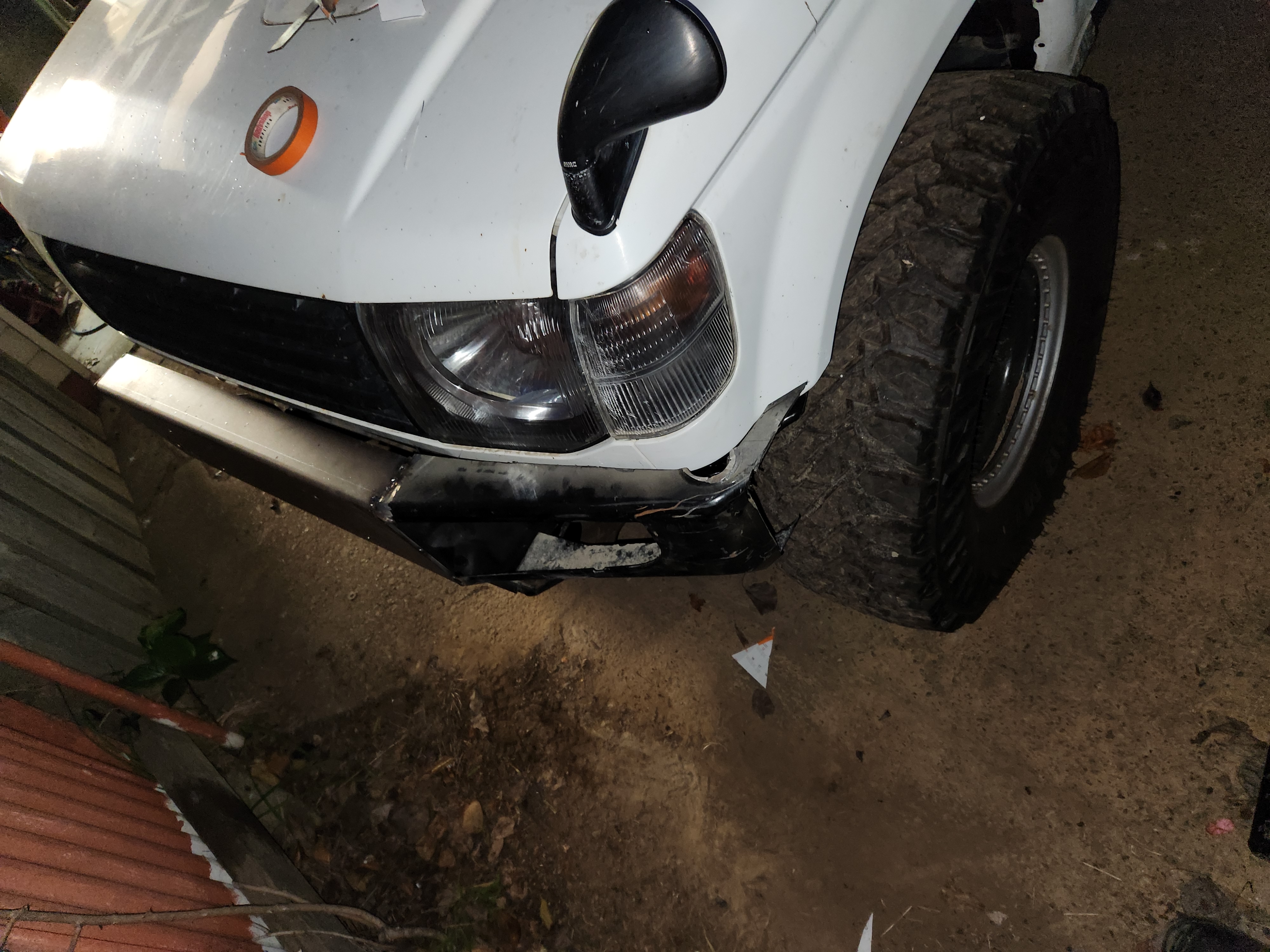

I picked up a $30 plate style bar from the scrappy ex 79 series cruiser
It was way to wide too far off the body but how ever it was $30 so chopped it up and found the center section was able to work but then while looking I found a 8274 so that blew out and ment I needed to get a new section cut and folded (Anomaly offroad did this for me bloody top bloke ! )
So that's where I'm at currently bull bar at the front to be made up and Finnish the rear bar
poor little suzuki :lol: :lol:

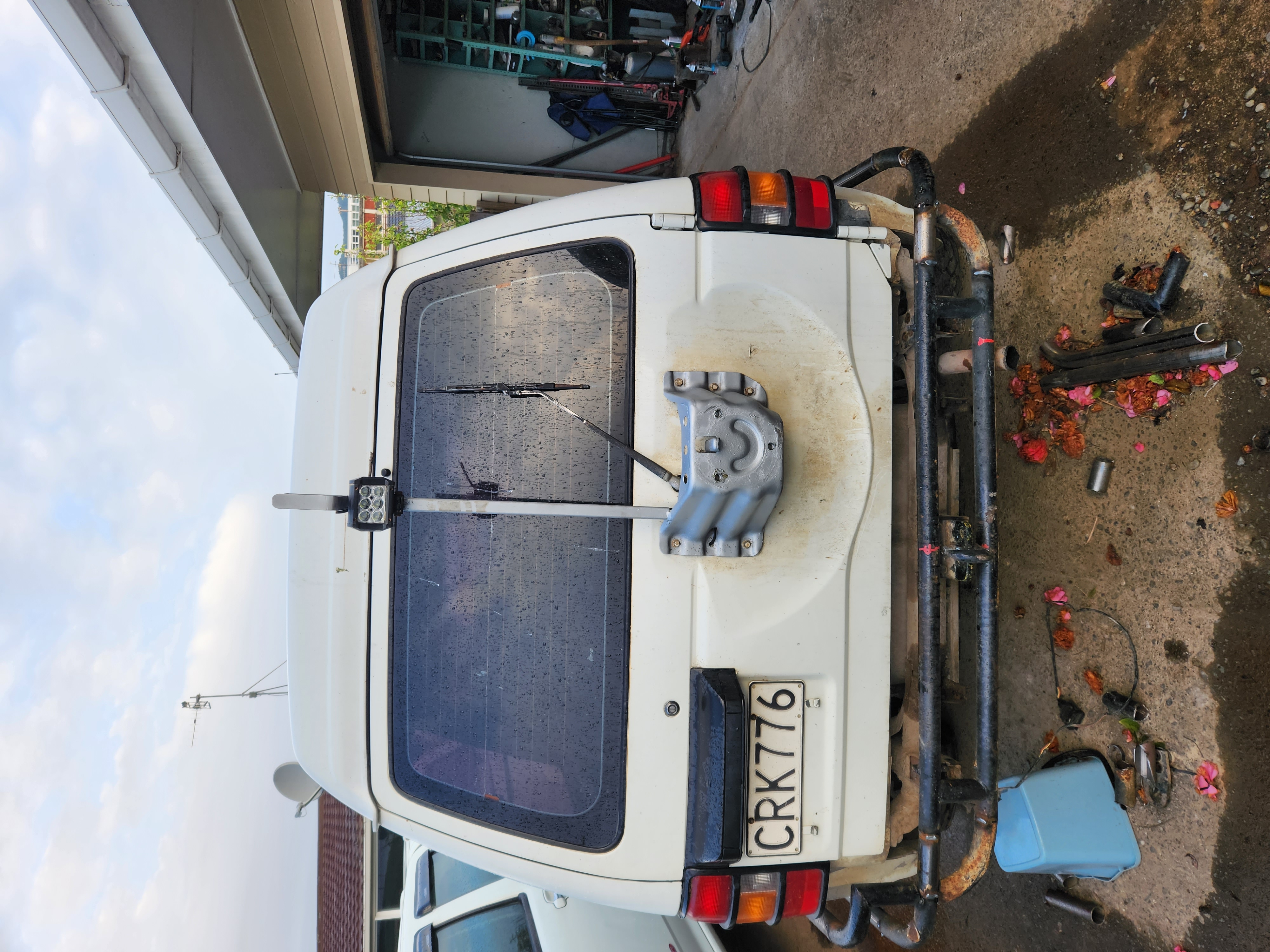

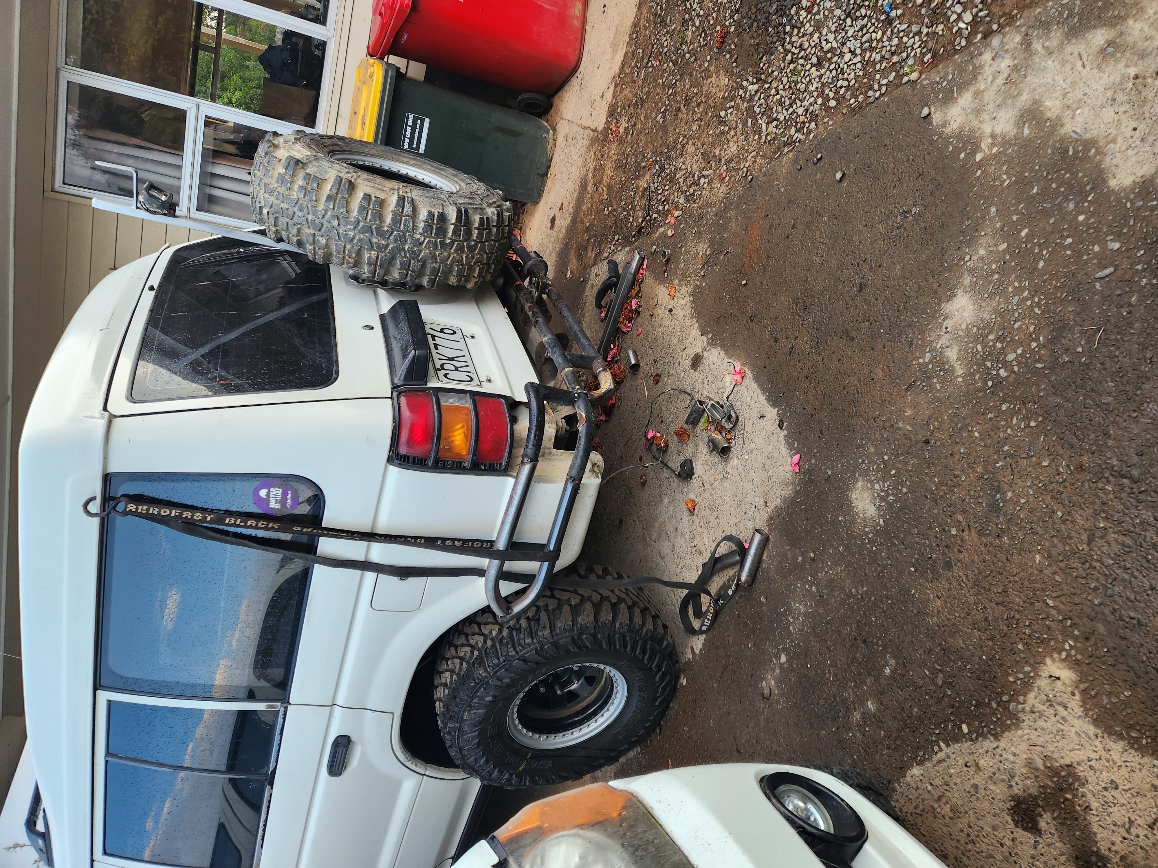

I've not quite finished it yet, I wrecked a swb and robbed it off it although having to chop the chassis off the swb as it was welded on haha
I'm mid way through making it work for the lwb had to cut to bits and it would have been easier to make a new one haha
Also had a spare 5 mins while baby was having a play so made up a strop hook for the rear to make life easier and get a reverse/work light up nice and high ,possibly making oading the buggy on the trailer easier ?

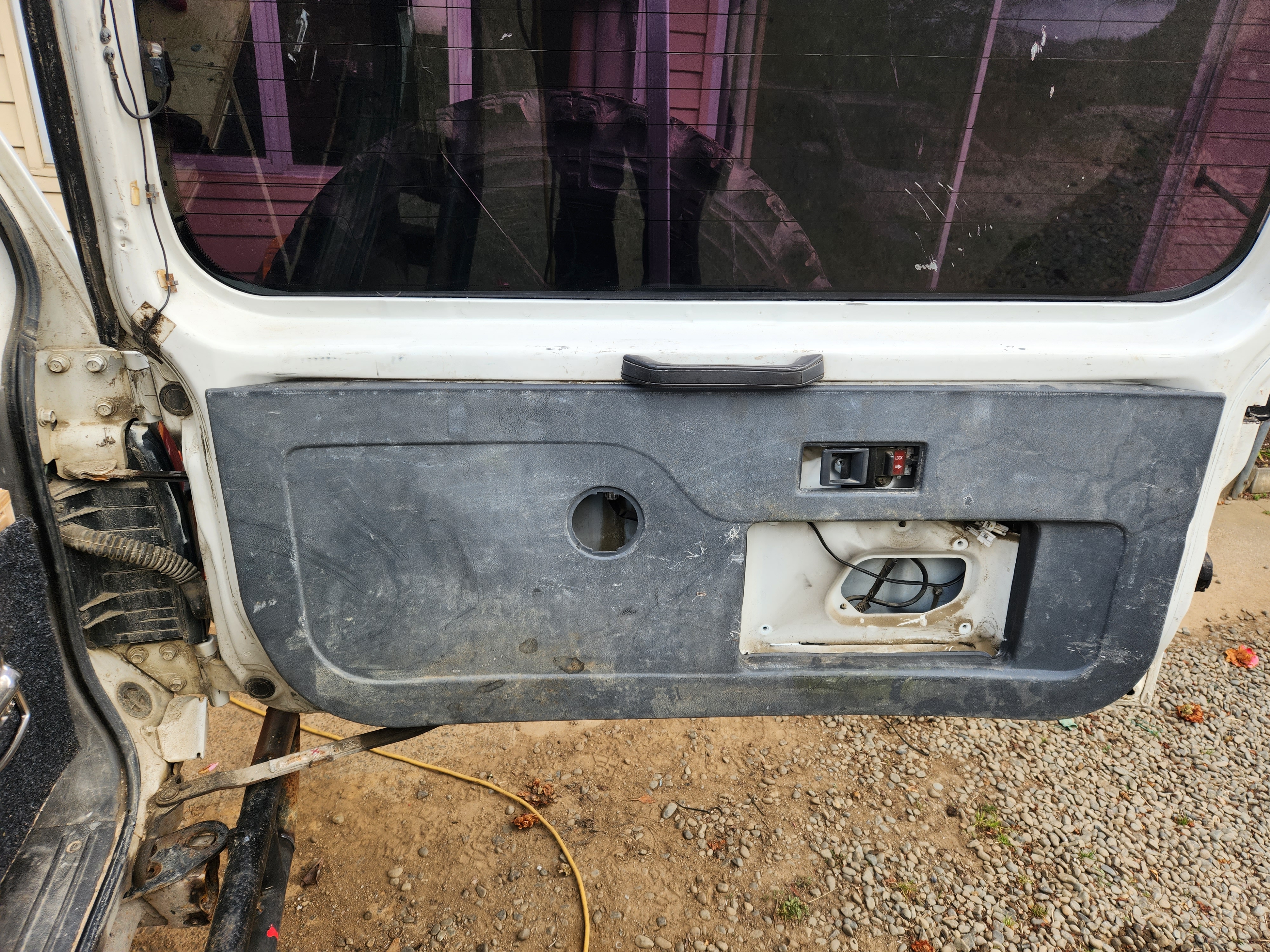

Ran wiring and fitted the reverse light / worlk light to the tail gate tonight
While the door panel was off I decided to fit the slightly nicer plastic trim vs vinyl and card one from factory
Ended up being a bit worse for wear so decided I'll try the heat gun trick from my motorbike days and try revive the plastics
Turned out ok not a 100% prefect but about 90% better than before
Will make some templates for the rear bar mounts and then I can finalize the left side rear corner for being level and inline with the body lines and then triple check my bars are parallel with each other etc

Got the rear bar all welded up and then this evening I primed it nice to see it one colour again and kind of taking shape
Tempted to weld some 2mm in round the tail light area to hide the body a bit as it looks a bit rude
Also chopped the 79 series bull bar hoops down to size and tacked the top in place
Got a bit late to make noise so couldn't cut the side hoops/ eyebrows down but will attack that Wednesday

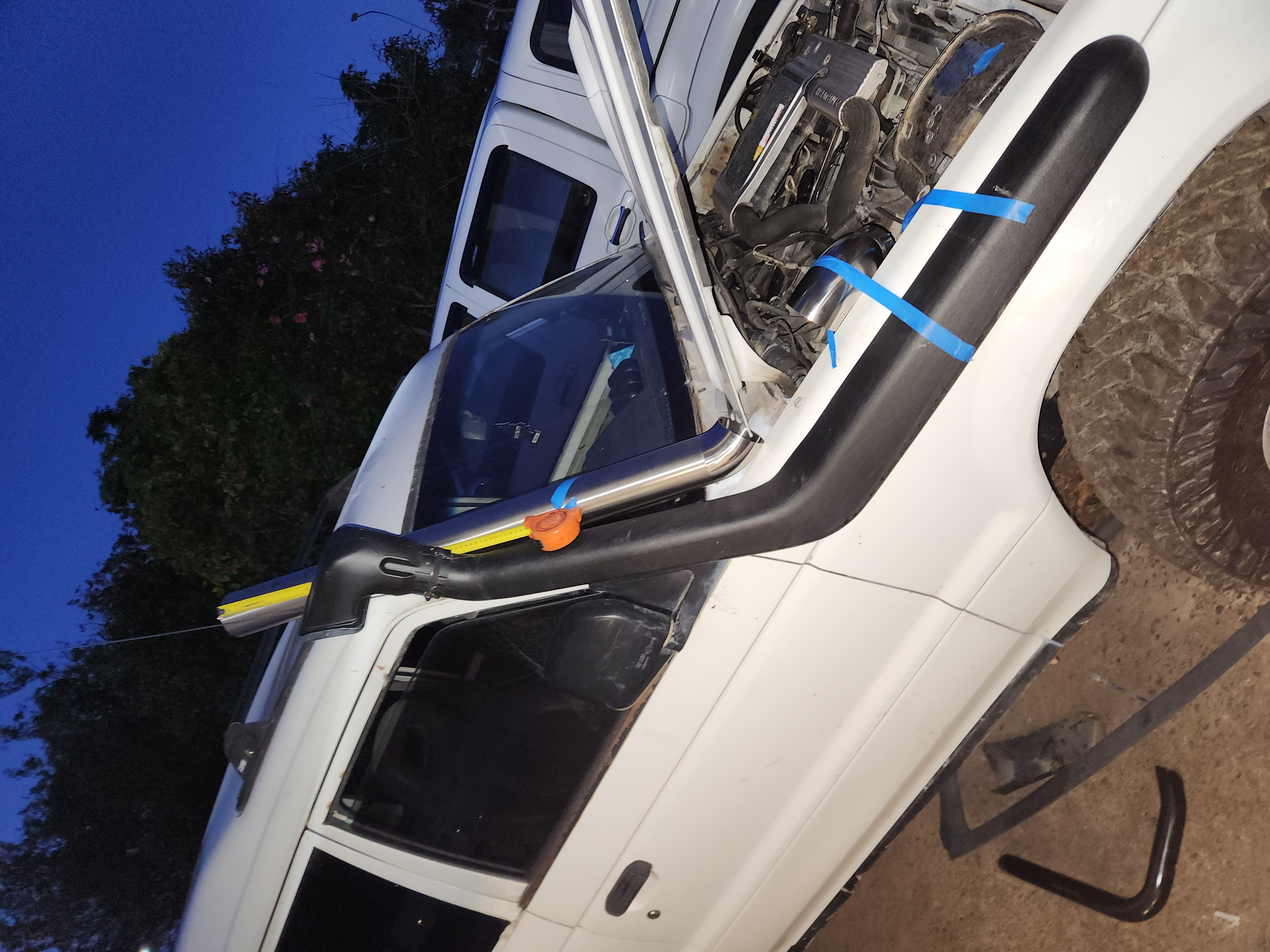

Brought a 3.5 inch snorkle kit off max fabrication and some extra elbows etc
Looks like it should work great comes with a cool honey comb cap for the end to stop leaves etc getting in the air box
Also waiting on my pod filter to show up I've got a foam 60mm one on the way it looks like I can run it within the factory airbox to help it breath a little more than the big oval paper jobby that's full of crud (yes I could replace but I am planning in squeezing every last free (ish) hp from this 90s whale )

Any way the snorkle is all welded up and sanded flush ready for powdercoat so it looks like one piece
