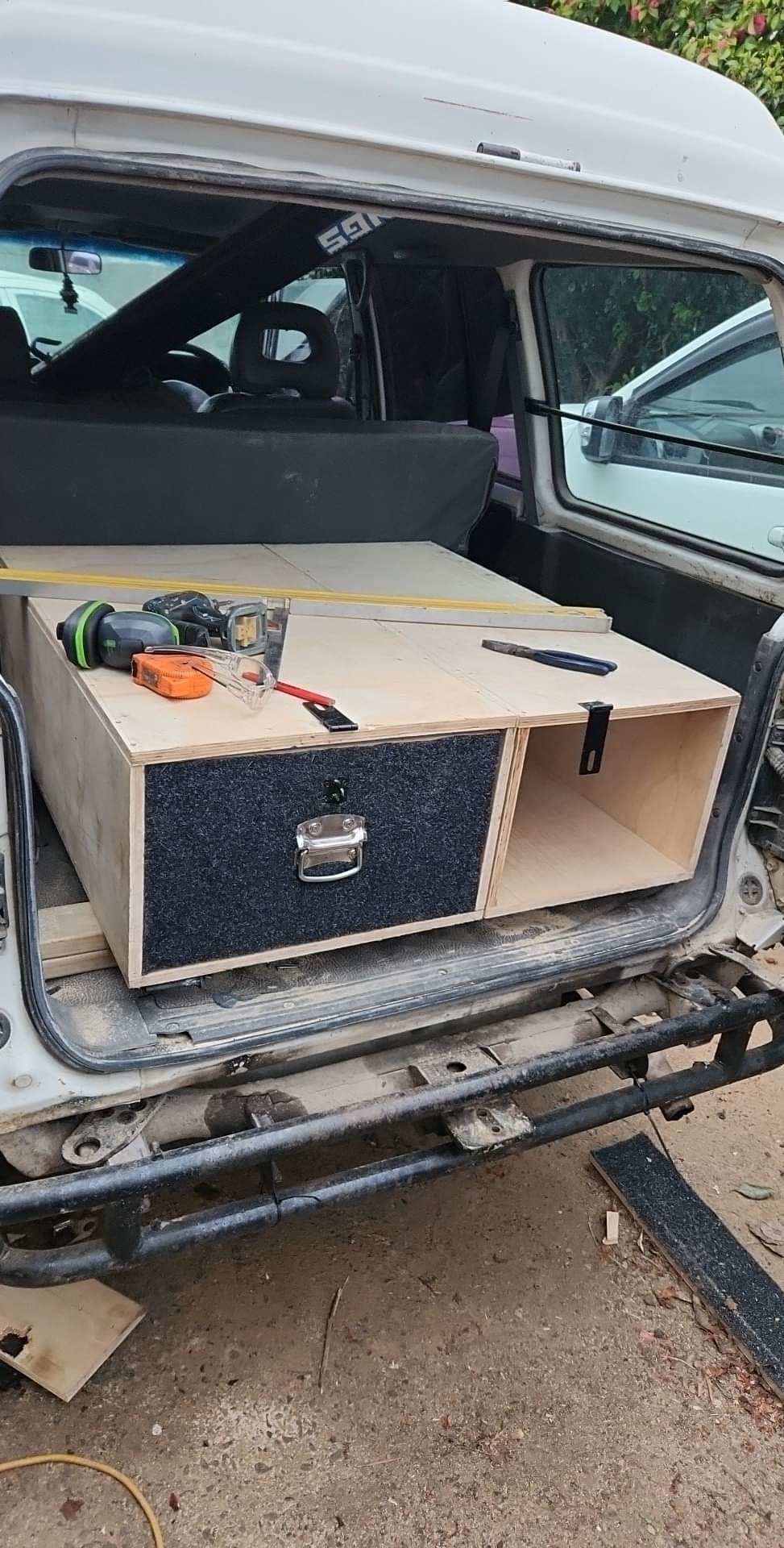

Latest purchase was a cheap set of hole made drawers from marketplace
There were in a safari so roughly 100mm too wide
I had a rough idea what I wanted and how I wanted things layed out but it kind of evolved into a but more and an inverter was added as with a camp battery ..oops
