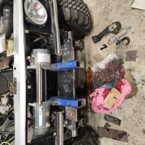

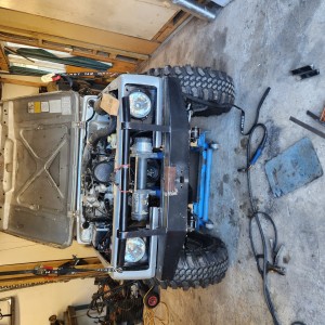

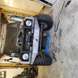

A nice dude came past work and offered me a arb style bull bar from a range rover classic free he just wanted it gone so that followed me home and the saga of that began making it fit the sj
And being the over thinker I am i decided while doing a bar let's mount a winch and hooks ,so I dusted the runva evo off the shelves and use that finding the chassis width of the sj limiting I made a winch plate that steps the winch up 100mm and got it up above the steering box since I'm running rear radiator the front is pretty open
Chopping the bar was fun but would have been easier to start with fresh material rather than making one work and change every aspect of the bat to suit me

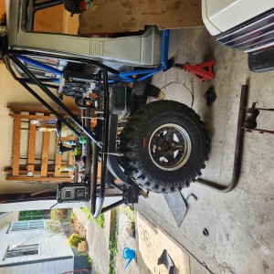

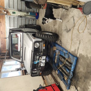

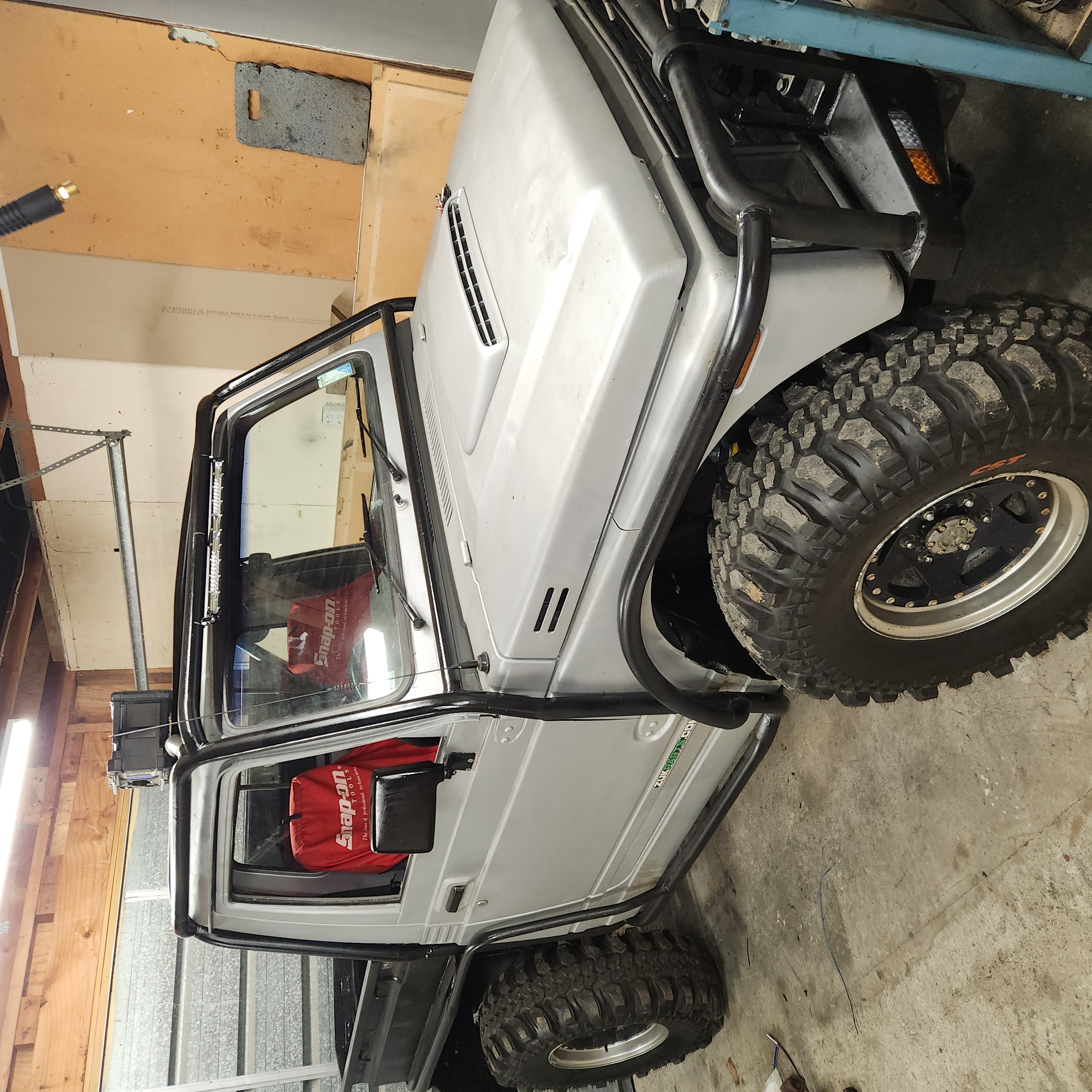

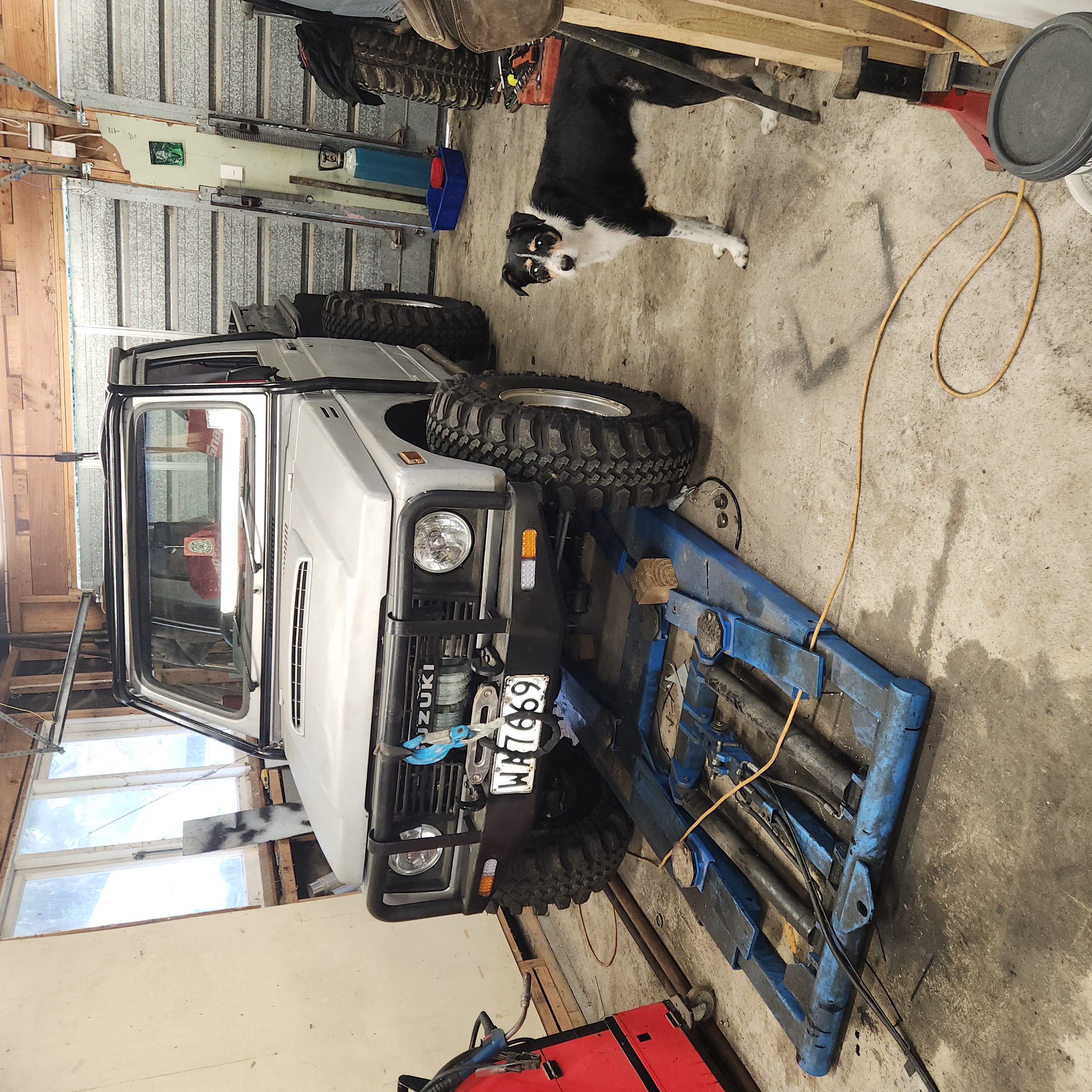

So a lot has happened since the last post !
We are now all legal with a very pretty sticker on my window!
Bull bar finished
Cage built
Sliders
Scrub bars
Serviced
Sound deadner added
We have a trip this weekend with a few good mates to give our wagons a bit of a shake down since most are finally assembled and ready to go
I'm the smallest truck from the line up
3x gq
1x80
1x sas terrano
A vitara
Hopefully nothing falls off or goes pear shaped !
