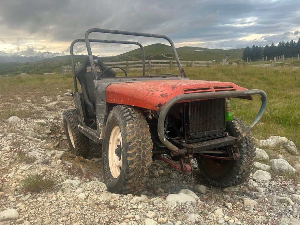

Being able to drive him has motivation high
Maybe a little too high in the silly bugga category . The quary and the pond now have test lines thorough them

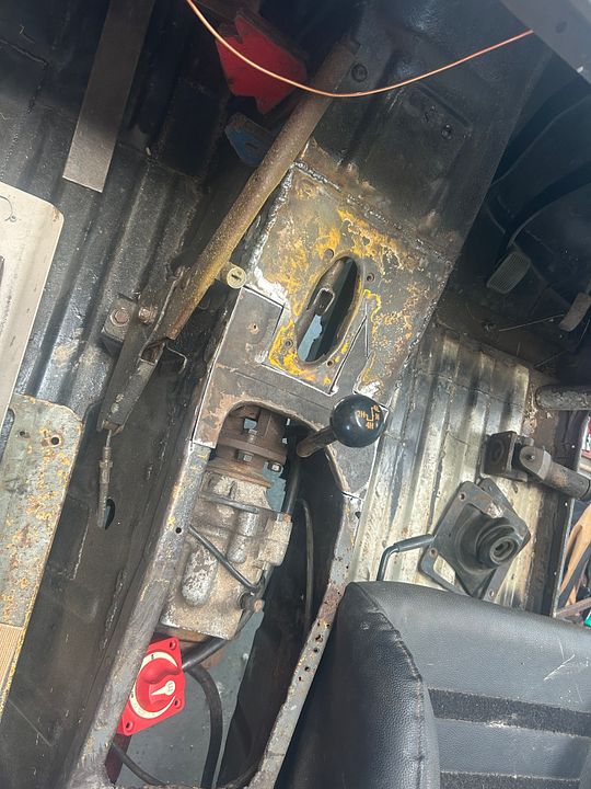

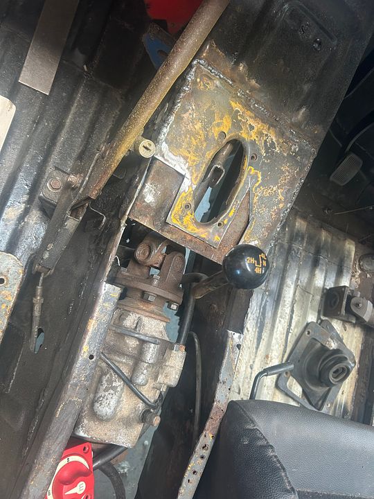

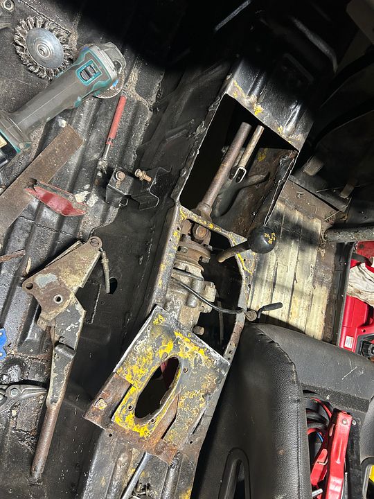

Moving onto to more pressing issues , I gathered enough energy to do one of the main remaining welding jobs .
Transmission tunnel mods are complete. Had to cut and move the tunnel top agian ….. as the shifter was hitting the jack shaft . Also took the time to remove a bit more rot

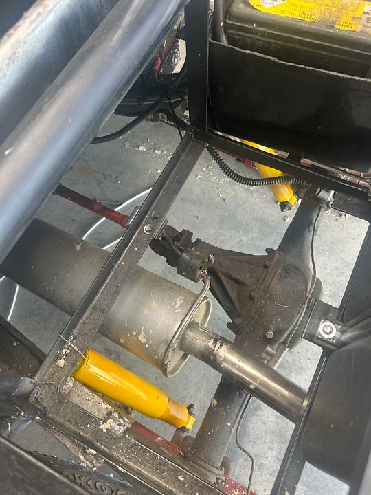

Also some new yellow bling to resolve the bouncy back end

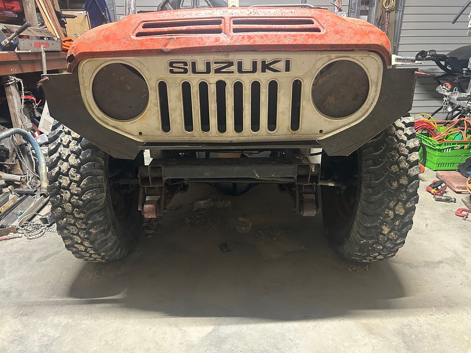

More importantly was to give Rangi his mojo back and after a quick flex up to check front wheel clearances it was time to make a start on the front grill and guards , a project long thought about , but relegated to the nice to have list for far too long
Still a work in progress , but coming together nicely
