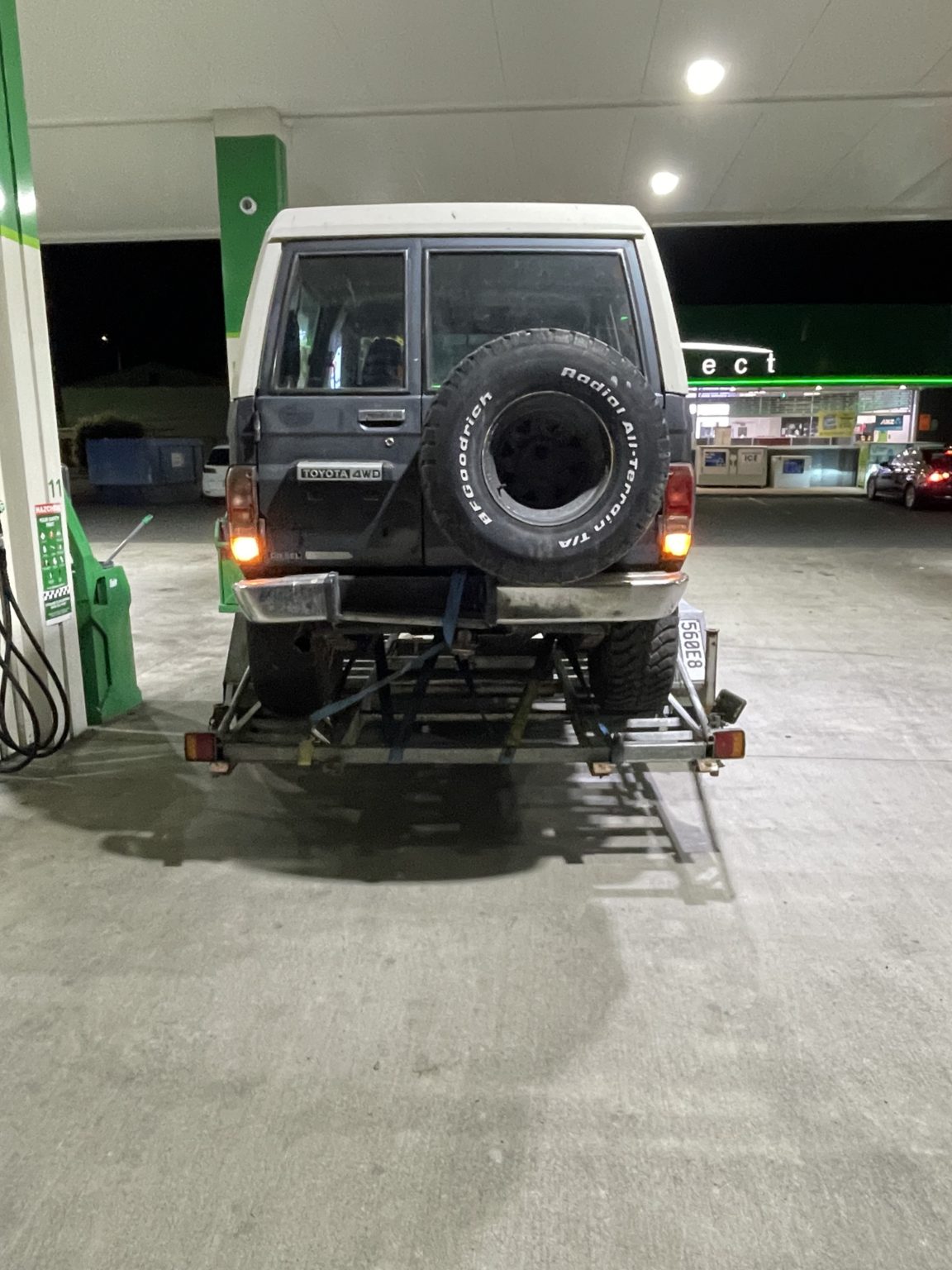

Yes indeedy-do. Picked up a new project today.
Doesn't need much doing to it, just a tidy up. The previous owner is kindly providing all interior parts so I can restore it to it's former glory.
Question is, restore, resto-mod, modify???
