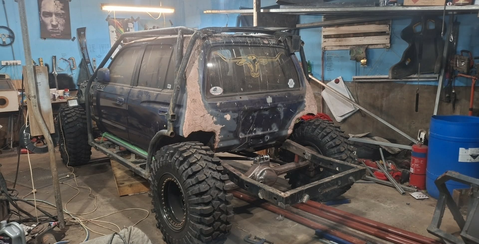

Re: 96 v6 surf
Roughly where it's gonna be sitting, suspension to come. 4 link rear, 3 link & panhard front. Chassis behind cab chopped off and tube chassis to be built. Chassis in front of engine mounts cut and lifted about 5" to allow for suspension up travel.
