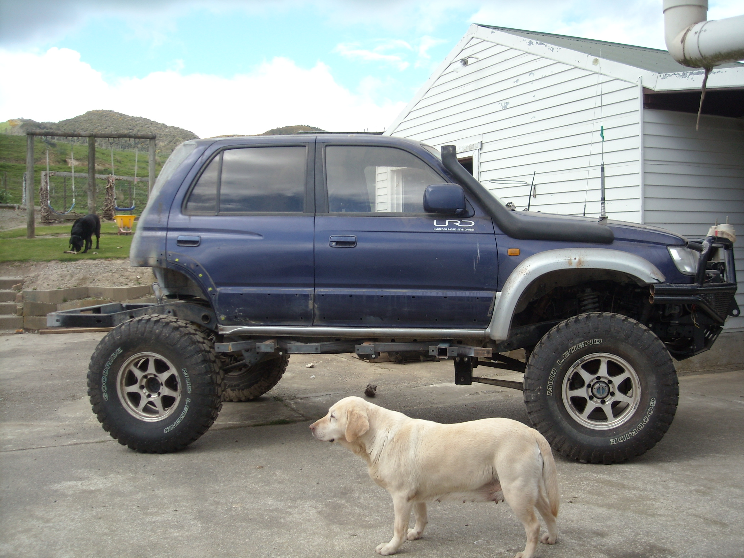

that some serious mud collecting ability there.mudsurfv6 wrote:20171015_140356.jpg
Re: 96 v6 surf
you mean in amongst the bars?Crash bandicoot wrote:that some serious mud collecting ability there

yupmudsurfv6 wrote:you mean in amongst the bars?Crash bandicoot wrote:that some serious mud collecting ability there

will do, but hopefully kept to a minimum with some plastic sheet. still, land is expensive and we'll never be able to afford our own farm so might need to collect some up to take home for free...

With the mud collecting in the bars just clean it out when it builds up on the trail
If not it can build up start pushing your panels in
Another thing is your truck won't feel as agile,seat time will cure this and you'll get used to it.
But the feeling of pivoting your truck on tree and rocks to make turns is pretty cool and putting it on its side with no damage out ways the negatives

will keep an eye on that ta, hopefully will see plenty of mud.
with the solid axle swap and lift and 35s as well its going to feel really weird, but your right, seat time and get used to it.
yeah will hopefully put those cheeky trees off from jumping out in front of me, the panel damaging #$&(%!

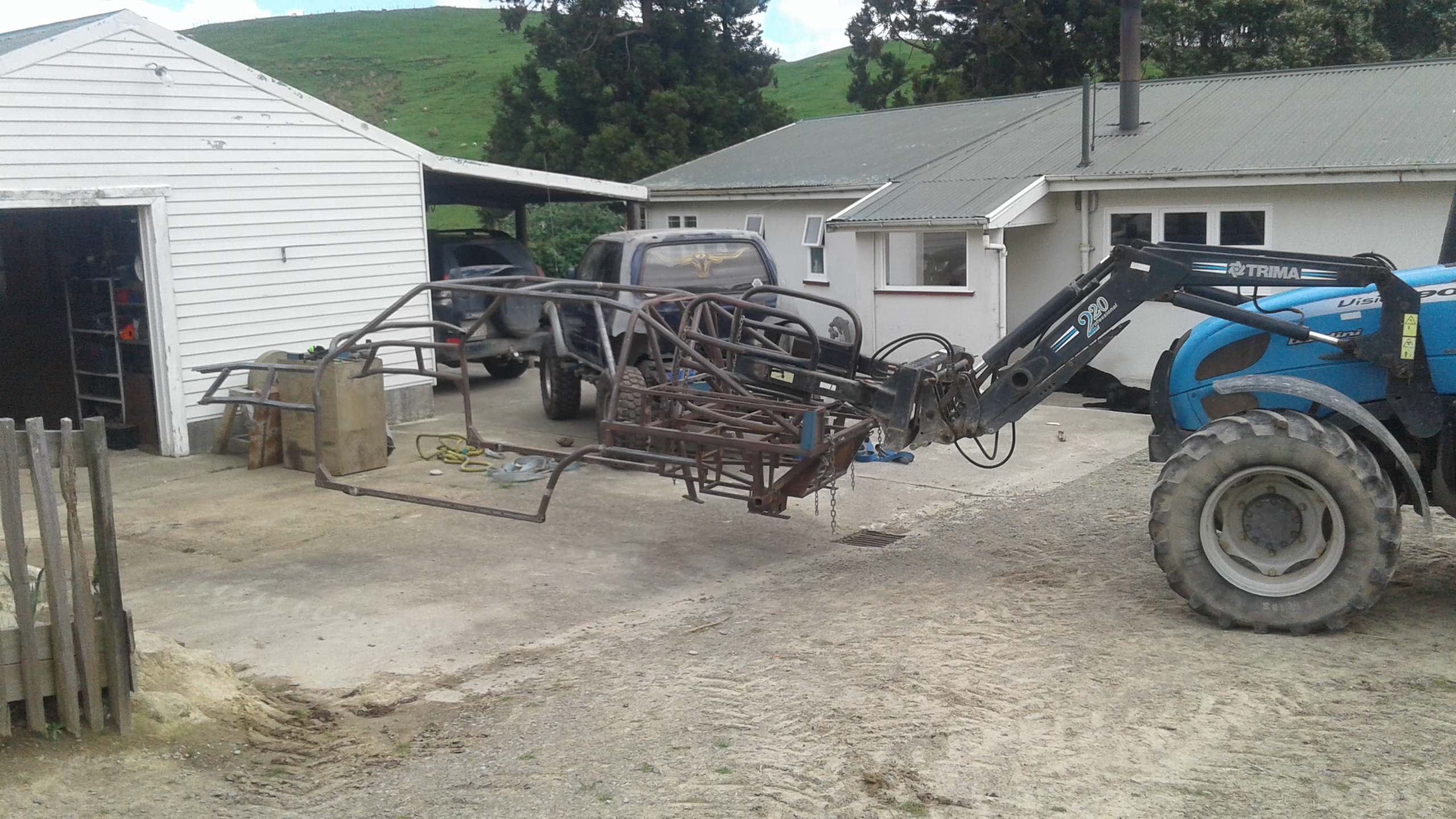

Power switch on Welder melted itself so can't carry on welding exo
So got the rear winch etc in place
Air tank will be filled with 2x 150L/minute pumps, for tyres or rattle gun or whatever.
Small battery starting.
Big battery and one under bonnet on seperate alternator (in time) for winches.
Spare wheel lies above that.

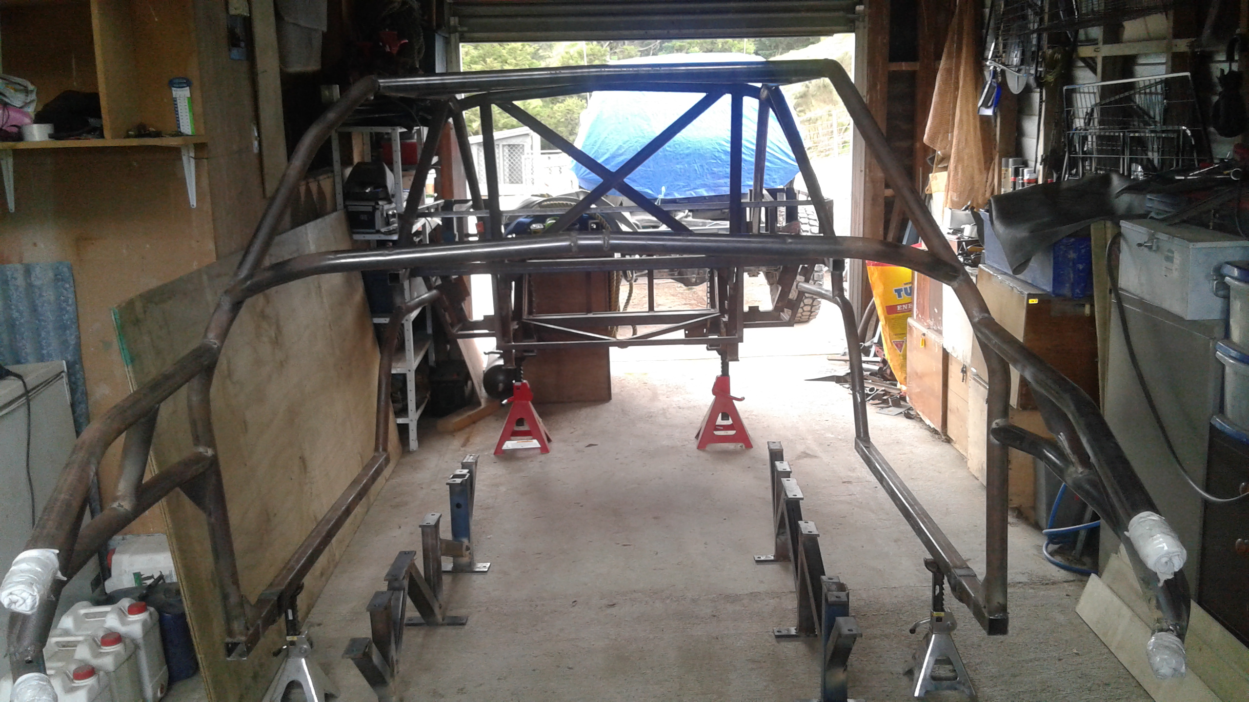

Not sure who's looking here now but anyways....
Long time since much was done on this, is now in the workshop getting the GQ diffs under it with 4 links both ends..
Also gonna have hydro steer and it will now be a trailer truck.
24V alternator in place of ac pump to power the 2x 12v winches and when $ allows a Gigglepin or similar rear mounted.
Cage is getting rear cut up and remodeled.
Rear mounted radiator.
Fiddles x4.
Front bar reshaped and moved back 200+mm so front winch is where radiator was..
Fuel cell going in rear.
Photos to come.
