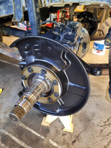

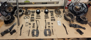

Righto, now for a front end refurb.
There is a fair bit of diff oil that's been leaking and upon draining the diff also a bit of water. Oil level was also low.
Leaking out from the hubs and swivel housing, so looks like a rebuild. If anyone has any seal kits knocking around, let me know.
Will pull it all apart and inspect everything to see what other surprises are in store.
One good thing, is that the underside, chassis and running gear is pretty sound. Only some light surface rust here and there to clean up. Will tackle the entire underside once I'm happy it can drive sagely.

Well bugger me, I have been rather slack. Was hanging out in IH8MUD for a but. But yeah, plenty on the go.....
So what have I done...?
Well I've been wading around in pools of grease and oil. Well it seems like it anyway.
After rebuilding the rear, the front was next on the list.....Nice and shiny That looks a million times better now.... New everything...

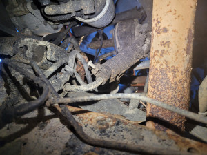

Now for the life of me, I had all sorts of trouble bleeding the rear brakes. I even ending up replacing the LPV.
But you wouldn't guess what the issue was. See if you can spot it in the photo...
A bloody tiny pair of vice grips......Mother F**kers

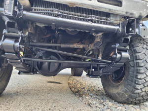

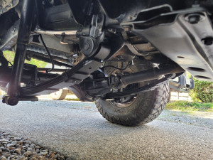

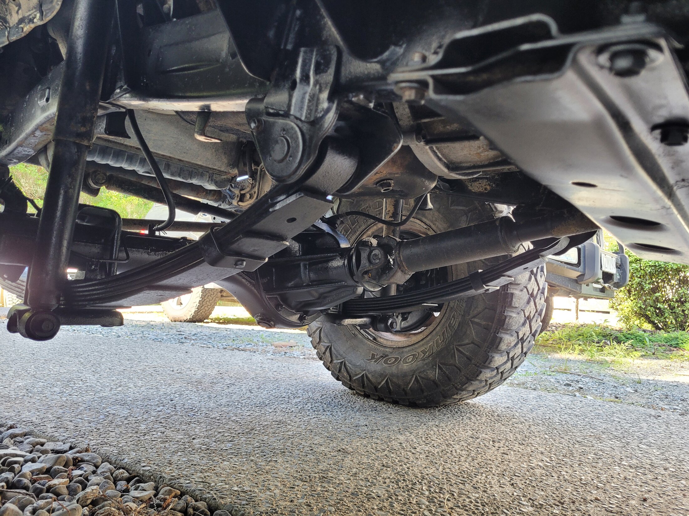

Decided to get carried away underneath and replaced any leaking seals and then cleaned it up a bit...

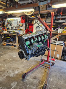

Been too cold to get stuck into the bodywork and do some painting...SO something else popped up that I couldn't resist.
Out with the old donkey and in with the new, fully rebuilt 1HDT.

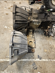

I'll be mating the 1HDT to the H55F gearbox.
I have a 1HZ bellhousing from OZ, and a new 1HDT flywheel and 300mm / 21 spline HD clutch from NZ.
Just need to make the input shaft fit. Possibly will add a spacer plate between the gearbox and bellhousing, or bellhousing and motor. Depending on where the clutch slave cylinder and starter motor align.
The 1HZ bell housing is about 5-10mm shorter.
