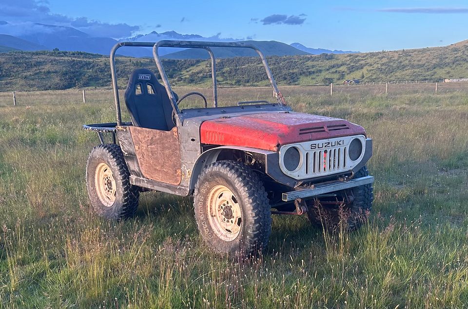

Being able to drive him has motivation high
Maybe a little too high in the silly bugga category . The quary and the pond now have test lines thorough them

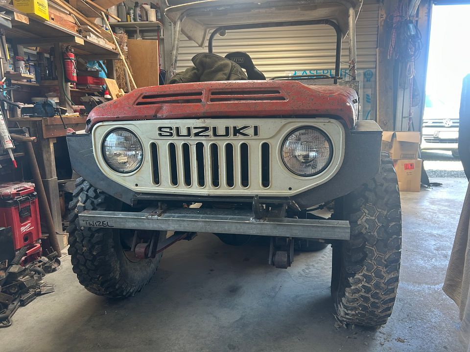

More importantly was to give Rangi his mojo back and after a quick flex up to check front wheel clearances it was time to make a start on the front grill and guards , a project long thought about , but relegated to the nice to have list for far too long
Still a work in progress , but coming together nicely

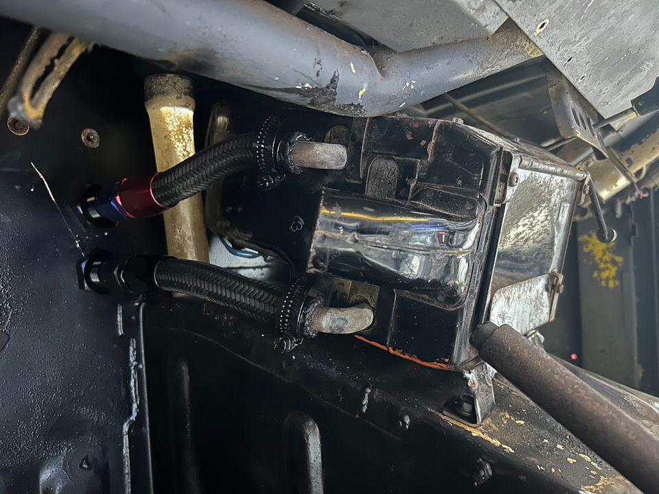

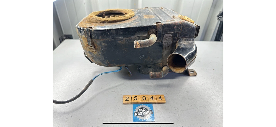

Perusing eBay for parts you don’t need and came across this locally ….. I have never seen a LJ50 heater blower before ,a very rare bird indeed
Dreams of warm feet and fog free windshields ensued .
It got a positive Wife approval stamp , increasing likly hood of Wife trip participation.
Of course after all that , it didn’t fit …
Someone had but butchered the transmission tunnel ….
Some cut and glue fixed that , Add some excessive plumbing from the parts collection and the result was worth the effort .

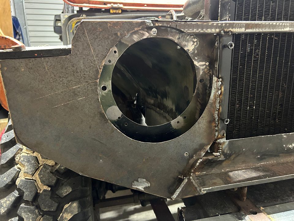

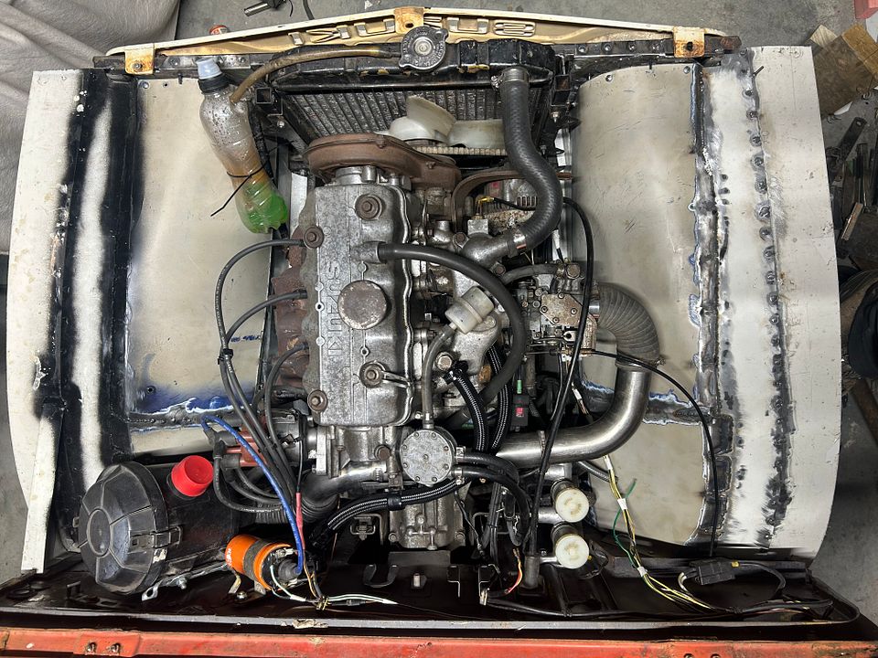

Front and inner guard work has been progressing fast

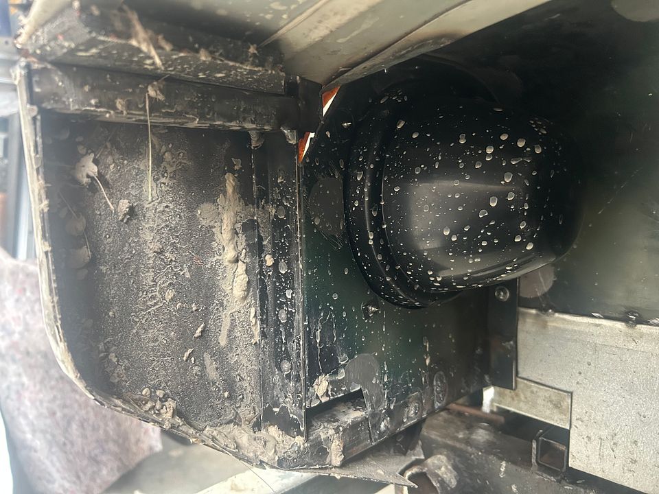

Not a bad result for some old leftover shed flashings and a cut up Nissan Mu bonnet. Some seam sealer, when I get around to it should hide most of the bodge panel work
He Actually looks like and LJ again
Spent way too much time making headlight buckets to fit behind the cool grill . I probably would have done it completely differently if … I did it again , but hind sight after cut this glue that tech is just a nice to have .
Happy with the final outcome , headlights give Rangi his soul back

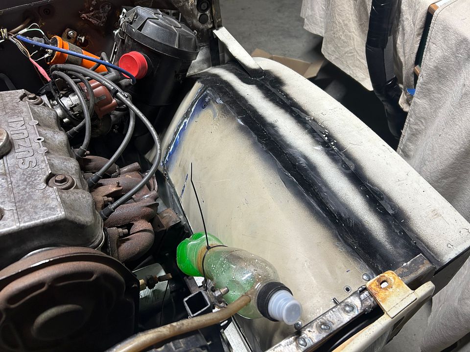

As a result of all that , the airbox got moved again , to its final home hopefully
happy with the engine bay layout , still need to add a washer bottle and upgrade the radiator overflow bottle…
