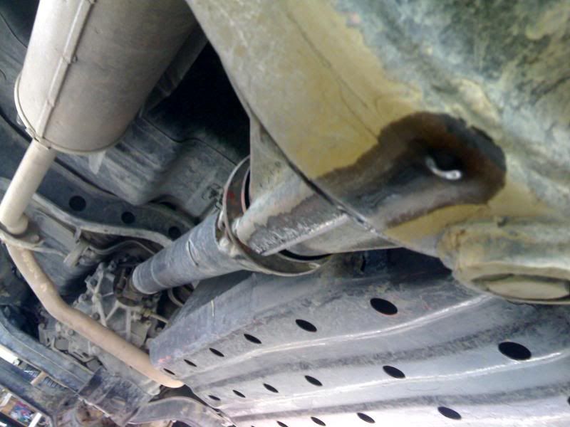

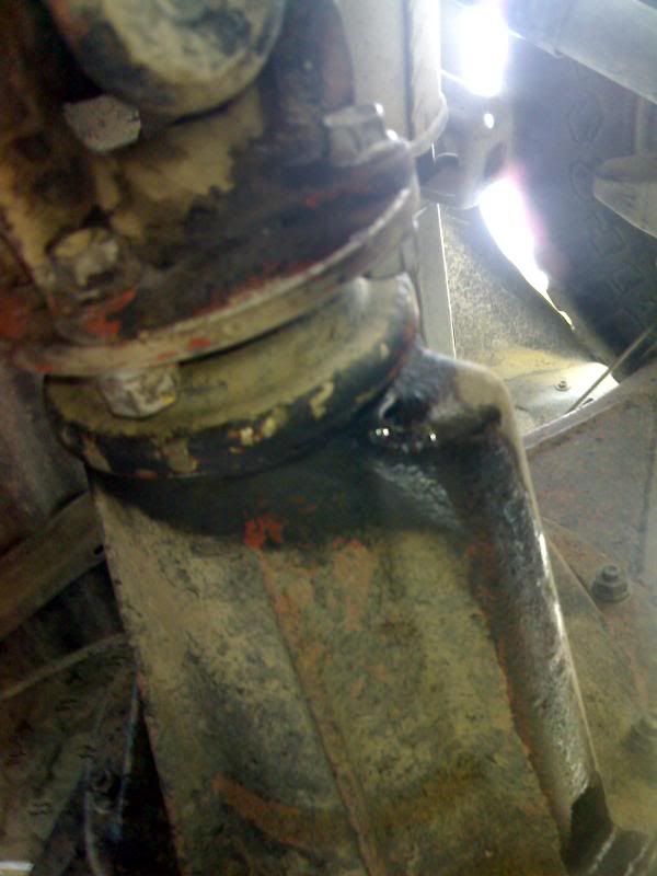

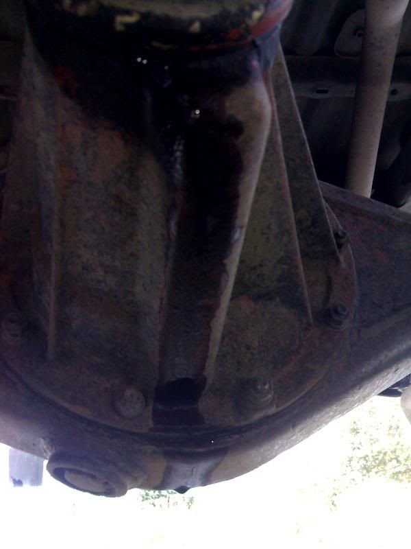

But.........lately I have noticed a bit of an oil leak out of my rear diff. the leak is coming from the front of the diff, where the pinion flange exits the diff head. It's not leaking heaps just a little after a hard drive in the river bed.
Here are some pics to show where the oil leak is:
http://i95.photobucket.com/albums/l140/ ... 7_1244.jpg
http://i95.photobucket.com/albums/l140/ ... 7_1243.jpg
http://i95.photobucket.com/albums/l140/ ... 7_1242.jpg
I checked the diff oils yesterday, the front one still seems fine but the rear one seems to have picked up some water. I could'nt check the level of oil in the rear diff because it seems waaaaay overfilled at the moment, I'm thinking the reason for this is that the oil has "bulked up" because of the water mixed in with it.
My question is: Is it very hard to replace that oil seal at the front of the diff? My understanding is that you unbolt the driveshaft, then undo the castle nut or whatever holding the flange to the pinion shaft and then it should be all pretty easy to replace the oil seal. My concern is that I may be getting in a little over my head, is this the sort of repair that requires special torqueing, tolerances, turns in and out.....etc. etc. etc?

yer it is pretty easy to do i have just done my rear one. just follow the manual, just prize the old seal out with a screwdriver or something like that, clean up around the seal and replace with the new one, try to keep it flat as possible when you drive it home the new seal that is, replace nut and tighten to what it was, first mark where the nut was so it will go back to that spot hopefully, you can do it :D

Technically it should be torqued up again, but just do it up to approx how tight it was before, and yes, taking note of where the nut was sitting is a pretty good indication of where it should be.
Check ya breathers and make sure they arent blocked. Thats the usualy cause of a seal leaking (other than it being worn out or damaged obviously)

Input bearings on diffs dont usually fail. Seals do just wear out. Check for up/down movement, or in/out. You cant tell from any rotaionaly movement.
Ring up toyota, with the chassis number, speak to the workshop technical person, usually the foreman, and ask for the torque. Thats all we ever do at work.
Replace seal, tadaaar! magic! :-D
