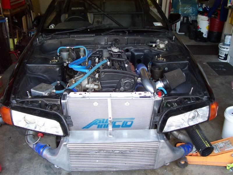

safari_mulisha wrote:see in the middle the loom dissapears behind my head
Dude...your not even in the picture...how can it dissapear behind your head
