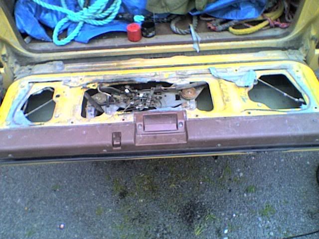

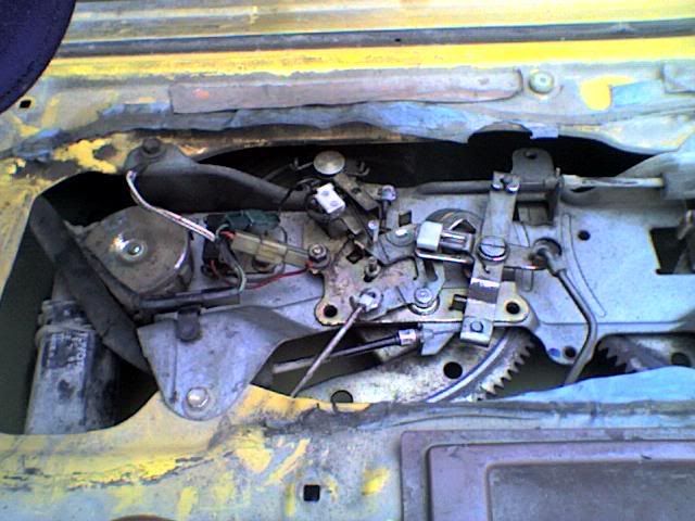

I'm having alot of trouble with the electric rear window in my 84 surf and figured there is enough people on here with surfs that surely someone will have some answers.
Basically my rear window works when it feels like it. When It's not working I try blowing out the mechanism with the air compressor, spraying everything with crc, scraping important looking connections with a screwdriver, banging the tailgate every which way............all to no avail........then when it's good and ready the window works again on it's own.
For a start just the incab switch didn't operate it as it should (it will currently only wind the window down, not up again) But lately it has been not winding up or down with the key in the tailgate aswell, the problem definitely seems to be getting worse.
Any help would be great :D
Here is a couple of pics that may be relevant:
edit: trying to get the pics working

It is basicly the same set as my '91 Surf, there is a bunch of safety switches that will stop it working.
there is on on the left hand edge that stops it working in either direction if it is not closed properly, there is also one in the mount that the wiper sits on that stops the window moving if the wiper is not in its home postion.
I think that there is one more on the mechinisim too but I cant rember
I will have to have a look at my book when I get home.

the old surfs also have one part way down the left had side to make sure that the roof is on (about 40cm from the back). id be guessing that would be your problem. and just repace the switch in the cab if cleaning it doesn't work.
