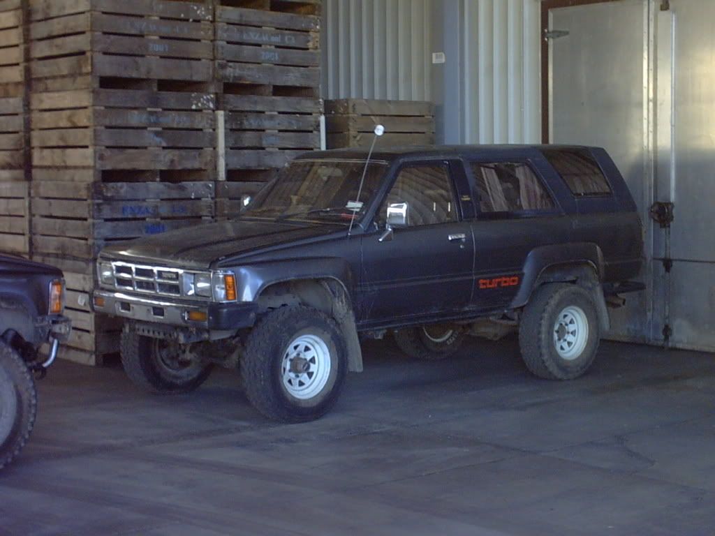

right, as said, a while ago i bought myself an old surf. original reason was that since being in my job i have racked up a few speed camera tickets, cos the camera van likes parking outside work, and i always forget about him. ]:-) so i needed something that didnt accelerate like my car...
looked through the local buy sell, and ended up buying the dearest one advertised, but the only one that had any redeeming features. so many slogged out old surfs around... like new rear springs, re-heat system fully overhauled, recon motor fitted 12 months ago, cd player etc etc
basic specs
'87 surf ssr, 2.4 diesel turbo, 5 speed, sunroof, electrics blah blah.
when i got it it had shiny pajero rims with near new tyres, and came with 3 spare rims, one original hilux chromie, and two white steels, fitted with 80% shagged atr's.
finally got an excuse to take it offroad a few weekends ago when a mate came down from welly in his proceed. so we headed up the maungatapu, had a blast, even though we got stuck a few times, each time due to either shit ground clearance or open diffs. 1st one took us about an hour to get out.
bahahaha
was great fun, and now i think im a little hooked... surf went really well, considering its road biased tyres and total lack of power :D
just gotta fix the puny looking tyres, and find some better rims.

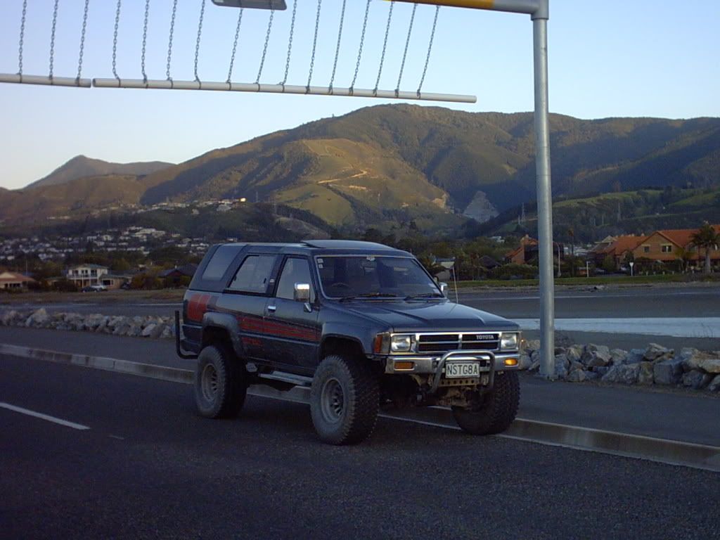

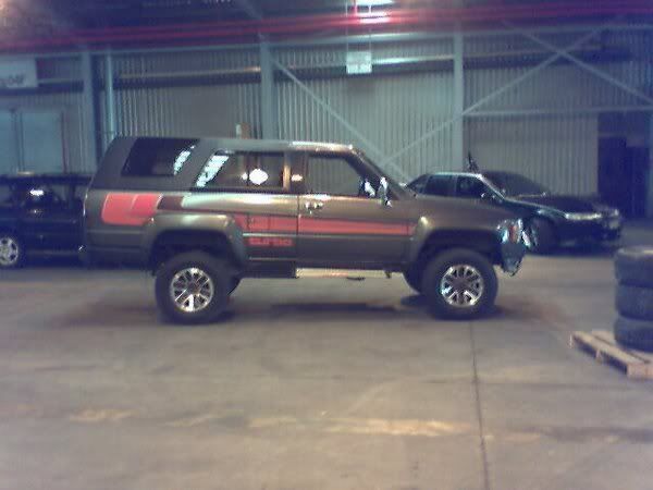

so i hunted round the buy sell and tardme, and then on impulse bought a set of 2nd hand 15x8 alloys fitted with 33x12.5x15... just a little bigger than the old ones :P
definitly looks the part now :wink:
Image but....
had to remove front apron and bumper end caps to give clearance, but that didnt fix behind the wheel...
so i removed the inner guard and smashed back the big vertical seam so i can nearly go lock to lock with no rubbage. until the suspension compress's anyway.
so a mate of mine is milling me up a set of spacers so i can do a 2 inch
body lift, (cheaper and easier than suspension) then i was thinking a 2 inch suspension lift once the bank balance recovers abit...
then snorkel, LSD and/or a locker, cos open diffs suck.

have the tortion bars been wound up in the front? looks abit nose down. If not then that will help stop the rubbing on road and give you abit more clearance at the front.

yeah, they have... il have to have a look to see just how far.
but its the rear springs that make it look nose down, it sits a fair bit higher in the bum than other surfs ive seen.

the lower arms in the first pick with the 33's on look resonably flat id guess you could get abit more out of them. Supralux on wrote a good article in the toyota tech section about doing it. According to him the highest you want to go is 30mm travel difference between the rim and the guard when you jack it up (ie measure from rim to guard, jack up and measure again, difference should be no less than 30mm)

Get a Lokka for the front, it will save you blowing up the front diff, and helps you keep traction when you lift a tyre. I was about to get one for my old IFS Surf just before I killed it.
You can trim the bump stops a bit to get more travel. also a pair of spacers for the front arms to gain a bit more lift too. One of the guys on here was making them. 'Worsel' I think from memory.

Petemcc wrote:the lower arms in the first pick with the 33's on look resonably flat id guess you could get abit more out of them. Supralux on wrote a good article in the toyota tech section about doing it. According to him the highest you want to go is 30mm travel difference between the rim and the guard when you jack it up (ie measure from rim to guard, jack up and measure again, difference should be no less than 30mm)
Pete
hmm, that will be worth checking, im sure when i jacked it up to do the inner guards there was lot more than 30mm travel... fingers crossed i get some more lift that way then, cheers.

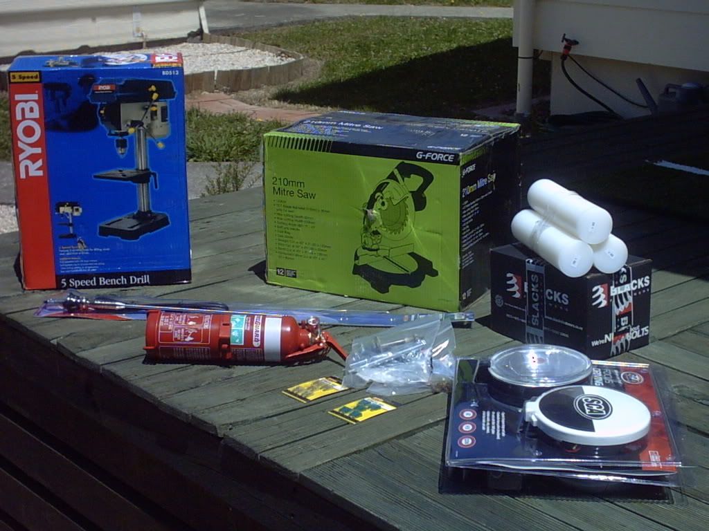

went shopping :) bahaha, told the other half i was just going to get some fuses... should have seen her face when she saw this lot lol
hopefully will have bodylift sorted this weekend now
my two new rear tyres turn up tomorrow fingers crossed, end up getting some cheapo mud tyres, probably made with cheap child or slave labour over in some 3rd world country... but no way was i gonna turn down $200 a tire fitted balanced and my old tyre disposed off...

Might sound like a silly question :oops: but are you going to put a metal cutoff blade in your mitre saw :?

looks like he may use it to cut that white plastic into body lift blocks??? my guess anyway :lol:

yup, and its the blade it came with...
just finished cutting the blocks, drill them tomorrow, stick them in over the weekend :)

were did you get the nylon/plastic from?does it cost much?

got it from blacks, about $25 for a 250mm length, but they had to order it in for me.
