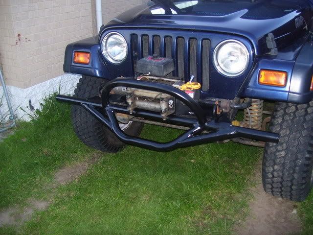

TJ wrote:Looks good, particularly for first effort. Just a couple of design improvements for version 2, bottom loop looks too low and might dig into things; you could make the edges extending from where frame ends bend and run closer and back towards the fender. This will give you better approach angle.
For version 1.0, wonderful effort.

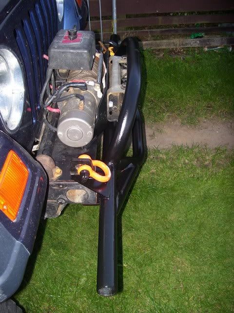

Well, the bottom hoop was meant to be the top one, but i cocked it up, so just flipped it over. Originally the bottom one was meant to be shallower in height and run longer to cover the steering box, hence the extra tube triangulating up the the bar as it is now. Not too worried about catching things with the bottom hoop, its approach angle is still superior to the stock. RE: bending back in toward the fender, im still toying with cutting 150mm of either side yet..... looked at and drew options of tucking it back into the fender, but didnt like the look. also looked at angling a big hoop back hugging the top of the grill line (and then over the guards onto the still to come rock sliders, but that looked ugly..... so went with this, simple and does the main job, which was to cover and protect the winch and fairlead.
