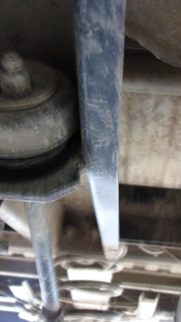

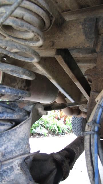

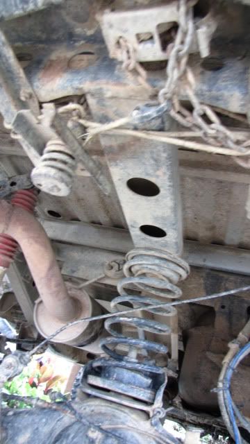

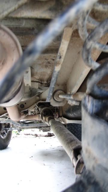

I have been asked to put photos and dimensions of the spring and anti tramp rod on the rear diff.
I have used a Datsun 180b front strut. This is held at the top by a 100x50x3mm box section that is welded to a 50x6 mm plate welded to the bottom of the round tube above the diff and at the rear to the cross member under the tray
To mount the Anti tramp rod I had a piece of flat 3mm folded. This is 80mm across and 70mm deep with strenghtening folds that are 20 mm at the bottom edge.
This is bolted between the flat welded to the round crossmember and the centre bearing cross member.
It is then braced with 12mm rods to both sides behind the gearbox crossmember.
looking back to the round crossmember with the 50x6mm plate.
Cheers Richard

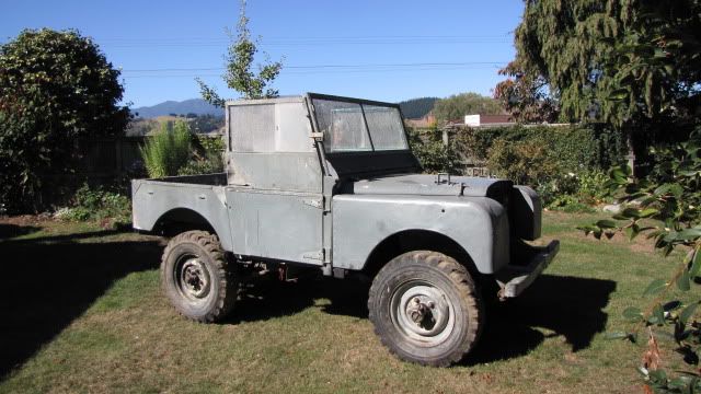

Got my self a Cooler Truck than my common Hilux
A 1940s Landrover tractor complete with original welded tractor draw bar , PTO and Pulley

gary_in_nz
Posts: 636
Location: Hawkes Bay
Post by gary_in_nz »
thats a good score, looks in pretty good nick aswell!
nuts
Posts: 645
Joined: Wed Jul 19, 2006 12:00 pm
Location: somewhere arround westcoast offroading usually
Post by nuts »
your going to need a bigger shed richard :P
shit those old 80" landies are far and few between these days :mrgreen: :mrgreen:
pruggerdore
Posts: 610
Location: hawkes bay
Post by pruggerdore »
I like the winch thingy looks positivly dangerous. was that designed to run farm implements as well? Bit before my time

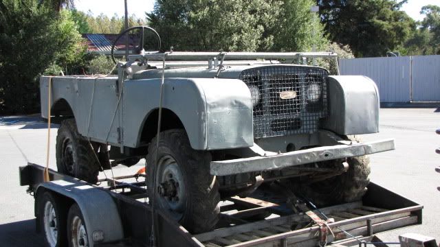

niblik
Posts: 3305
Post by niblik »
i spy, with squinty yoshi eyes, another rover in the background!!
was that photo from the seller / previous owners?
looks to be a good wee number.. makes me wanna bust out vomitron for a comeback.. :mrgreen:
and i think i just may..

Bulletproof
Posts: 1775
Post by Bulletproof »
pruggerdore wrote:I like the winch thingy looks positivly dangerous. was that designed to run farm implements as well? Bit before my time
Murice Wilkes the designer of the Landrover in 1947 was a farmer and he designed it for farm work, anything from cutting firewood to plowing ,making hay etc and that was the reason for the drawbar and PTO etc.
It wasn't until 1950 the Rover company changed the land Rover into a transporter rather than a tractor and dropped the welded towbar.
Those photos are at my place and it is hard to take a photo without another one in the background because I have 4 more. 3 more series 1s and a 2.
The R86s are very different form all the later series 1s from 1950 onwards.
