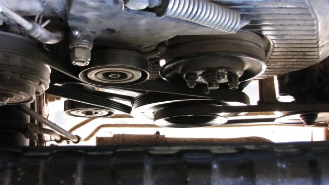

Hopefully I have fix my supercharger pulley that broke at Reefton.
I have modified it by making it one unit now with the power steer pulley with epoxy resin which should make it a lot stronger

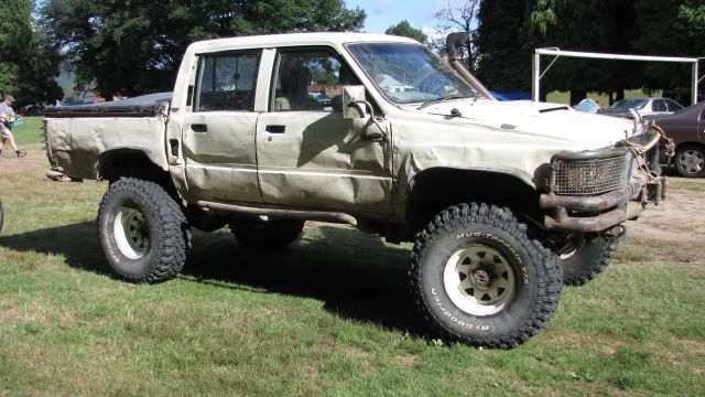

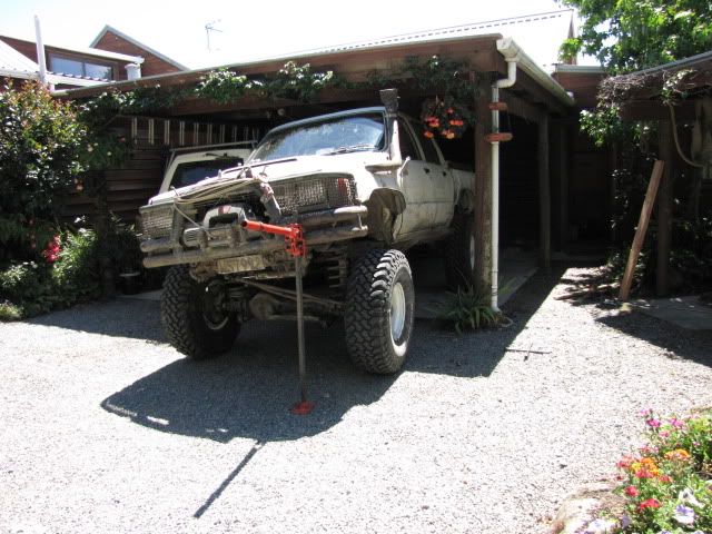

I have just noticed the Hilux thread has gone through 60,000 views without even posting so just to wind up all the haters of it, here is another Photo. 8) 8) 8)
I don't mind being a muppet. If you can't beat them, join them
Cheers Richard :D :D :D

Bulletproof wrote:I have just noticed the Hilux thread has gone through 60,000 views without even posting so just to wind up all the haters of it, here is another Photo. 8) 8) 8)
just a question , is that a 60inch jack???? if so , does it actually lift the wheel off the ground?? if so it must be a little bit.. if not how do you get the wheel off???
Bolo
SP450andLE
Posts: 992
Post by SP450andLE »
Bolo wrote:if not how do you get the wheel off???
I'm guessing he would jack it from a lower point?

Bolo wrote:just a question , is that a 60inch jack???? if so , does it actually lift the wheel off the ground?? if so it must be a little bit.. if not how do you get the wheel off???
Bolo
Hi Bolo
No it is only a 50inch hi-lift. Everything is exactly as you saw it when we were talking at Rallywoods when I was changing the tyres.
Sometimes I use the side bars to lift it if the ground is uneven.
Cheers Richard
Never say die, up man and try
Bolo
Hi Bolo
Cheers Richard
Thats right i thought i had asked you this before ... Sorry mate , its been along time since then .. you should make another trip to the dark side :wink:

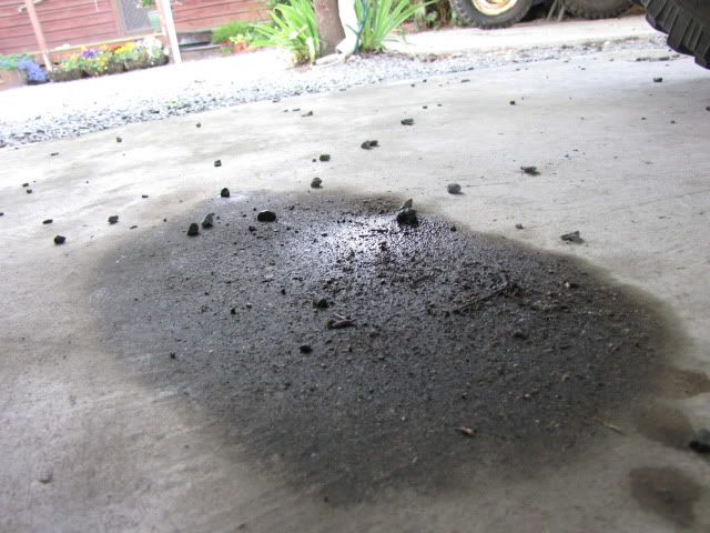

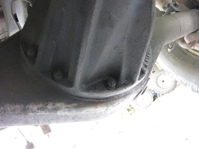

My latest mod is about to happen. The hilux bolts holding the nugget are 8mm and they are too small for tough 4 wheeling so I am going to drill them out and go to 10mm high tensile bolts to hold the housing better.
My PZ70 diff in the front has a miles stronger housing compared to a Hilux
For ages I have had a bent housing that leaks oil
10mm bolts holding everything together will be miles stronger. I have wiped the oil off at the moment so the photo looks clean.

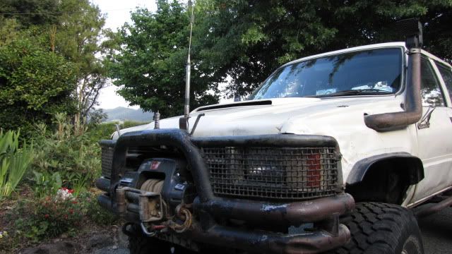

Spent the day getting ready for our Reefton trip
Pulled the winch to pieces and cleaned all the contacts. I then fitted the protection armour for the lights.
Tomorrow I will change onto the Simex tyres and secure the chainsaw
starting to look like a 4 wheel drive again
Cheers Richard

pruggerdore
Posts: 610
Location: hawkes bay
Post by pruggerdore »
pretty staunch light grills there richard. do you find they have much affect on light output. heading for some hid's shortly and some protection like that may be in the plan
Bulletproof
Posts: 1775
Post by Bulletproof »
pruggerdore wrote:pretty staunch light grills there richard. do you find they have much affect on light output. heading for some hid's shortly and some protection like that may be in the plan
Yes they are no good at night but they are only held with 2 8mm bolts so they can be removed in a couple of minutes.
They are made from the high tensile mesh used in gravel crushers and are secured with 10mm dowels so the bolts don't need to be strong.
Before I had them I would break the flasher lights every trip so they have saved me lots of money
