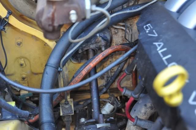

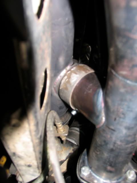

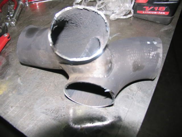

When Adam was off roading last here was disappointed at how hard his steering was to turn. So today, was the first step in making space for a power steering pump.
The old balance tube point was moved further down the system and room was made for a pump on the left side.
This is the old balance pipe work.

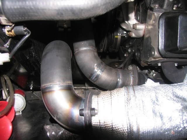

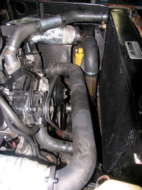

New pipe work made and installed. This is where the old balance point was.
Plenty of room for a power steer pump now.
Corey and Adam hard at work.
The new balance tube position.

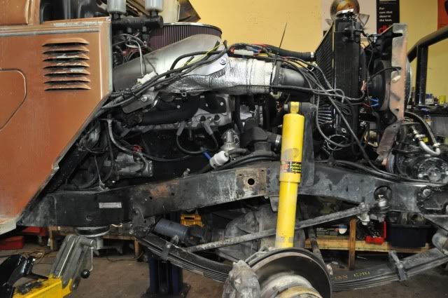

Do those pipes put out much heat? Im guessing theyll be heat wrapped but still being so close to the rad looks odd :lol:

Fakey wrote:Do those pipes put out much heat? Im guessing theyll be heat wrapped but still being so close to the rad looks odd :lol:
You may laugh.
But yep. They are heat wrapped.
He's getting more vents or louvers in the hood as well as more flow into the engine bay.
Heat has been an issue.
He went with those headers as they came with the motor. Originally made for a twin turbo system in a Torana. :D

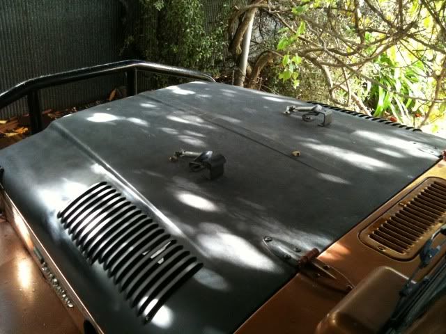

Bro just had his bonnet modified. Still some more mods to be done on the intake of the bonnet to help cooling.

petefj40 wrote:Bro just had his bonnet modified. Still some more mods to be done on the intake of the bonnet to help cooling.
Who punches the vents in the bonnet?
Does it cost much?
Cheers Shane
MNC
Posts: 2100
Re: petefj40's build/mods
Post by MNC »
Does it cost much?
Cheers Shane
Looks like they've been cut out of another bonnet and welded into this one - notice the long vent starts again in the middle
Hope it was an old rusty bonnet you guys cut up Pete...

Shane wrote: Who punches the vents in the bonnet?
Does it cost much?
Cheers Shane
The vents are very easy to punch into steel, most resto panel beaters have got the tooling to punch those vents, but these ones look like they have been cut from another bonnet and welded in?
Thats a beefy brace pete, hopefully you dont break that one :D
Cheers.
It's the same brace, just had some steel plates laser cut then welded to each side of it. It'll be ready to install by tomorrow. 8)
The extra bonnet louvers in Adams 40 are cut from the spare 40 in the back paddock. :D

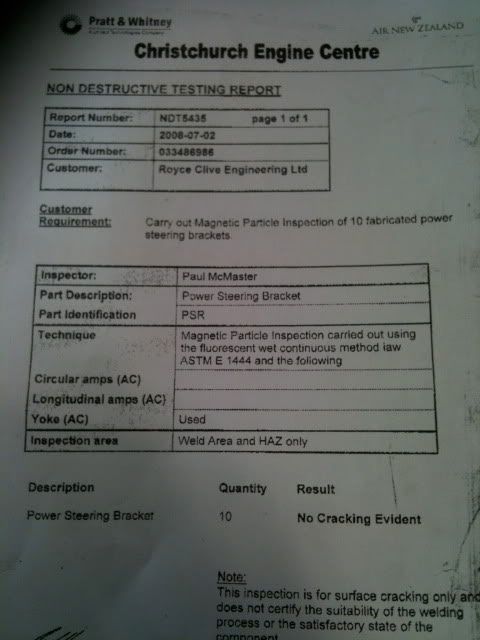

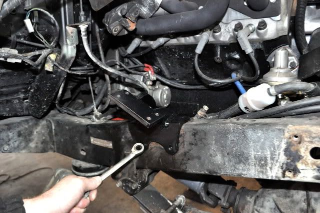

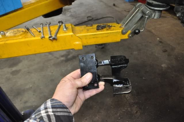

Bros 40 is in at Rick's getting a power steer pump installed.
The original steering box mount was removed to make way for the new power steer bracket brought from Peter Monroe's.
Royce Clive Engineering build them then get them crack tested for cert.
I know that the one installed in mine (brought from the same place) had the same issue as this new one. (Royce Clive and Munroe don't see it as an issue) I thought they may have fixed it. :evil:
If you look carefully you'll see both plates aren't at the same angle. This means that the steering shaft that meets the unit isn't central through the fire wall. Just because the power steer unit isn't straight or parallel with the chassis. The picture below shows this (the way mine first was). I adjusted that plate on the fire wall to it's limit trying to help it not to rub. But it still rubbed :twisted:
In the end, I had the mount re fabricated straight or parallel to the chassis so the steering shaft was central through the fire wall. :roll:

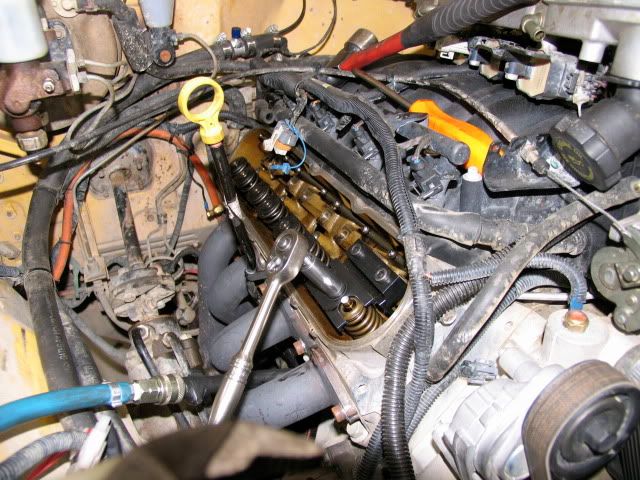

What's the bet he throws a 5 speed in it this year! :lol:
I'm getting a price on new pistons/rings and a Kelford cam this week.
Bout time the LS1 got a freshen up. Bros sounds to cool with that cam in his 350. :roll:
With any luck. That will be going ahead in the next few weeks.

Ive replaced heaps of those brackets that people have brought from them because of the crap fitment, and put in my own ones that i custom make, those just look poorly made also, square edges on the top plate etc.

ClassicCruiserSpares wrote:Ive replaced heaps of those brackets that people have brought from them because of the crap fitment, and put in my own ones that i custom make, those just look poorly made also, square edges on the top plate etc.
Interesting.
Do you sell your brackets with documentation proof, that it's passed a crack test?
Apparently, for the power steering modification. The bracket has to come with documentation that it's passed a crack test. That's the only way it will pass a cert. (according to Wayne martin here in Chch).

whats a crack test going to show? especially on that mount
generally on vehicles your only welding mild steel or 1040. if theyre going to get anal they should be getting the welds checked with distructive and non distructive testing so effectively a 4711 welding test. obviously u cant put the welds on the truck through these tests so you should be a ticketed welder preferrably in all positions.

I'll throw up a pic of the crack test document for the part tomorrow.

Engineer wrote:whats a crack test going to show? especially on that mount
Here's the crack test paper for the part that 'Wayne Martin' NEEDS to gain a cert. Without it. No cert. It's as simple as that. That's the law.
