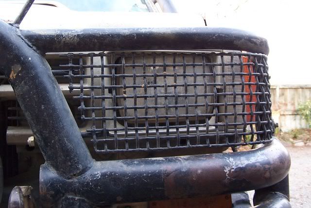

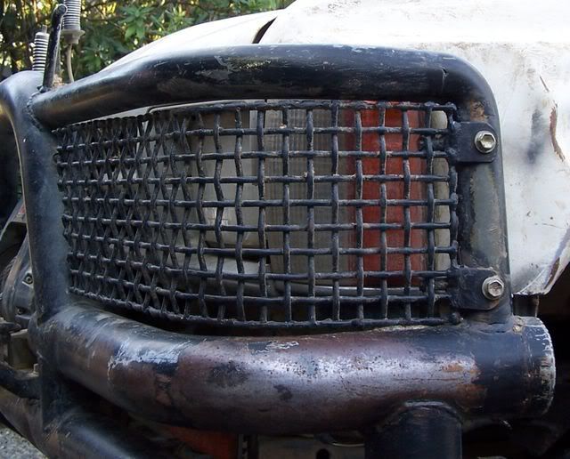

A money saving mod very worth while is protection around the front lights. Over the years I've lost count on the number of side lights I have been through.
To solve the problem I went down to the gravel crusher plant and found some off cuts of their screening mesh which is high tensile.
There are many sizes there. I used 18x18x5 mm which seems to work fine.
I have made them quickly detachable so I can take them off to drive at night because they do restrict the amount of light from the headlights. Because I rarely drive at night I leave them on most of the time. Still road legal for WOF for day time driving with them fitted as the flasher still shows through
To take off I undo the 2 bolts on side
Front veiw
Cheers Richard

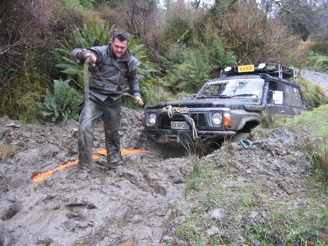

Failed attempt at the big bog holes on the Coppermine Creek Track at Haast. Ended up winching through.
A new track is now cut around them.
No one else attempted them that day. Did alot of damage with the grit in the water.
Stuffed Rear Crankshaft seal , Rear bearing seals , Alternator bearings so cost me about 300 dollars
Cheers Richard
