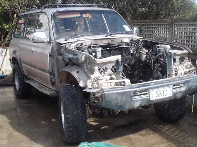

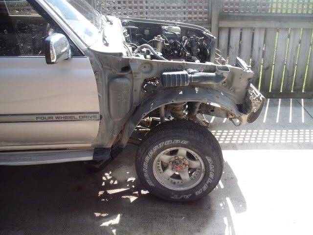

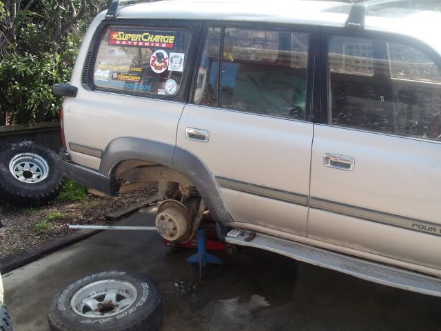

got a wee bit enthused over the weekend and water blasted the engine bay....
which was to highlight the other issue we've encountered......
started to look at the rear handbrake set up that was doing nothing.........
was jealous of curly and his widdle tahs, so I put some of my own on......... coz mine need stripping and cleaning around the beads........
and seeing as how I've done some stupid things lately, I thought I'd do more :roll: :roll:
oops, the grinder slipped :shock: :lol: :lol:

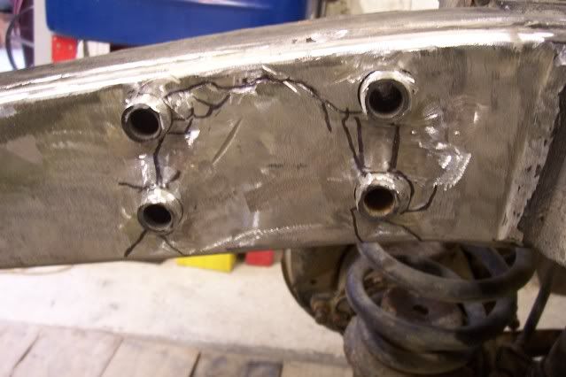

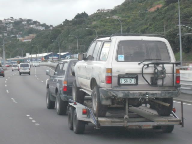

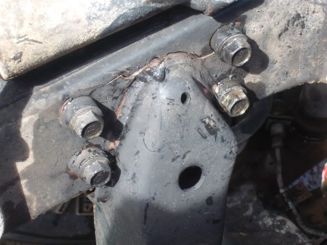

righto, firstly the motor went missing out of the cruiser, now the whole bloody cruiser has gone missing...............
and for all you 80 owners, go outside right now and have a bloody good look at the chassis around your steering box
all of the felt pen marks are the cracks :shock: :shock: :shock:

Re: WANTED URGENT: 80 series snorkle for Skid
Been sold for parts eh? :mrgreen: :mrgreen:
At least it wasn't towed by a Nissan this time Skiddy :D
Jerry wrote:At least it wasn't towed by a Nissan this time Skiddy :D
definitely not

Those cracks are flipping scary. Think its been abused or just a freak occurance?
sig
Jeep Jeep
Posts: 1488
Location: stokes vegas
Post by sig »
cracks are normal for 80s around the ps box
as skid and sig have mentioned this is common, mine has done the same ( good thing we pulled my motor out too!! ) and even my boss's work 80 has cracks as well...
IF YOU OWN A 80 GO CHECK IT!!!!!!
