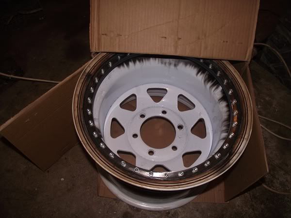

pulled the flatdeck out of the shed to do a bit of shit on it :D
Pulled half the shed apart and dug out some old PTOs and found a bunch of old toyo and nissan winches and an old 8274
had to have a play around mounting the pto lever and lift it up for the 50mm bodly lift and shift it back about 40mm coz some clown :oops: cut the hole in the tunnel when the gearbox was hanging down without an engine hanging off the front and it ended up getting cut in the wrong place :x so I made a little bracket up to get the lever sitting in the hole properly :D had to extend the linkage rod about 30mm then gave it a try out and it all engages both directions ok. I stuck a forward/reverse PTO on and will see if I can run a toyo winch in reverse so I dont have to chop the ARB bar up to shift the rope slot up to the top (Cruiser winches spool off the top of the drum unlike most other winches that spool off the bottom :roll: ) otherwise I'll stick one of the Nissan winches on it.
Dug out some 10" cragars I had beadlocked a couple of years ago and cleaned all the welds up ready for painting, my 8" beadlocks seem to be out on long term loan so I'll get the 10's painted up and stuck on the truck so Sig can get his 10" Alloys :D
