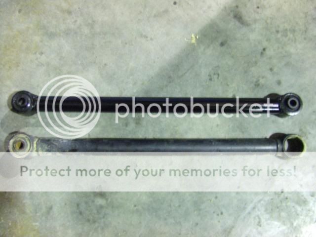

Time for an update, took it to the cert man so he could have a look an give me his oppinion an see weather he could do the chassis an suspension mods (He cant but will be getting Julian from carterton to look at it too)
Anyway the only things he said were that I need to fit wheel flares, replace some suspension bushes (knew bout those but hadnt had time) an he didnt like the way it torque steered under accelleration an decelleration. Main reason for this being the short poorly designed panhard rod :oops: :lol: I had already been thinking bout how I could redo it anyway so wasnt too fazed bout it.
Anyway heres the pics: 80 series lower arm bushes dont like working on an angle in a 4 link
Had good bushes in 80series upper arms so used them to make new arms
New panhard rod compared to old modded 80 series one
Reused the 80 series bushes an spigoted them into a piece on volvo truck tierod :lol:
Start of new chassis mount
New diff mount
Chassis mount finished with chassis cross brace
Handles way better funnily enough :D
