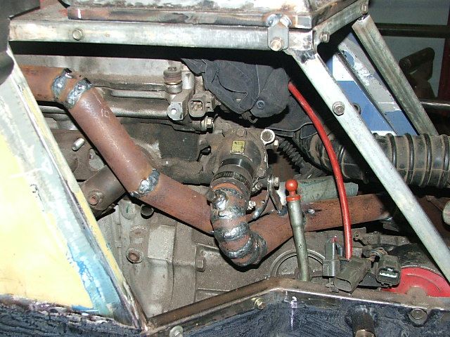

Still working on blastard water lines lol

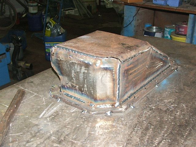

Just got one small section under the tunnel to sort and they are done... while waiting for welds to cool I started the sump
Decided to kind of over kill it since there is no bash plate to protect it I'm making it strong
4mm for the front section and the bottom, including the folded edges the sides will be normal sheet
Still got to do the other side as it has a bit of contour and then a recess to fit a rachet when doing up the touque converter bolts, and some windage baffles

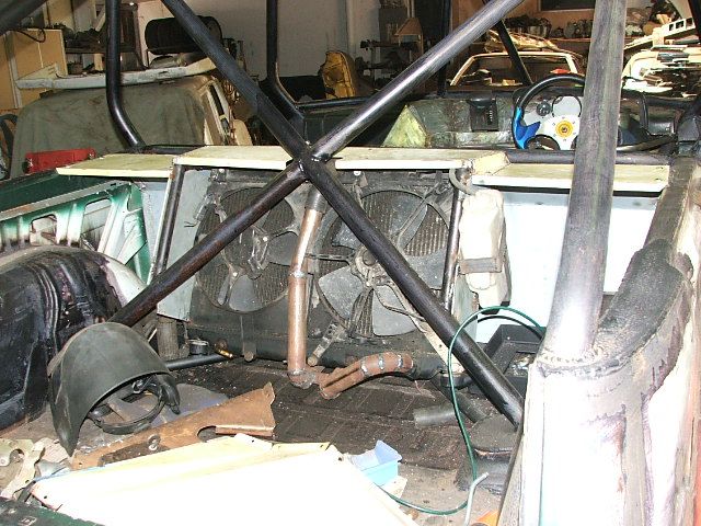

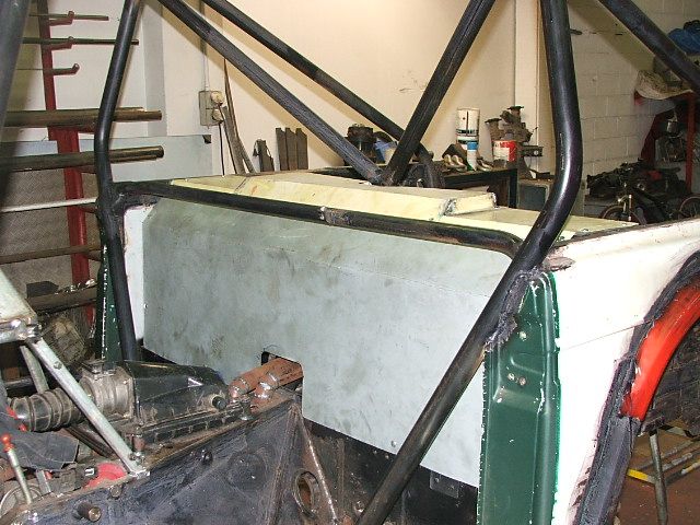

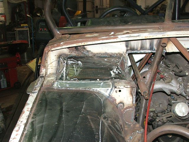

Got the bulkhead between the radiator and the occupants in
That will keep the club scrutineers happy with the rear rad

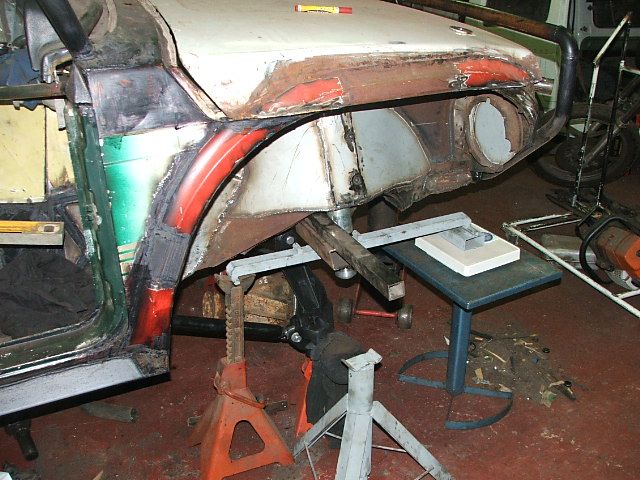

Right got the front end weigh'd in, just a bar that is calibrated to change the leverage ratio and a set of bathroom scales I have true'd using 20L drums of water
everything that is going to be there is sitting there and I've thrown in some sections of pipe I can use to make the bracing
the real interesting surprise is how much weight the winch and bar have added to the springs.... they have near on doubled the weight from what I was working towards as a trials truck!
Don't have a phone Rick so either call in or round home

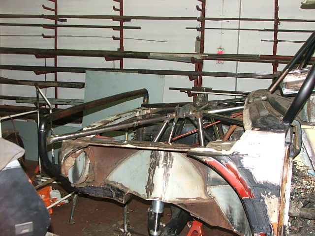

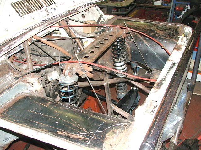

Right since since I have a working range for the spring rate time to sort out placement.... since I've modified things from the original CAD plan I decided to go old school and just spot weld a frame in and cycle and adjust.... so some 6mm rod and we have it all done
impressive how strong a bit of 6mm can be.... let it down onto this dropped the bonnet down for safety.... then climbed onto the front bumper and started bouncing lol with the shocks on the soft setting I got enough bounce it lifted the axle off the jack stands yeeehaaaa lol
I wasn't just doing that for fun but when your half piss'd on a fri night it is rather amusing lolI did it to settle the springs and shocks so I could take a measure for height adjustment
Then its time to cycle for clearance issues and set the final positions
Then yesterday using the wire frame as a jig to position I built the new shock towers
this afternoon after some miss's time I'll see about joining these to the top of the bumper

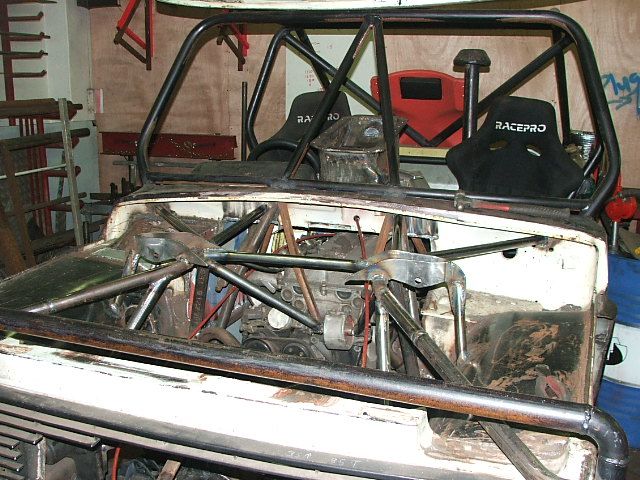

Here's the weekends work, bit of fun....
a mix of pipe and tube, to keep the weight down, but still have the strength where I want it.... didn't have enough tube to finish off the shock tower brace... was hoping to get it all nailed but it'll have to wait
