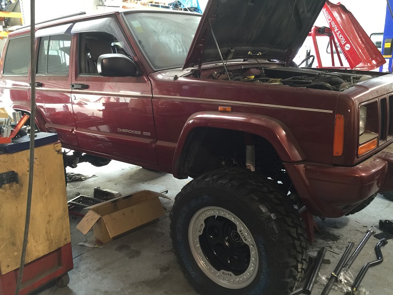

Here's some more recent shots. Chromoly axles in, diff rebuilt, re-geared, and locker in just cable not plumbed in yet.

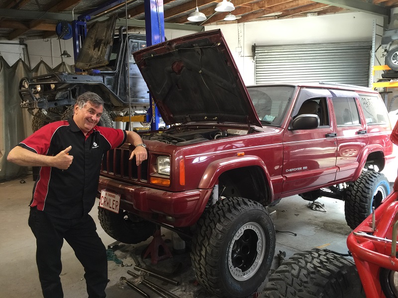

Here's some even more recent photos. Definitely put a smile on my face. Nearly entered the realm of the Jeeps.

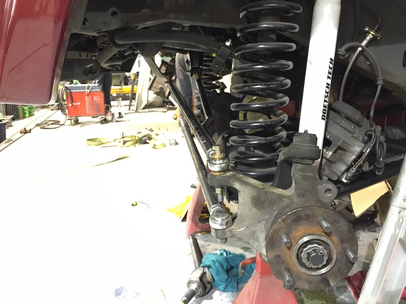

FYI - Iron Rock Offroad RHD track bar, over the knuckle steering etc.. no good on this project. The guys have done a great job setting up new brackets, angles and mounts for steering and trackbar using the WJ knuckle and brake conversion.
I have to say I'm fizzing!
One would hope this lasts. Looking good.
I think Stu approves

Hey didn't end up using any of it in the end, just bought some hollow bars and had Rick set up the front. Tie rod, drag link and track bar all 100% straight with no bends. (The IRO one wasn't going to work with my WJ d&c conversion)

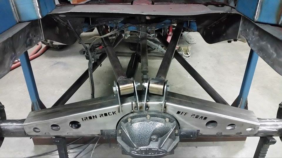

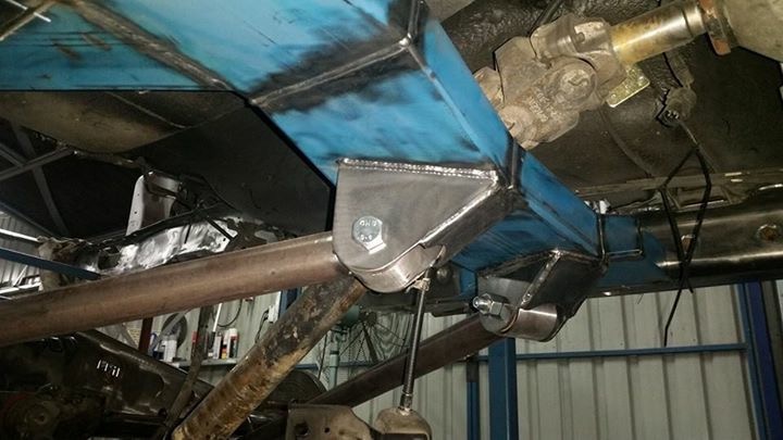

And well it's time to turn XJ Crawler in to a proper rock crawler, and a street legal one! Thanks to Tom from Toms Offroad and Customs he has made this possible and dream come true. Work in progress, enjoy the photos. More to come as it progresses.
Looking forward to hitting some rocks!!
New build:
14" Amada Extreme Coilovers all round
3" Amada Hydro Bumpstops
Custom Dual Triangulated 4 Link Rear with custom crossmember
Frame stiffeners front to mid
Rear frame section replaced with 150x50x3 rhs
Custom tube & sheet metal flares
Full exo cage
Raised fuel tank

Got to get pre-approval for the 4 link rear from LVVTA then through Don Hoff as per usual Rok ;)
