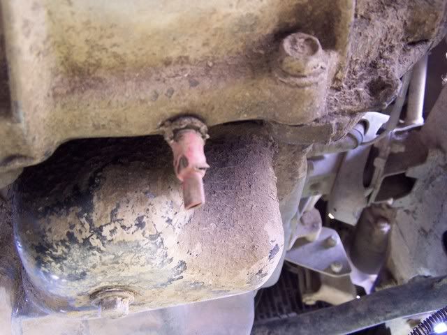

I haven't had to seal around the fork area on the hilux because the rubber is a good fit. My problem was the breather at the bottom of the bell housing.
After going through 3 rear crankshaft seals with gritty water being forced up behind the flywheel, I thought something has to be done and copied the same principle as on the bottom of starter motors.
I drilled out the breather hole to make it round and then tapped a bsp thread to take a pipe fitting that has a hose fitting on the bottom end. I then fitted some heat shrink over it and squeezed the bottom end together to make it flat.
This stops the water going up but doesn't stop it draining
I have been involved in a couple of rescues between 3-4 ft deep and sat there for 5 mins and then driven out without any problems
here is a photo
Hope this helps Fitzy
cheers Richard

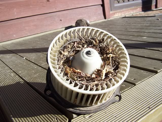

I am having trouble with the fan on the heater and demister.
Has anyone any ideas how to fix it. I will paste a picture.
Richard
Richard
Never say die, up man and try
You could try using a colander to spin dry your twigs etc for starting fires
Same problem Richard. Only happens on the westcoast though
Just one of the small shitty things we have to put up with every now and then.
Al
Al
Just need to find out where your intake for the heater is and chuck some mesh over it. Wont stop the water but will stop the rest of the crap, stops the hamster getting in there in the first place. no hamster=no rubbish

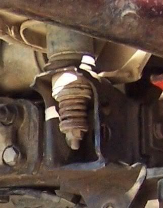

A thread is talking about lift blocks. I bought a length of 50mm nylon that all the truckies use on their rigs.
Mine are 35mm high on the body and 75 on the deck as I cant see the point in going any higher than is needed as the centre of gravity goes up.
To give more flex to the body and to stop it cracking , I have fitted valve springs at the bottom and used high tensile bolts with nylock Nuts.
Cheers Bulletproof

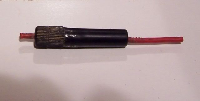

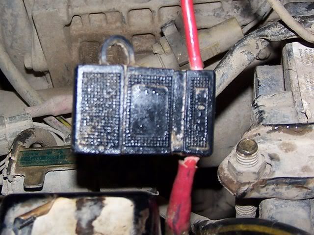

For anyone running ARB lockers one of the most important mods to make is to replace the fuse that comes with the lockers.
It looks like this, and is absolutely useless as moisture and shit gets in and the connections go rusty. The compressor needs 30amps and if the connection is no good the compressor struggles and goes real slow.
I have replaced mine with one of these
They are a completely sealed unit and for added protection I have put petoleum jelly around the seal as well .It has been like this for many years now and the compressor still pumps up in about 10 secs.
Cheers Richard

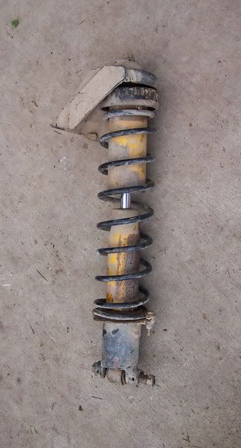

Do you have a picture of the old spring setup, the coil over set up you made, I would like to see how you did it?
Hilux DC stock as a rock,leaks everywhere
- Bulletproof
- Posts: 1775
- Location: Nelson
lockie wrote:Do you have a picture of the old spring setup, the coil over set up you made, I would like to see how you did it?
Here is a picture of the coil over the OME front shock . It is made from the rear strut from a Daihatsu charade.
Do you live north of Christchurch ? The reason I am asking is im going to Ikamatua next weekend and I will be with a number of CHCH trucks . Someone would be willing to transport them.I know Paul Delis is at Kaiapoi and that wouldnt be far from you if you where I think you are.
You can have them if you want to play. Let me Know before thursday
Cheers Richard
Thanks for the picture. Yes I'll have them to play with. I Live at Waikuku just 15km north of Kaiapoi so if you could get them to Paul ( I haven't met him) and put me in touch with him that would be great.
