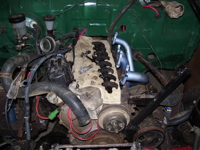

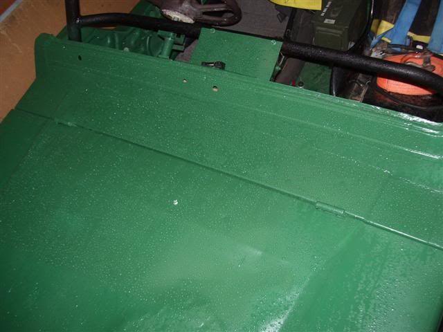

well took the head to get planed today and he said not to take any more off the head other than just skimming it. but at least its not guna cost the earth to get it skimmed. also took some pics, not much to see but there is something there.
painted and installed back.
pic of head off, lots of room in the engine bay now:)

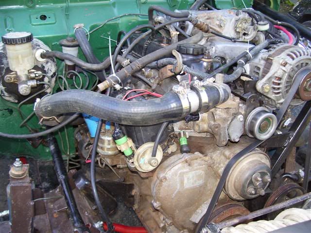

well at last it goes, had a little problem with air locks to start with so put a bleeder on top of the motor.
then found out the thermostat wasnt letting enough water into the motor so out that comes. now works great no overheating in fact it gets too cold if i put both fans on.
im still not sure about the ride height but it will do for now see how it handles dans fun rally trials (i can see some panel beating coming up) but here is a few pics of what it looks like up against my stock zuke.

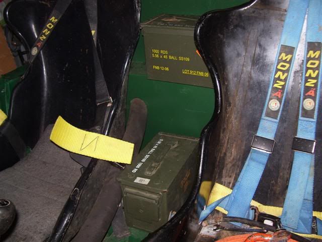

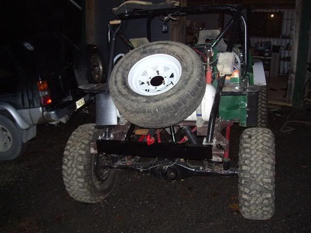

i put the other seat in and put the belts in, also mounted my spade:) cant go on a trip without one hehehe. sometimes it can be your most usefull recovery tool.

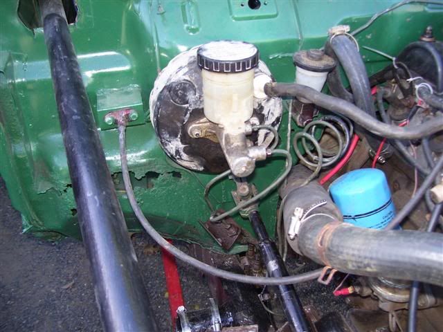

also had to replace booster and master cylinder so here is them in place, had a prick of a job getting it to fit as you might have guessed sammy ones are differant to 413 ones so 413 body + sammy booster = trouble.

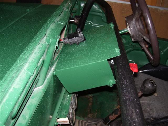

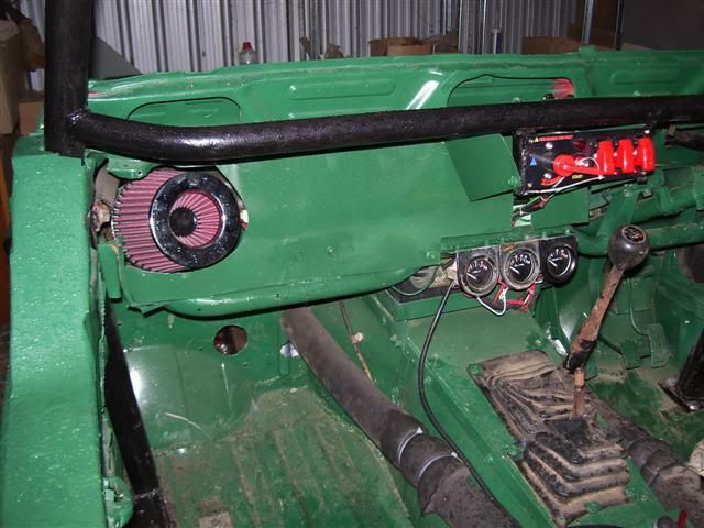

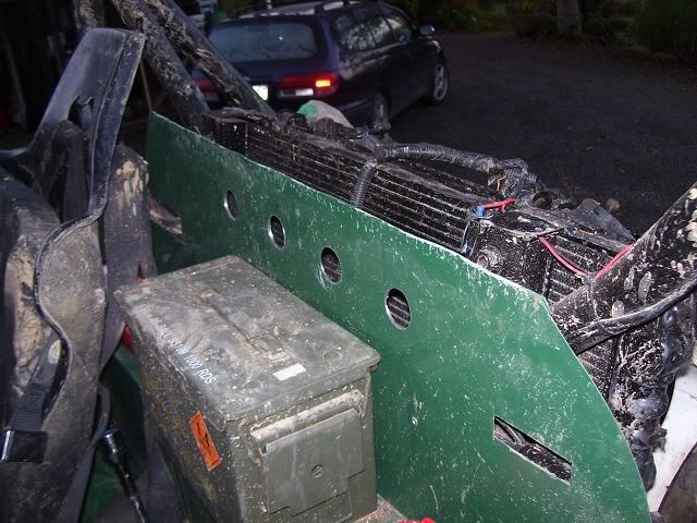

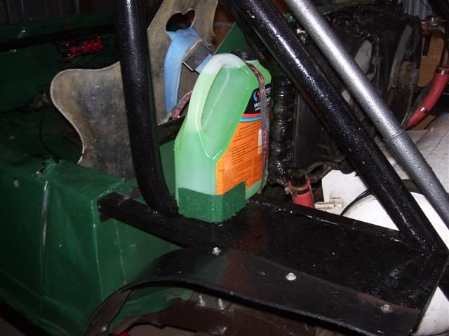

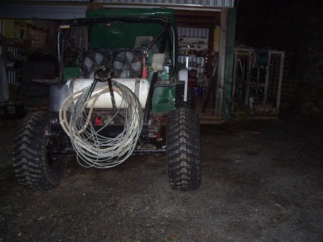

well got a few little bits n pieces done today.

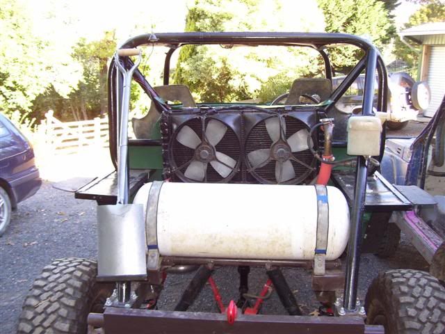

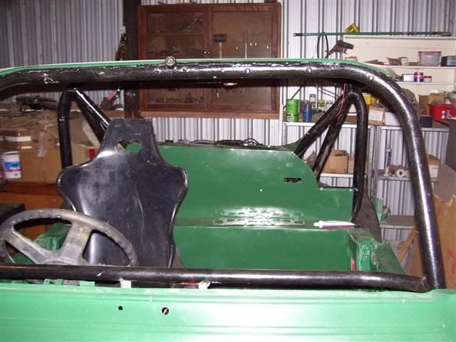

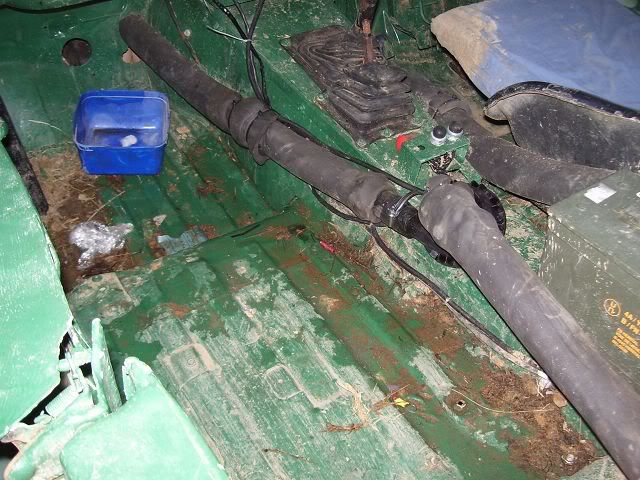

finished off the dash to finish off protection from battery and lpg stuff. also covered up the grill on the top of the body and covered up switch board.
also mounted some water containers for radiator there is 9 litres there (4.5l per side)
and fixed my tool boxes in place
meatc
Posts: 979
Re: hizuke project
Post by meatc »
8) 8) 8) 8) Coooooooolllllllll 8) 8) 8)
Bout time you got it finished. :lol: :lol:
When we going for a play :?: :?: :?: , (best not next weekend, after Ive been away all this weekend)
The coils will squeak mine do but you get used to it. Cant wait to see it in action.

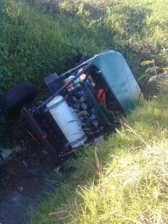

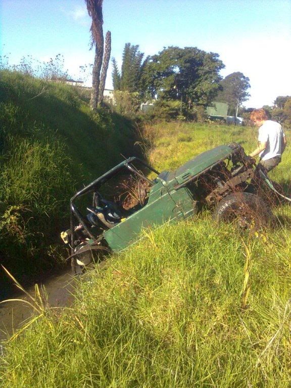

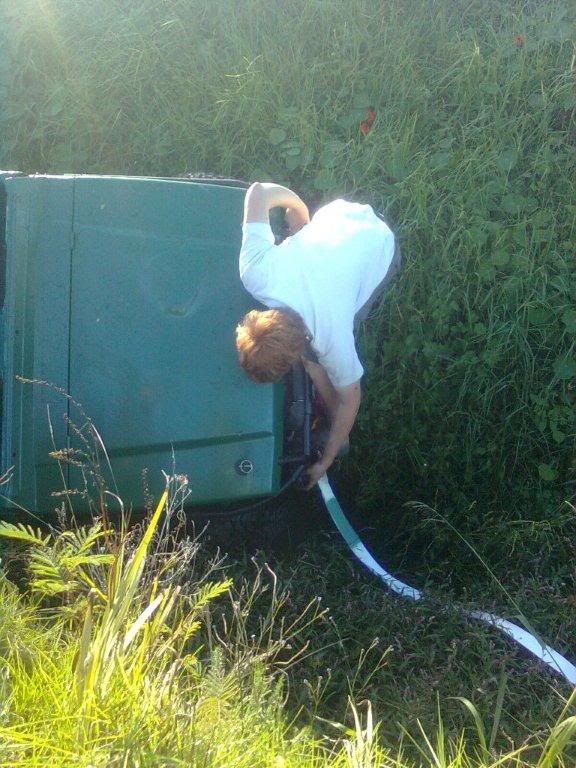

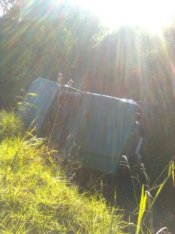

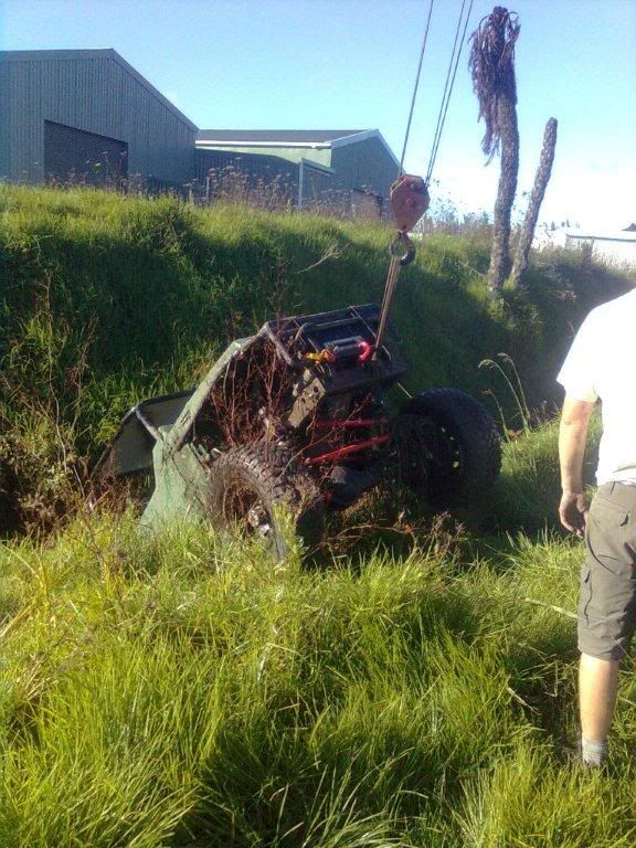

well went to get my cooling system sorted and got it working good but got told to drive down the creek to test it out mmm well this is what happened.
motorhead
Canadian
Posts: 227
Joined: Mon Oct 05, 2009 3:09 pm
Location: Martinborough
Re: hizuke project
Post by motorhead »
Bummer, did it survive? Might want to move the radiator overflow tank inside the cage as not to knock it off when the Zuke wants to take a nap again :? .
Nice job overall 8)

new2zukes
Posts: 761
Location: kerikeri northland
Re: hizuke project
Post by new2zukes »
hey yep have moved overflow tank inside a litte and yep it survived, but for some reason when i was on that steep angle facing forwards it took all the water away from the motor so it got hot VERY quick. also oil presure wasnt too good at that angle. only breakage was mud guard on the left side but that was going to break anyway. also found out im going to have to redo my rear drive shaft as it viburates shit loads and has way too much movement in the double carden joint it is also a bit out of ballance. but i will do dans fun rally then i will make a new driveshaft. got a mate with a tube cutting tool so i can cut it dead square. apart from overheating on that angle it went awsome couldnt be more happy with the performance suspension works mint as.

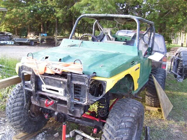

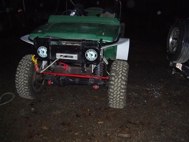

well did a little work on the truck in the last few weeks. mounted front guards, welded on some winch rope horns. wow thats it bugger thought i did more than that, ah well its ready for our first wet run for a very long time due to the drought. but here are some pics of what ive done.
oh and some club members have come up with a name for my truck "The Grasshopper"

well did a little mods to the truck after its first thrashing.

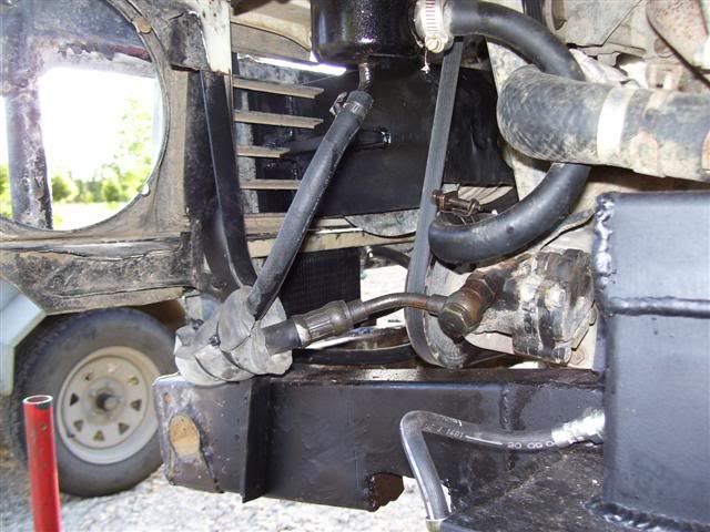

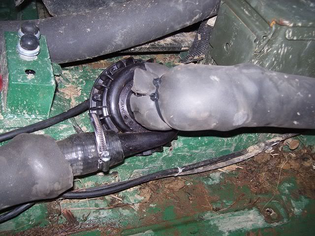

fitted a 115l/min electric water pump.
also made the airflow into the radiator better.

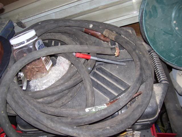

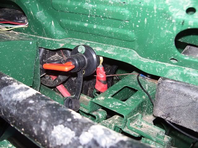

and replaced the winch isolator switch which wasnt working.its rated at 500amps
am also going to order a set of 35x13.5r15 mudzilla's

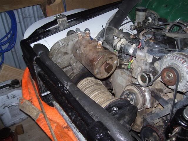

well just bought an 8274 on trademe, winch is in great condition works well, but was wondering how i can find out the hp of the motor as i have a 4.6hp warn motor here and am wondering if its worth swaping it for the one on there atm. only real problem i have with the winch is it sits a little too high for the bonnet so i will be cutting a whole and makeing a bump in its place. then i will be putting a bar/hoop on the front bar so if/when i roll over i wont squash the winch.

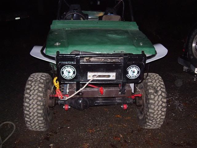

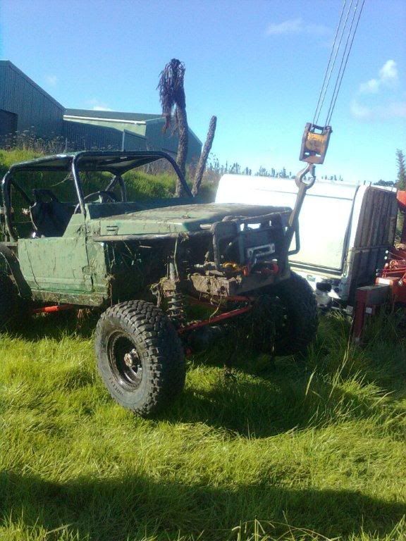

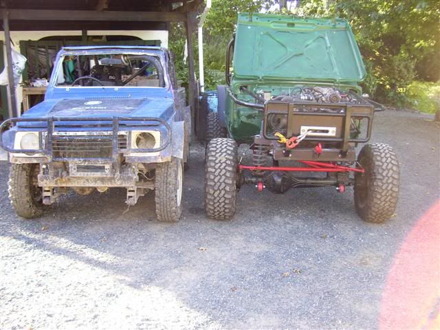

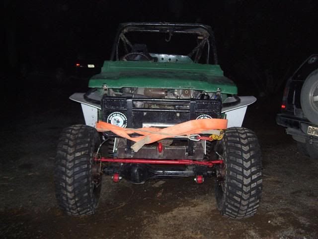

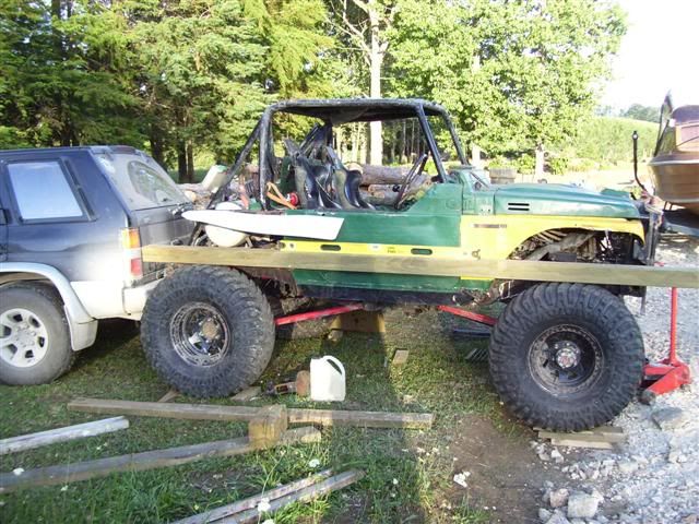

well finally got some photos of me new tires on the truck. unfortunatly i haevent been able to take any pics in the daylight.

Re: hizuke project
Post by You Get That »
Righto i am currently doing the same thing to my zuk and have a few questions.
I drilled new holes closer in on the front diff mounts and the springs still wont fit? How much bending out did your front springs have?
Also how are your 35in tires handeling with stock transfer and diff ratios? is it tough on your clutch?
Thanks

You Get That wrote:Righto i am currently doing the same thing to my zuk and have a few questions.
Thanks
I can answer the bit about the springs. He didn't as he has gone to coils not leafs. If you have a narrow track you cant do the drill oew holes things. On the wide track models 1988.5 onwards you can. they are about 50mm a side wider in the spring mounts.

Post by new2zukes »
Thanks
well i would say you havent read all of my thread as if you did you would notice im running hilux running gear (gearbox, transfer case,motor, diffs) as for getting bigger tires to fit you can either do alot of cutting of guards and spin the centres on your rims to give a bigger offset so tires dont rub on springs or run wheel spacers then the problem will be spinning them if you still have a stock motor. the list goes on so if you want a little more advice start up a build thread (if you already havent) and we can give you some advice. hope this helps.
