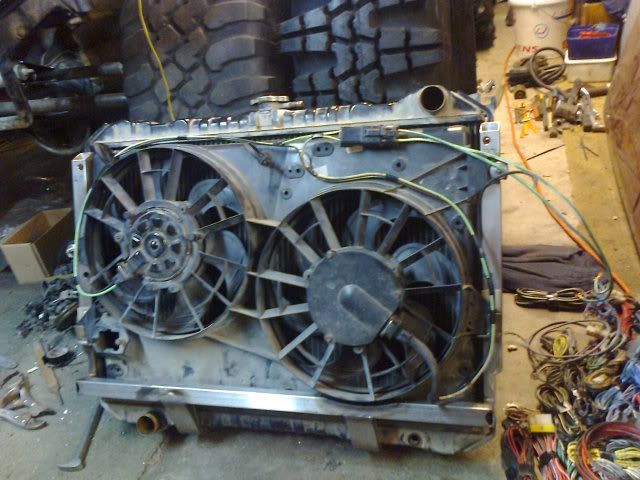

Ford Mondeo fans mounted on there own frame that supports there weight. Glued rubber 'flare moulding' to shroud edge that sits against radiator core. Moved Radiator forward 40mm to give fans plenty of room, which ment losing air-con and bonnet latch, and cutting recess into bonnet brace etc etc

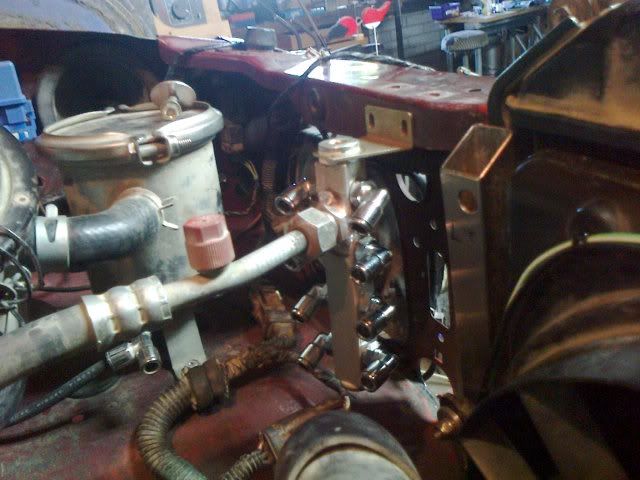

Welded ali fitting to manifold thingy so I could utilize standard air-con hose for on-board air. Drawing air off the top of the motor breather catch can
Napenape

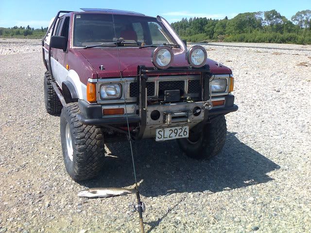

Nice fish you caurght O sorry that should have been nice truck :roll: :lol:

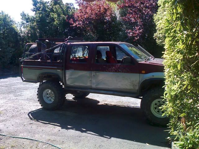

shit Jezza, what's wrong with the rh side doors in that pic above? :P :P
kbjj
Posts: 712
Location: Rangiora
Re: D21 Navara SAS with falcon rear leaves
Post by kbjj »
rokhound wrote:shit Jezza, what's wrong with the rh side doors in that pic above? :P :P
Minor prob, window winders go around ok but no glass appears. Just as well really, cos at least the boy can get in and out of his door that wont open, and I can reach the bungee that holds mine closed. Now I just need a bigger garage to put her in when not in use

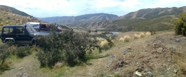

Went up to old Townshend hut site (simple farm track) and found a lovely wee camp site. Photos are from a couple of side tracks that may need a little further investigation with the right permission :twisted:
