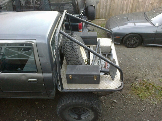

motivational post of the day goes to chris :lol: and the result of the last 2 hours.no its not quite all gone and cleaned but couple of hours 1st things sat morning will sort that out
and yeah i'm pretty sure axle will stay where it is,i cant say ive had any issues with it yet and it gets me where i want.but yeh,i suppose if you've still got it i could take a quick look,in saying that be a waste of my big 3mm sheet ive already cut :lol: and na, Josiah don't need electric windows,he'll have a full exo to use as a ladder to get onto the deck when required :mrgreen: .but maybe i try swing by this weekend and have a look if your free
