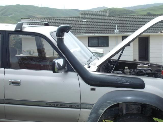

got motorvated over last couple of evenings and fitted snorkel to guard, still need to do more in that area..........

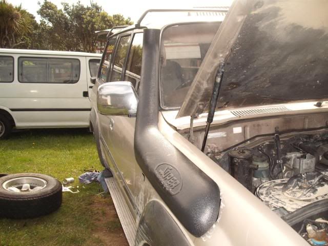

this piecing back together shite is faaarking me off, and then theres the faaarking cheap shite snorkel

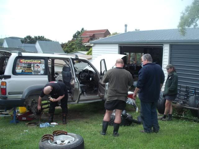

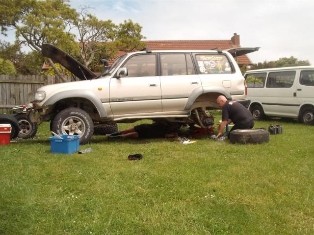

well we're almost there
Reece, Jerry, Pedro and Brent turned up to lend a hand.
Snorkel is now fitted and working well, aye Reece :lol:

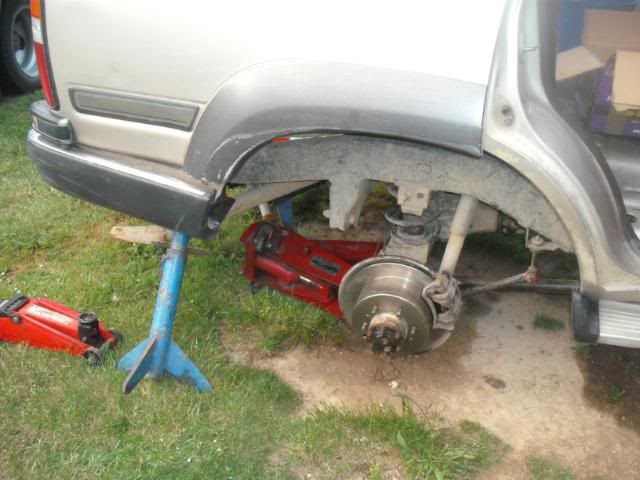

Rear brakes work attempted, but we gotta do some hub seals and bearings first :roll:
Diffs and gearbox all filled up with oils again and then emptied, due to rear diff needing the above mentioned bits :roll:
Lights, grille, horn, bonnet catch etc etc all bolted back in place and operational.
still farting around with some interior bits before seats go back in and then some minor things here and there and its on the road again.
:D :D :D :D :D

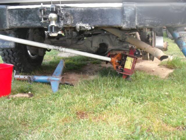

but, whilst we were standing around looking at it at some stage, it decided it had gotten tired and decided it didn't want to rest on a jack and axle stands anymore............
so here we are nearly done. the 33s are back on, just gotta fill up rear diff again, bleed brakes, put an exhaust flange gasket in and sort out interior.

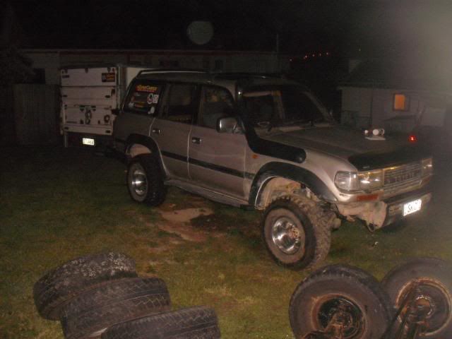

I'm outta here, going for a drive to drop off bits at my engine builders :D
TAKING THE 80 ImageImageImageImage

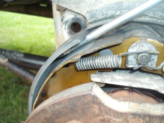

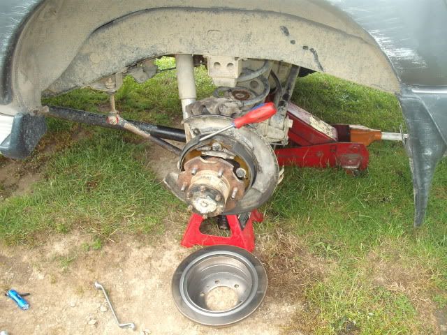

have driven it 3 times now and its developed a screeching noise that comes and goes at times from the rear end, so today I tried using the handbrake whilst driving and it makes the noise go away, so I got home to check out what the faaark was going on, and ya wouldn't bloody believe it, but the curse of the damned 80 hasn't finished with poor skiddy yet
now gotta take bits back to shop on monday and ask the question.............
WTF :shock: :shock: they are brand new handbrake shoes for faaarks sake..............
Re: SKID'S SUBMARINE IS ALMOST ALIVE: working bee Sun 22th Nov
shoes de-laminated, happens a fair bit bro, nothing strange there, you may have had it a little tight on her adjustment side causing slight rubbing while driving = exess heat and de-lam... but yea go back to shop and get new set
