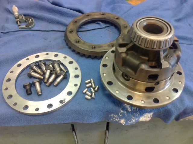

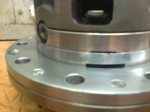

How to fit std 4.8 gears to a rear 8 inch elocker... add a 9mm (mines 8.5)spacer behind crown wheel. Also added 8mm dowel pins, 3mm into flange face and made longer bolts, (11 x 1, 30mm long)
Then had to add a 0.4mm shim (8 x 400) around centre, for crown wheel to locate onto. Worked out spot on, still had to heat crown wheel so it dropped on, and it nipped up when cool

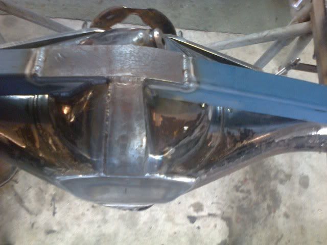

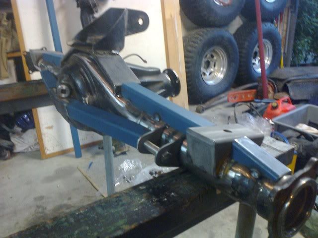

Work in progress... 8 inch elocker

man u make em strong lol, how much do you reackon it costs materials wise to do something like that?
kbjj
Posts: 712
Location: Rangiora
Re: D21 Navara SAS with falcon rear leaves
Post by kbjj »
Dirtydog wrote:man u make em strong lol, how much do you reackon it costs materials wise to do something like that?
Not sure, left over box and plate from other jobs, I throw fark all away. Materials cost buggar all imho, labour is the killer

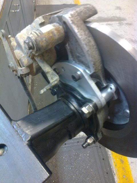

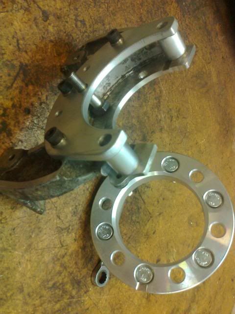

EA Falcon brake calipers modded to fit hilux axle
Put a wee groove in back of wheel spacer (adapter) to keep factor hole in axle flange clear to enable wheel bearing seal...ummm... slinger thing to do its job
...and fitted up, used early hilux front rotors (xx154)
Axle is in truck, wired, plumbed etc, and just finished handbrake cables today. Yet to be used in anger.
When I did the cab swap, I fitted a Terrano booster (master cylinder the same 15/16 inch). I noticed an improvement in feel with light braking, but similar feel under heavy braking (and pedal would hit floor still, although ample braking). Decided to fit a Safari master cylinder today (1 inch bore), as more braking was there to be had. Have definatly gained braking
