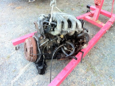

Here's my pic of the beastie.
Wax, going to be fitting the lightened flywheel? i take it it was a NA motor with 6 bolt flywheel? That standard flywheel looks huge.

Post by wax »
Hey simion. Im going to use the td27 light weight that on it now. They are massive and you would struggle to lift them off the floor by yourself. They are also for a 250 clutch unlike the 240mm of the td27 so they pick up some weight there

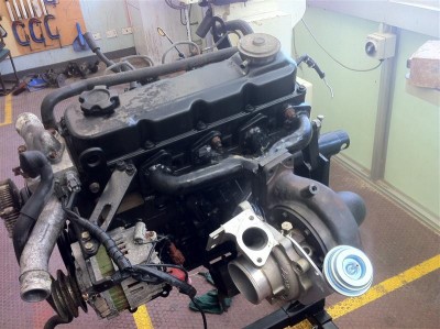

wax
Posts: 510
Joined: Sat Nov 26, 2011 5:42 pm
Re: The wax terrano

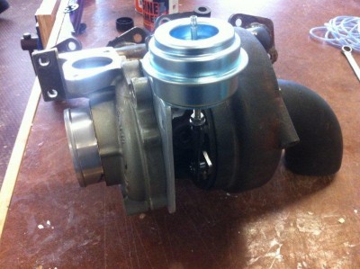

Post by wax »
Well the qd32 is on the stand. Yes it looks a mess I will fix it up to be a thing of beauty. mm maybe not but it least it will be painted. I bolted the turbo on just for kicks

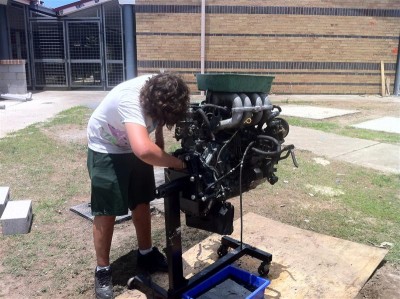

Post by wax »
A bit of a clean up and its getting closer already

sibainmud
Posts: 1846
Re: The wax terrano
Post by sibainmud »
Cheap labour :!: Best kind :wink:

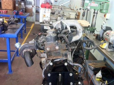

wax
Posts: 510
Re: The wax terrano

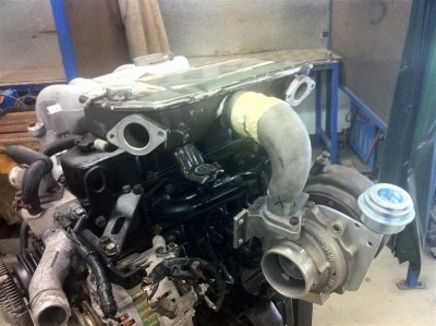

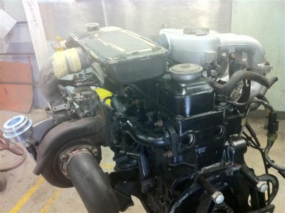

Post by wax »
Ok well still working away on it but slowly, I have been racing my scooter and so time has been short.
This is the motor today with the intercooler and piping just needing welding and then its ready to go. I also linished the manifold to make sure it all flat.
Im really looking forward to getting this in the truck and so it will throw more sand at the beach.

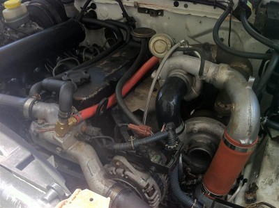

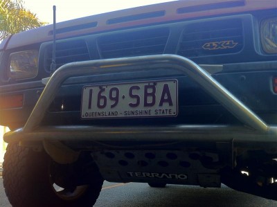

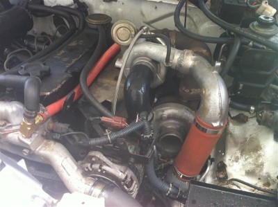

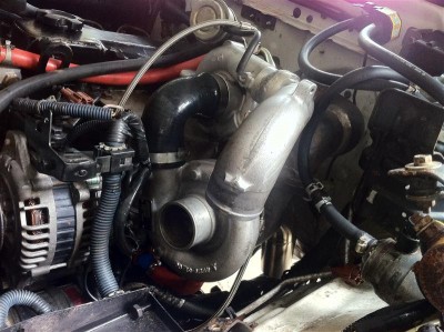

Well not much going on as its holidays and I am drinking.

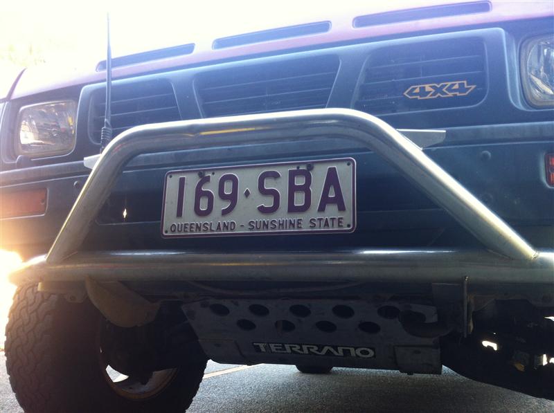

But did manage to get hold of a sump guard for the truck the trick alloy ones.
Also got some more pics of my mates qd32 twin turbo

wax
Posts: 510
Re: The wax terrano
Post by wax »
I have been playing with my mates qd32 twin turbo. Its insanely fast, so much that cars struggle with it off the lights and really have no hope once its rolling. Its really upset me as the terrano feels so slow now
slide
Posts: 895
Re: The wax terrano
Post by slide »
Bit more motivation to gets yours in then?!
Whats he done for fueling? Bigger internals in the pump like your setup? I'm guessing hes got a front mount inty? (can't see piping in pics, so I'm a guessing thats where it goes)
