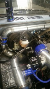

Got it sorted,wasn't as bad as I initially anticipated,hack a section off silicone elbow, then cut a section of aluminum out of the pipe, join back together and everyone's happy...

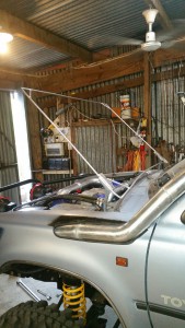

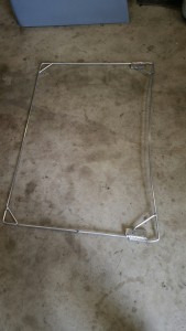

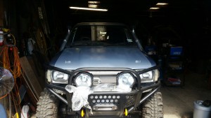

Well Got my top bonnet skin,have made a basic ali frame to attach to hinges then will glass it onto the skin..that's the plan.managed to get everything apart from my breather tank low enough to fit under with out chopping holes,so will remake that...

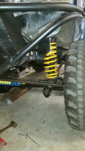

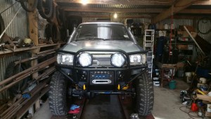

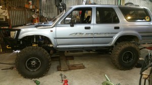

Also since I put the big hunk of steel and winch on the front,it was just touching bumpstop, there wasn't much clearance there before but...well there's a huge difference between saggy old 80 series springs and 2 inch lift...hopefully they settle and sag a bit. Will reavaluate once Exo is on...
Didn't drive it,cause alternator gave up the ghost so will fix that during the week but doesn't seem to be as spongy/rolly when I jump on the side of it
Mattman
Posts: 1643
Location: Kapiti
Re: first surf build.
Post by Mattman »
Getting closer!

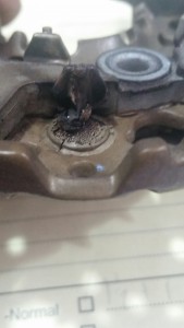

Hmm pulled alt apart, destroyed rectifier, forgot to disconnect it when doing ac tig on bonnet brackets didn't I...

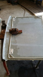

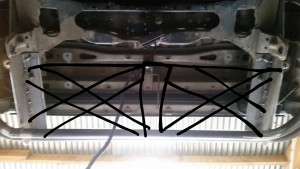

Bonnet is just about finished,fibreglass shop recommended 5min stuff, that's a mistake. Bloody stuff set before I could really so anything... got part attached but will get some normal glass and try again.... got bonnet pins fitted,will glass in reinforcement plates under when I finsh it.

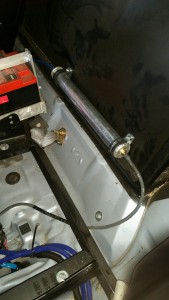

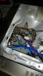

Finally made a vacuum tank for rear diff lock and plumbed it in,that works a treat so far.also left the old cruise control vacuum pump and switch in line to the solenoid for what ever reason loose vacuum to it the pump will kick in.

It does work to engage/disengage the rear diff lock but a bit slow, almost instant under engine vacuum.have a one way valve in it,but as a precaution for when under boost I guess

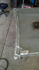

Went and saw the boys at 4wd fiberglass for fibreglass (don't know why I didn't do that to start with....)got the right stuff and finshed a layer on the bracing..might get some more to add a bit around hinges etc.

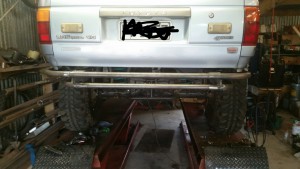

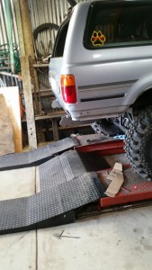

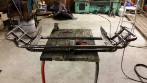

Started the basis of rear bar,kinda copying off one of Tom's I saw on Facebook hope he doesn't mind... thinking I might fit crush tubes to chassis as plan to carry Exo on from bars

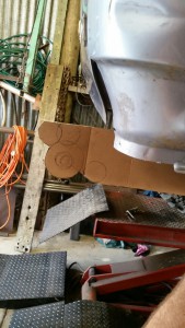

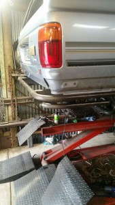

Will upload some more pics when on wifi, but anyone know the standard dimensions for tow bar receivers? Have some box section off original tow bar I think will be right, it's 65mm od haven't cut it open to find out Id yet. Plan for rear bar is this as it's mainly tube I think it should hold up tuff enough.bolts through chassis in 8 spots.
thoughts?

skidmark wrote: thoughts?
over kill. Thats my thought. Unless your crosses are something fairly light?

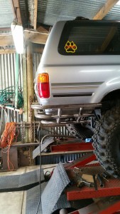

So 2 inch us pretty much the standard?couple more pics from today
I was considering that.. same as I've been using for the bars 42 mm tube with 3 mm wall

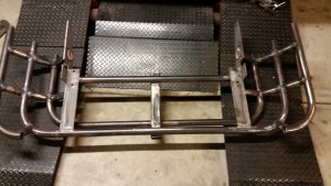

Got most of the external bits tacked together,have to trim and finish the edges yet.

Post by skidmark »
Considering I have tendency in my opinion to over build and shit weighs tonnes.do I need to add anything more to this brace wise? (I still have to cap the ends)

Post by tomsoffroad »
Nah you've overkilled the #### out of it, it'll be sweet from what I can see :mrgreen: :mrgreen:
