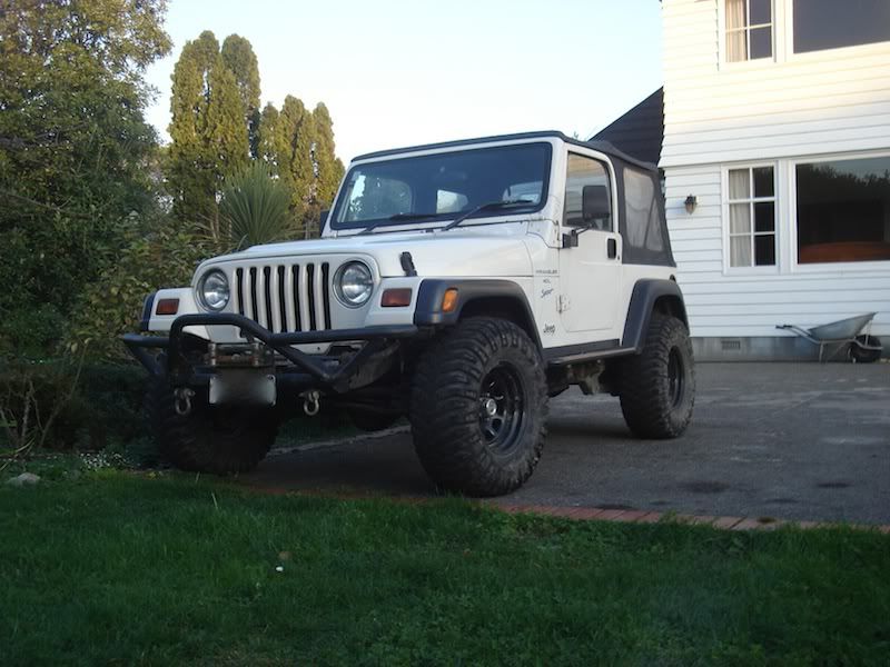

The bar worked out ok. Not entirely happy with the finishing, things didnt quite line up 100%, but not a bad effort for something built on a garage floor I didnt think.
All in all, im happy with the final result of how the truck has finished up though. Went for a drive with a bloke 2 weeks ago who's got a willys tub on a patrol chassis/diffs and a 350 chev up its butt. I walked 1/3 throttle in a couple of parts that he was full revs and mud flying while trying to get up on 2nd attempt. Bugger all to do with the driver though, all about the wheelbase and where them tyres are sitting.

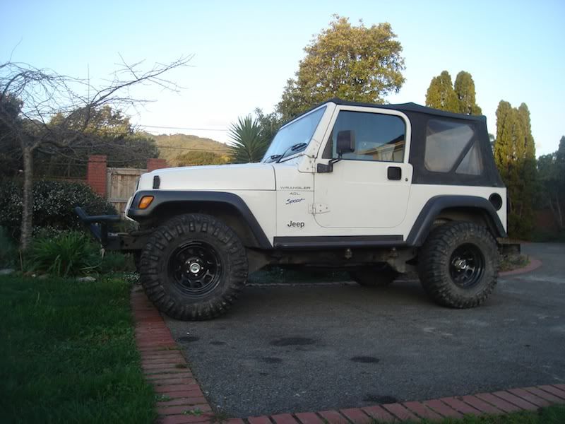

Completed my 3.5" lift today, making up a front tow hook and getting mud tyres on 15" white steelies fitted this week so all go for the long weekend, no pics yet as it gets dark so early.

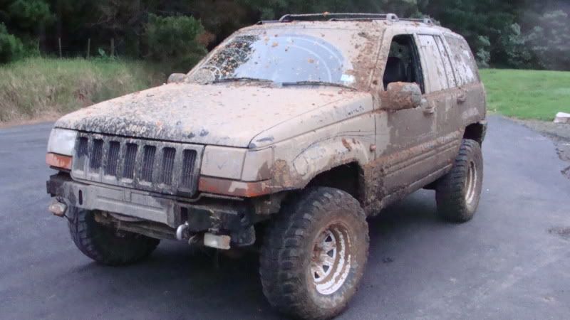

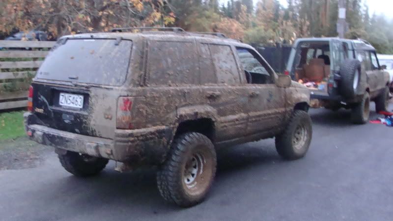

First outing after lift and tyres, front driveshaft shat itself, just as well I had a spare in the back. Am now on the lookout for a driveshaft off an XJ.
Lift gives a bit of driveline vibration. Front tyres rub on full articulation when turning, no sway bars fitted. The kit is said to run 31s but I'm gonna need to cut the front guards. No worries with the rear.
Cost all up is $5400, can't complain

It was a 3.5" lift, I forgot to measure before/after and took photos for comparison.

you running 31s???..check frt drive shaft for any movement..that can cause a vibration when driving on road ,,did on my xj...if not mark (xj) will have a idea..may have to do trans case drop thingy...mine was fine with a 3 " lift...

Yep on 31s. Lift kit supplied a transfer case drop kit, looks to be about 1 and 1/4", I think to remove the vibration I'll need to go longer/adjustable upper control arms as the kit only supplied the lower ones. But they aren;t cheap lol.

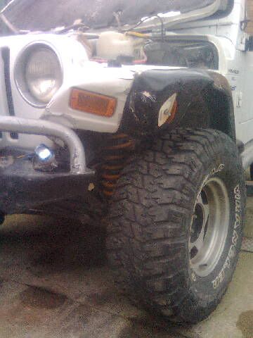

My 4.5 inch on 33's rubs on full lock too. Arb bar and guards might get a little trim too. Want to find an alternative to simply taking a grinder to the guards though. Might look into the cost of rolling them.

Yeah I was just gonna take to the guards with an angle grinder and cut the lip off at the arch then rivet in some rubber flares to hide it. I'll re fit the front sway bar so that should help also. Without them it drives worse than an old Kenworth and that is saying something lol.
Managed to change that driveshaft out before she let go, was clicking badly on the smallest articulation after the first mud bog so didn't take any chances.

Coop, theyre utterly horrid without the front swaybar on. Re cutting the guards, id prefer to have a lip left so theres no sharp edges left to potentially cut tyres and to also leave a bit of structure to it
