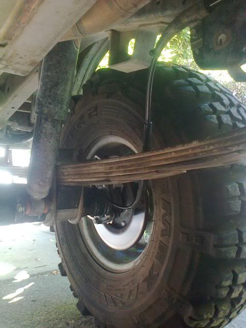

Hanbrake cable hangs a bit low... but oh well
Modified original handbrake leaver mount plate, moved curved tube piece. Will make another at some stage, and move cable attachment point back towards pivot point of leaver to enable more leaverage, as works with only 3 clicks but requires a lot of grunt

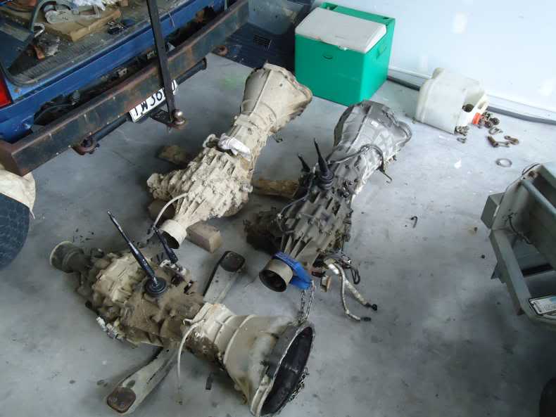

As sad as it may seem I have two of these big gearboxes you are after

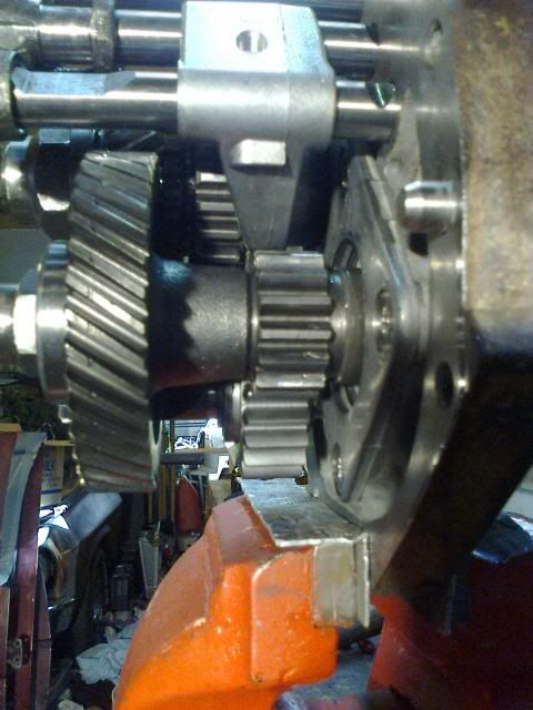

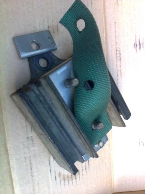

Gearbox mount, strapped as I have torn 2 recently. Think it happens when skidding belly up a bank.

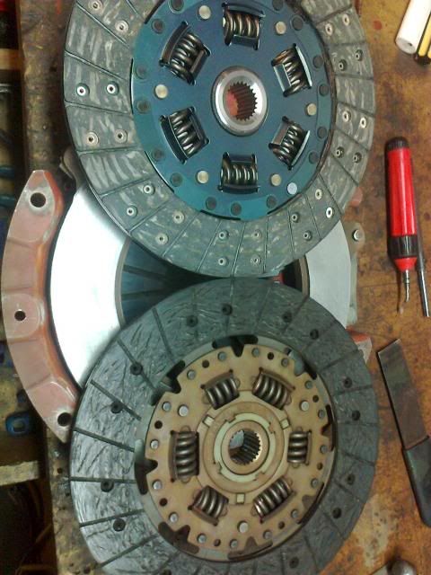

Front gearbox seal let go. Got hot I think and spun in housing, appears to be in good nick. Hi temp sucker going in. Was also told last bearing change in gearbox to run new bearings with seals in. This doesn't allow the oil to drain back to boxfrom behind the nose cone housing. All bearings had no grease left in them, and were chokka fill of oil, dirtyish used looking oil. Will be running without bearing seals this time round and redline oil.
So... new clutch plate, new generation I'm told. More rivets, stronger all round
Replaced reverse idler gear, reverse counter gear not the happiest, so turned it to run on opposite side of gear (smallest gear closest to you in pic). As it's offset, it ended up running more inline with idler. I just had to nick the raised tops off the shaft splines to allow it to go on. Unsure of why it wasn't like this in the 1st place, doesn't affect clearances with anything else that I can see. Tested all gear selections and looks ok, time will tell.

That the big box for sure. I will use one of Simons pics so you can tell the difference

Sorry for the thread jack Jezza. Clutch plate looks good. What you need now is a "super" pressure plate to match it. Like this one. Check out the clamp force written on it when tested 8)
kbjj
Posts: 712
Location: Rangiora
Re: D21 Navara SAS with falcon rear leaves
Post by kbjj »
Yep, pressure plate sorted, been running a "heavy duty" one for a while now, Clutch Systems here in Chch uses a different diaphram spring. Very happy with how it performs.
