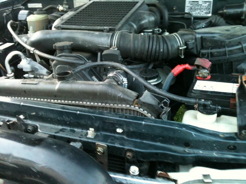

After doing this the other day i thought i might get a bash plate made up to stop my radiator trying to escape through my bonnet scoop.
she is up at Toms for him to work some magic:)

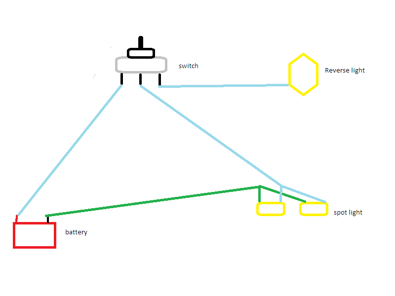

now i want to mount these onto the top to brackets of my reat bar
question is i want to wire them up to run off my reverse lights as well as off a permanent switch, from inside the boot.
does anyone have a wiring diagram that i can use.
Mattman
Posts: 1643
Location: Kapiti
Re: VVILLY TONKA-KZN185
Post by Mattman »
I wired in a single reverse lamp that is run off a three way switch. I don't have a diagram but hopefully this is clear.
Off, on, and auto. Auto is triggered by the reverse lights. The switch is a double throw with two LEDs to show what mode is selected. The switch has an earth to a light pole for the illumination LEDs.
The single reverse LED lamp only draws 3.2 amps so I don't use a relay to power it, the switch is rated to 15 amps so can handle the current. The switch has one input and two outputs selected depending on the rocker position. 10a fused 12v goes to the input pole.
One output pole goes straight to the led lamp for on mode. The other pole goes to a normally open relay that is triggered by the reverse lamps. One side of the relay coil is earthed and the other is fed from the reverse circuit. The supply comes from the switch to the relay and goes to the reverse LED.
Any questions let me know.
Matt.
vvilly
Posts: 1134
Location: Rangiora
Post by vvilly »
how is this???
will this work
KIWI_TERRANO
Posts: 1138
Location: Kirwee
Post by KIWI_TERRANO »
vvilly wrote:how is this???
will this work
Oh wait looks like my doodle haha
vvilly
Posts: 1134
Location: Rangiora
Post by vvilly »
will this work
um..... your doodle??????
yes it looks like your drawing brad
Mattman
Posts: 1643
Location: Kapiti
Post by Mattman »
As long as you don't try to use an illuminated switch as they expect one input and two outputs whereas you have two inputs and one output.
That's why I went with a relay so the illuminated switch would work. I couldn't find a dpdt illuminated switch so used a spdt one with a relay.
Matt.
vvilly
Posts: 1134
Location: Rangiora
Post by vvilly »
Mattman wrote:As long as you don't try to use an illuminated switch as they expect one input and two outputs whereas you have two inputs and one output.
Matt.
show me your art skills Matt hahaha
KIWI_TERRANO
Posts: 1138
Location: Kirwee
Matt.
3 way switchs have 2 inputs and 1 output as in picture? Thats just a standard toggle switch nothing fancy
And i think he mounting it by rear door so a switch with a light in ant all the important, shouldnt need relays for a set up like that
Mattman
Posts: 1643
Location: Kapiti
Post by Mattman »
No one's going to see my doodle! Haha.
As above Kiwiterrano - this will work okay as long as you don't want to use a switch with illuminated LED's in it as the reversed current flow through the switch by using it with two inputs and one output means the LEDs won't light up on the switch.
If you are just using a simple no led switch then go for it.
Matt.
