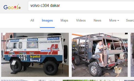

Re: Volvo C304 4x4 Build/Restoration
first thought... I'll google pics... guess what... first two pics are yoursgeckoadventure wrote:- Full restore of cabin covered in a comp spec rollcage - think Dakar truck - Rahmat from Rahmat playhouse garage is already crying after seeing the picsCameron wrote:awesome that you've got another!
what's the plans for the new one?
