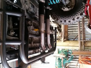

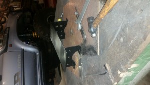

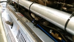

Few updates..finshed exhaust now that Bars done.

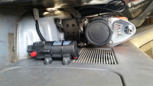

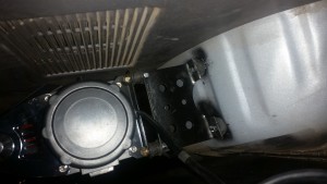

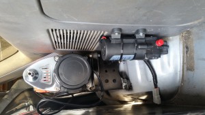

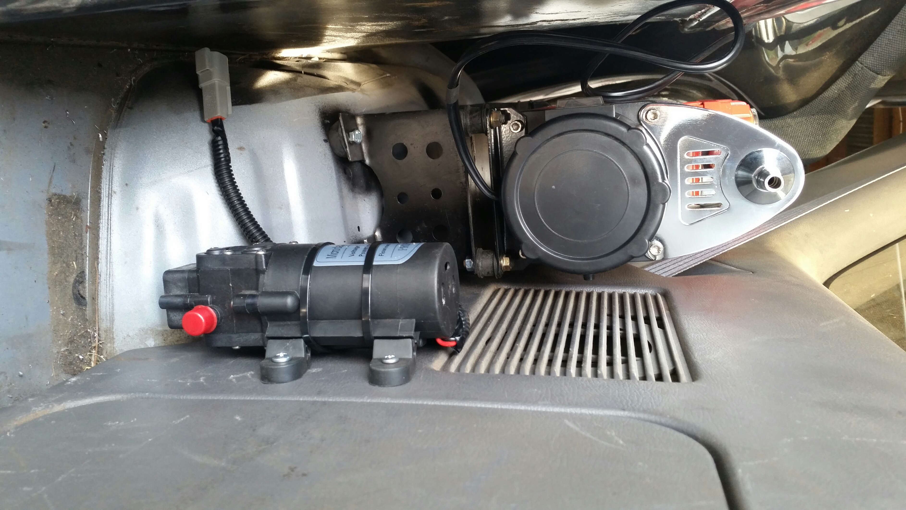

Bought and mounted a compressor
Double rubber for extra protection

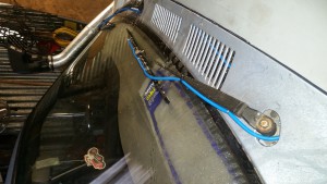

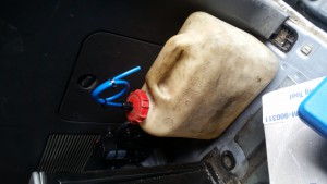

Mounted my pump I'm gunna use for Windscreen washer, and ran the hose through the truck. Not decided on how to do washers themselves tho. Will mount a plastic tank up in the boot

I am looking to add a second set of washers. Looking at a set of wiper mounted washers and another pump and resourvoir.
What are you running pump wise?

I got one of these of eBay (the thing screwed to the plastic)
http://pages.ebay.com/link/?nav=item.vi ... 90&alt=web
Haven't got it hooked up to any nozzles yet,not sure if I want to add bonnet mounted ones or should fit something onto wiper arms. Any feed back on preferences people have?

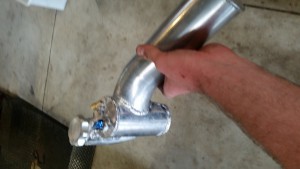

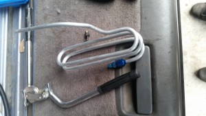

But welded the overflow up..
It's ugly.havent mounted it yet tho

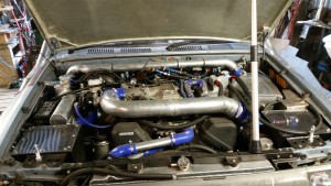

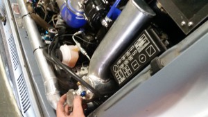

Finshed mounting Rad overflow tank...it's ugly but fits in the last hole I had in the engine bay...
Big
Posts: 2134
Location: central Otago
Re: first surf build.
Post by Big »
Mate.. she's busi in there.. I just don't know how you managed to squeeze all that in there.. :lol: can't wait for the show down.. :wink:

Big wrote:Mate.. she's busi in there.. I just don't know how you managed to squeeze all that in there.. :lol: can't wait for the show down.. :wink:
There's probably a bald spot at the back of my head from all the headscratching.

Getting small windows to do some work, got washers basically finished up,still have to wire them and then just throw a strap over the tank to mount it..tank is possibly temporaryish plan was for bigger but it'll do.. also started bending compressor cooling ring,weather it's needed or does anything but yea...picture time..

Jets may need slight adjustment but not bad for a guesstimate.3 holes on each arm . could add more yet I think

Looks good. So just capped hose with some holes cut?
skidmark
Posts: 616
Location: hamilton
Post by skidmark »
Mattman wrote:Looks good. So just capped hose with some holes cut?
Yea just threaded a m5 stainless bolt in the end, and put 3 1mm holes in each one. I'll take a better picture next time I'm near my truck

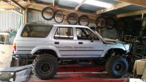

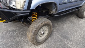

Got it moved Into its new home now, good news is that it fits in the shed on 35s. About 20mm clearance or so..so it's allgood. Had to through some old 31s bickies on to get on the trailer....not a good sight

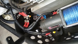

Got main battery feeds through to the winch..95mm cable is fun stuff
