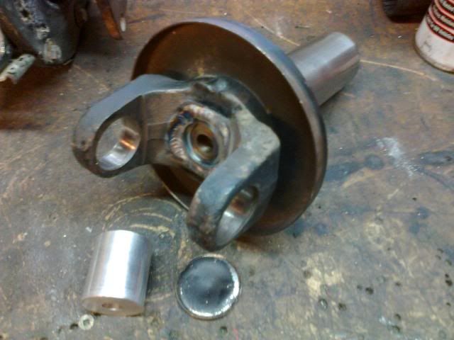

Centre driveshaft bearing rubber stuffed again, so drilled and tapped transfer case output shaft to take my new 'slip yoke eliminator'
Now the rear spline has to do the work and centre drive shaft bearing rubber shouldn't move buggar all, therefore last longer. Need to make new rear section of drive shaft and balance. Current one has too many dents
