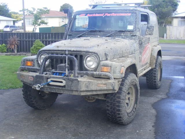

looks good mate........
v8 tj...luvs the gas......

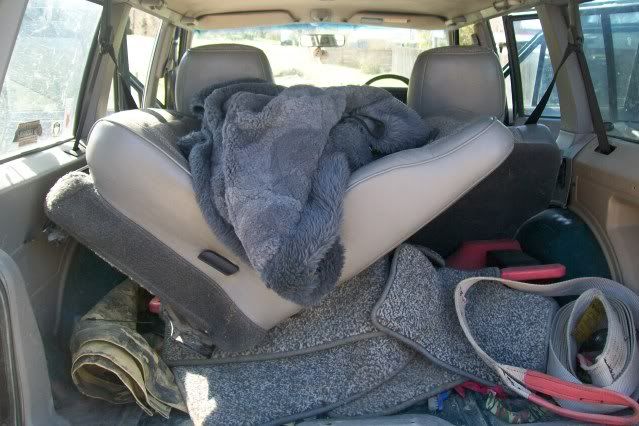

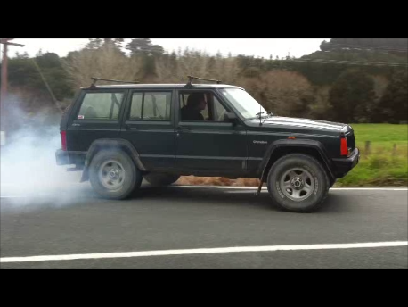

Na mate put simply I want something that is a bit more rugged that I don't really care about. The ZJ is in relatively good condition inside and out so not really wanting to put it into a tree etc. I have the interior out of it atm cleaning everything, what a mission.
But I bought this XJ today, picked up for 1500bux, wof and reg, tight LSD and good power, can't complain with the bang for buck the old XJs offer.
Plans are 5" lift, snorkel, 33s, Aussie locker in the front, gutting the interior. I'll probably end up blowing front UJs but oh well lol.

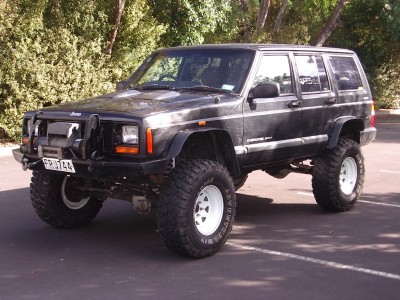

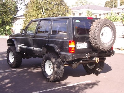

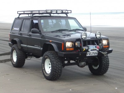

Here's mine.

Cool... I likies!

nice bill... was following this on cf but lost thread......did ya notice any difference in engine temp with ya hood vents in....throw up some info of ya jeep.. :wink:

That is one mean jeep mate :D

I bought this stock XJ about 5yrs ago, but was driven by the wife. Got it back off her about 12 months ago, and the mods started.
- 6.5 inch Rough Country 'Long Arm' Kit.
- Self fabricated Panhard Bar bracket
- Self fabbed Steering Box Brace
- Self Fabbed Panhard Bracket Brace
- Custom Adjustable Panhard Bar thanks to JK Racing (Pukekohe).
- Custom Slip Yoke Eliminator thanks to JK Racing.
- Custom rear drive shaft from Beatty's Drive Shaft Center.
- 'Over the Knuckle' steering mods
- D30 front, D35 Rear (but wanting a D44 if cheap enough)
- Self fabbed bull bar, rear bar (with swing out tire carrier)
- Pic shows old GEW Winch - now has new Runva 9500 thanks to Mike at Winch.co.nz
- Larger Trans Radiator, Power Steering Radiator
- 'On Board Air' from air conditioning pump, with aux air tank mounted in the rear.
- Lifted Tow bar with removable tongue.
- Both front and rear guards have been cut, with flexible plastic flares added (for WOF)
- Vented Hood
- Too many little mods to mention
- 33inch GT Radials on 8inch Steel rims
Pictures don't show fabbed 'Roof Basket' (with mounted 4x Spot lights)
and 2x Light Force spot lights on the top of the Bull Bar.
I'll up-load more pics soon.

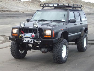

Today at the Muriwai Beach 'Clean Up' with the Auckland 4X4, and Landrover Owners Club.
This is how my XJ looks at the moment.

Mate, love it.
Would be keen to see it in the flesh one day

Awesome XJ you have there, how does it handle and ride on road with the 6" long arm lift? Did you get rear leaves out of the states aswell or get them raised/reset/blocked over here?

yeti wrote:nice bill... was following this on cf but lost thread......did ya notice any difference in engine temp with ya hood vents in....throw up some info of ya jeep.. :wink:
The vents didn't reduce the temp (much) when driving hard, but it cools down to normal temp alot quicker than prior to putting the vents in, as they let the heat escape quicker.
I have also put a manual override switch to the electric fan, so I run with this on most of the time in the bush. With the fan on, and the vents, the temp doesn't appear to rise above 105-110.

coop wrote:Awesome XJ you have there, how does it handle and ride on road with the 6" long arm lift? Did you get rear leaves out of the states aswell or get them raised/reset/blocked over here?
Above I laid out my plans to get my XJ sorted, which are now down the shitta, I ended up impulse buying a Chev Silverado on 37s. So not a jeep but my flatmate has a pretty capable XJ, we should all head out to Woodhill one weekend, no jappas lol.
This Rough Country Kit came complete with EVERYTHING !!! Rear springs (no blocks used on these), shocks, brake lines, the worx.... The only part(s) that I could not use was the Panhard Bar, and the Panhard bar Bracket, as they are only compatible with left hand drive models.
The RC Kit is good, but I have a lot of trouble with the main Flex Joints on the lower arms wearing prematurely. The kit is a year old, and I am on my third set of joints already. Rough Country have been pretty good with their 'Life Time Warranty' and have supplied the joints free of charge (and no charge for shipping) but I am still annoyed with having to swap them out all the time.
The XJ rides nice on the road. It's certainly not a harsh ride, but I think that comes down to the weight of the front and rear bars. I also drive it with the Sway Bar disconnected - These were supplied with the kit as well. No drive line vibes either.
Been to the Jeep Park at Woodhill many times now, and always keen to go again !!

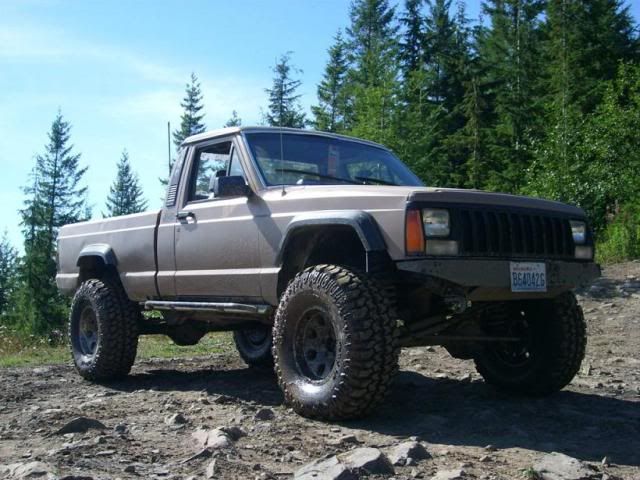

got a few photos of modded jeeps over here plus anyone heard of a two door xj seen a few

coxsy wrote:got a few photos of modded jeeps over here plus anyone heard of a two door xj seen a few
plus 2wd ones.....bring me back one of these coxsy....be a cool work ute....

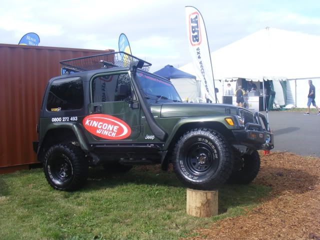

its finally arrived, my new work 4x4 :)
all shiny at Central Districts feildays earlier this year:
then took it for a quick "test drive":
and thought it was cool so suggested it would make an ideal company 4x4 for me :)
so now hopefully i will be out and about at 4x4 events more regularly again!
its a 98 Manual , on 32 Maxxis Bighorns, 2 inch OME Sport Shock and OME Springs lift, ARB bars front, sides and rear, ARB diff guard, GME Radio, MAPECU chip and Tune, Safari Snorkel, Kingone 9500 winch with syn rope, Rhino Rack roof bars... (ARB lockers to come :))

very nice Euan , very nice indeed , glad to see ya came to your senses lol

Hell yea, welcome to the Wrangler family :D

Wicked stuff Euan

Went in and had a nosey today, very nice indeed, got all the bells and whistles

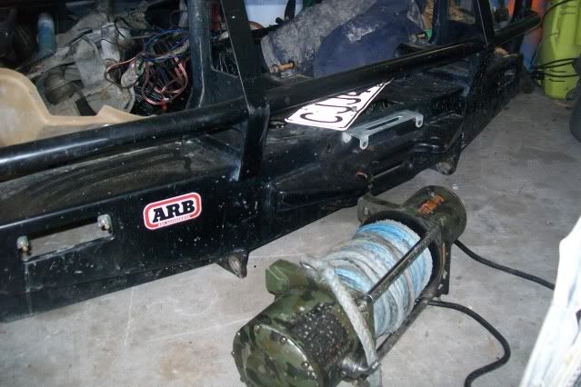

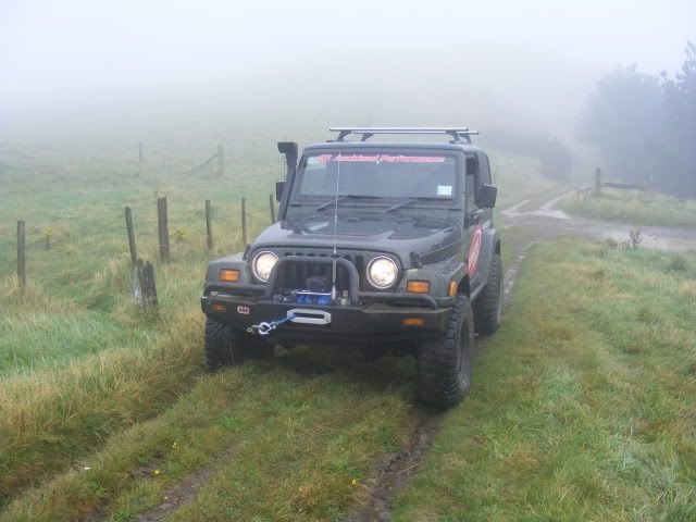

mine as it sits a month after the swim.........cant be bothered...
waiting on a converter.... plus axle seals , plus bits for the cooling system..plus gotta sort arb bar out may sell it , dont like it pain to get at winch........
