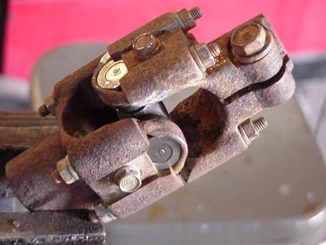

Does anyone know of any standard shafts extensions. I've spied this on TM [top one ;-)]
(http://www.trademe.co.nz/Browse/Listing ... =222842421)
It looks like the top shaft my be an inline extension but I'm not sure of the length and spline count.

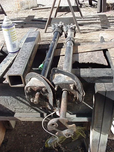

My options are:
1/ Try to find a longer slide joint shaft. My 60 series one extends from approx 46-56cm in length. 'sig' showed me one from a 70 series (from memory) that was longer. I'll have to measure everything up again but I think I need something that will extend up to 65-70cm. My options are to find an extension to go onto my 60 series slide joint shaft (possibly something like this - http://www.trademe.co.nz/Browse/Listing ... =222842421), hunt out a 70 series slide joint shaft - or hunt around for something else that I have yet to discover...
I've got an old 70 series one here with a flogged out UJ, it measures 815mm end to end and looks like its pretty close to fully compressed.... the slide joints seized so I cant tell the actual compressed/expanded length
I brought a 70 series tierod and draglink from toyota a couple of months ago and the list price (ex gst) was $40 each including freight from japan and they both came with ball joints on the end... might not be a bad idea to have a quick chat with the toyota man while your doing all this :mrgreen: :mrgreen:
Do you think there's any chance of getting this un-seized? One of these shortened and resplined could be the go.

cooksworld wrote:Do you think there's any chance of getting this un-seized? One of these shortened and resplined could be the go.
Yeah it should pop back out, you can see where it pulled out 20mm when I bodylifted the truck a couple of years ago. The UJ on the ends pretty flogged out though but you may be able to swap that end for your 60 series one

This is one of my other ideas - get 2x splined universal joints and combine them into one to do the joint from the 40 series column to the 'slide shaft' down to the PS box. I'd need to get the 40 series steering column shortened and splined (I understand a FJ55 column already has the splined end if anyone knows of one!)
See http://forum.ih8mud.com/co-wy-horsetoot ... ost1008695
[FJ55 standard column on the left]
