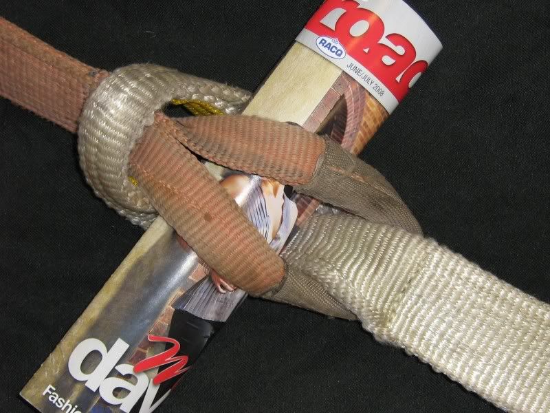

Pedro
Posts: 902
Re: Wish I Thought of That... Trail Recovery Hook
Post by Pedro »
DaveM wrote:
DieselBoy wrote:
Hahahaha, i almost bit :mrgreen: :mrgreen: :mrgreen:
x2 :lol:
well bite away,
what is the load rating of the timber??,
there must be a value of when it will shear off??,
from what i can figure out from the setup shown one eye is thru the other and the timber is the only thing stopping the eye coming back out,
the ropes are not in a "reef" knot configuration where the timber is only there to prevent the knot locking up on itself, the timber is taking the load directly between the two eyes
so its a valid question- what is the shear point of the wood :?: :?:
pedro
rokhound
Posts: 2558
Post by rokhound »
Not quite how it works, and needs a better pic.
But i spose it will blow you away to learn that it doesn't even have to be timber, I have used rolled up magazine to do the same job :wink: .
Both strop eyes are passed through each other, so yes, the strops are in "reef" knot configuration, and the timber is only there to stop them knotting together,
Smurf
Posts: 2868
Post by Smurf »
Pedro
Posts: 902
Post by Pedro »
Smurf wrote:http://www.4wdbits.co.nz/RopeJoinerInstructions.pdf
yup top photo is what was shown in the original post, please can some one define a "light tow" vs a "heavy tow" in option one the timber is taking the entire load, so if going for this option you need to know what it can take
pedro
T-Boon
Posts: 887
Post by T-Boon »
i`ve seen a trainer use a magazine (womans day) in the first method (Light Pull) it handled a lot of force, pulled his jeep out of ruts (that he made for demonstration purposes) and up a hill backwards without damage to the rolled up magazine. (admittedly off a tow bar looped under and over) was quite surprised, so as above i`d say the strops would break before the wood would ?
Anyone wanna get 2 junk cars and fire them away from each other at 50K to find out ? :D
To Boon or not to Boon.
Smurf
Posts: 2868
Post by Smurf »
I would never use that method shown, I have seen it used off road and the green branch that was used disintegrated with very little load on it.
I have used the other method where both ropes are threaded through each other with the wood to stop them binding. even if the wood lets go the two ropes are still attached to each other and can't go flying. Just means you have a heck of a job separating the two ropes once the wood has given way and the ropes have tightened
dazza85
Posts: 938
Location: Hastings
Post by dazza85 »
rokhound wrote:Not quite how it works, and needs a better pic.
Like this ...
