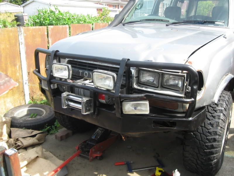

Todays progress:
Mounted the fairlead and gave the whole bullbar a coat of paint.
Looks good with the spotlights in there
Really need to fix up that bung passenger side...

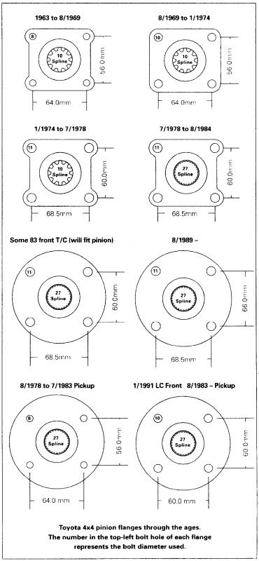

Re: Andrews 80 Series Cruiser tidy up
You cant redrill those square ones but you can redrill the round flanges to fit
somebody should have one, 60, 70 and 80's have the round flanges
- Andrew1706
- Posts: 716
- Joined: Wed Nov 28, 2007 12:00 pm
- Location: Auckland
Yeah this one is a 60 front, older sixty front had square front and round rear pinions, new ones the other way around.
The 60 cable locker had a round flange and obviously the 80 lsdI pulled out the best one

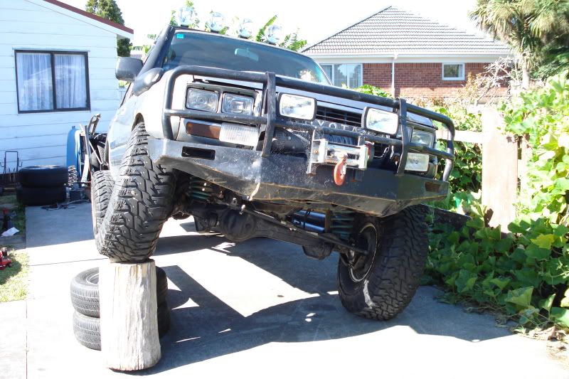

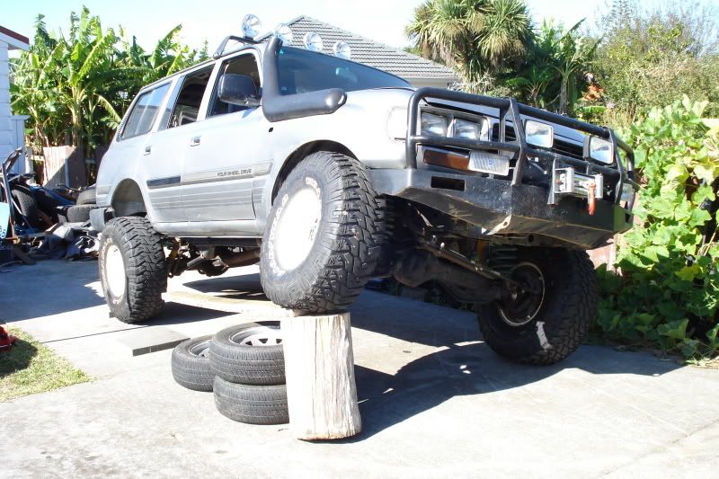

NZ NEW 80 series
front = 2" dobis @ 1" actual + 2" coil spacer = 3" over JDM
rear = factory + 2" coil spacer = 3" over JDM
35x12.5 MTRs on 15x10 - hence the slight guard rub in the last photo ... would be sweet on 8" rims...
650mm under front right wheel, left rear has little weight on it but still grips - possible 700mm under front wheel?
Also got not quite enough 3" stainless for a bit of a side exit but we'll see how the next couple of days treats me...

Measures pretty much 600mm on all 4 corners +/-10mm
No flares but I'm not sure they make much of a difference.
All the figures I've seen on IH8MUD suggests that stock is 20" whereas my truck is 24" hence the 1" higher NZ NEW thing...

Got a round flange the other day thanks to Te Puke Partsworld.
Pulled the other one off and what do you know, course spline
Was told this when I got the diffhead but had fingers crossed it was going to be fine spline.
So need to do a bit of machining and welding and join the two together then down the line change diff ratios and go back to a fine spline
Here's a handy picture:

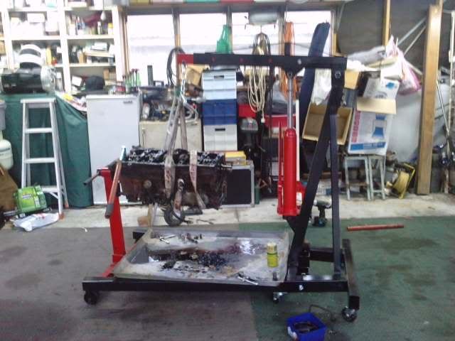

Well so far I've broken the winch

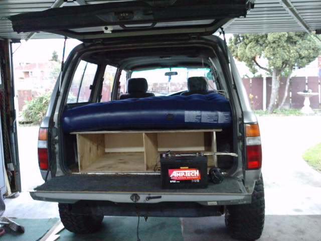

Started a bit of a box in the back

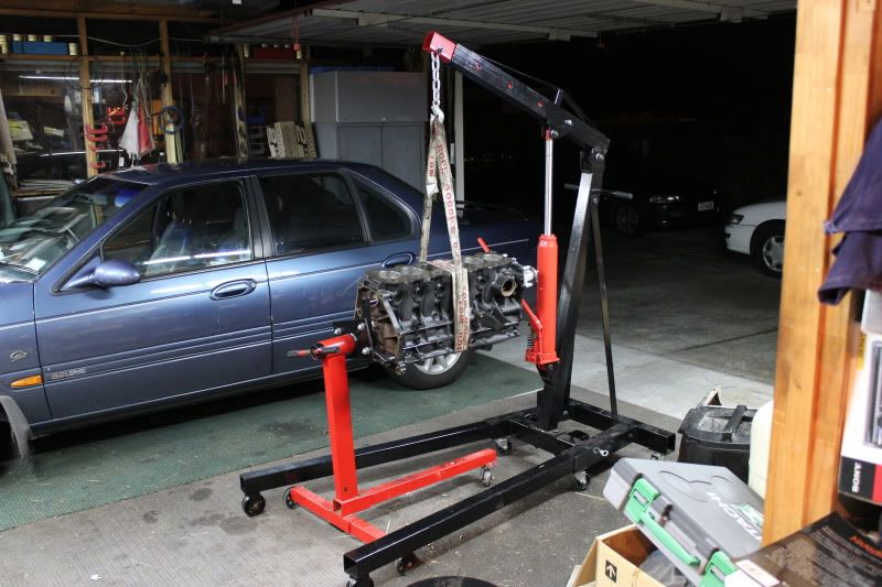

Pulled the motor out

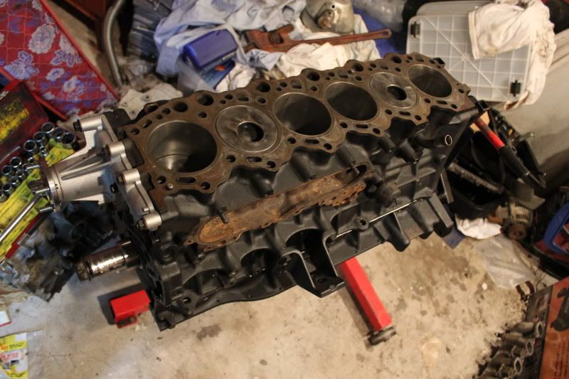

Got the head off, visual inspection so far shows no obvious signs of damage
But noticed this shit on the #2 injector when it came out, it's also on the head too - anyone know what it is?
Carbon build up??? I have seen that before on some of my Datsun motors that I have rebuild......
Oh yeah plenty of carbon build up in all cylinders but I've got no idea what the white/brown stuff is....

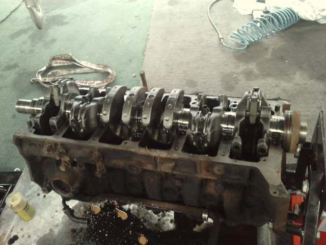

Bigends not toooooooooo bad
Off to recon shop tomorrow!

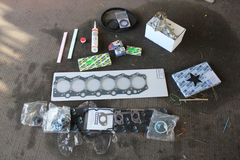

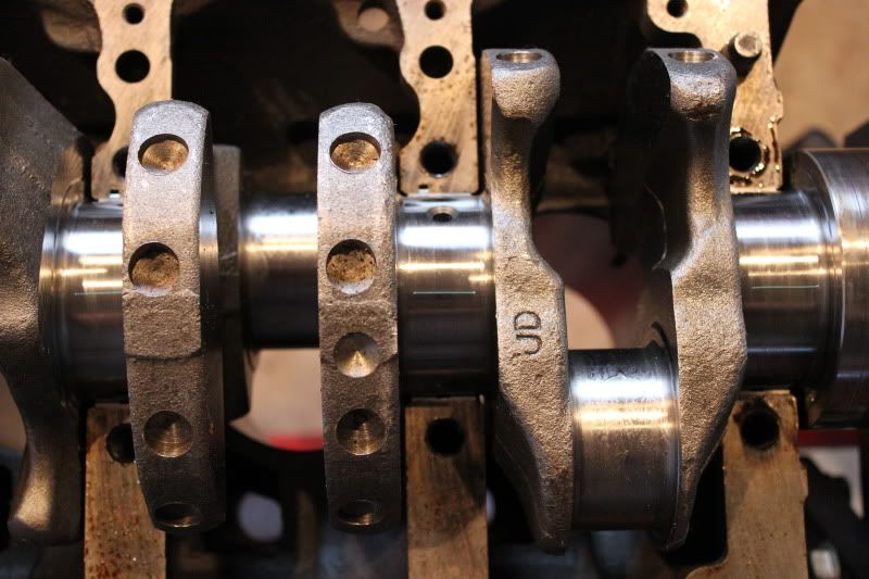

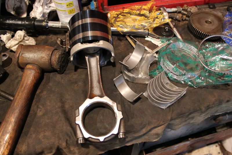

Well well, long time no see
Parts:
Plastigauge:
My engine reconditioner said that the mains and big ends were on the STD bottom limit and he was happy to keep them where they were instead of grinding to 0.25 and I should expect a little extra clearance which I got and was within Toyotas limits
All good, so torque to 103NM then turn a further 90 degrees
All done
Just waiting on a ring set and everything else can go back together
Parts:
Plastigauge:
All done
Goddamn heavy engine and shitty crooked engine stand!
Haven't even got half the weight of the complete engine on there and it's sagging and bending
Andrew1706 wrote:Haven't even got half the weight of the complete engine on there and it's sagging and bending
What does a cruiser engine weight???
