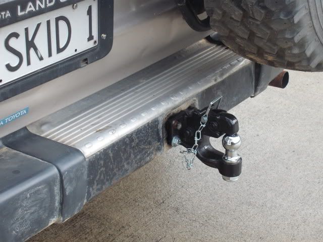

I went with option 5....................
have snatched a few trucks heavier than mine and also 2 cruisers at the same time
never had issues, so far it seems as strong as and also has other benefits as well, like being able to tow trailers and also being able to put a strop on and not have it fall off

skid wrote:I went with option 5....................
Were do you get one of them from and cost??
Re: Blair's 80
http://www.offroadexpress.co.nz/content/towbar-services
