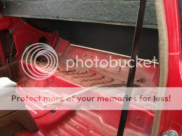

well this is what i been up to for the last month or so, rust repairs and finishing this ute chop. All done and cab all enclosed now with my custom fibreglass liner. Am going to mount the spare to 1 side and have tool box against the other side.
Heaps a dry storage on the inside behind the seats.

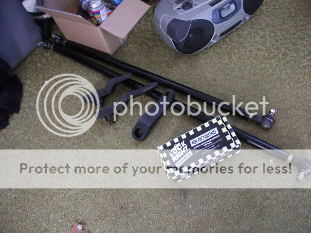

whats peoples opinions on 2 and 4 spider hilux diffs? are 4 spiders that much stronger? is it worth fitting a 4 spider over a 2?
rokhound
Posts: 2558
Re: chopping and modding yn60 hilux surf
Post by rokhound »
Short answer. Hell Yes!
suzolla
Posts: 1577
Joined: Mon Jun 13, 2005 12:00 pm
Post by suzolla »
Hi rok,
Is that because you think only having 2 spider gears is weaker than having 4 (obvious I guess :) ) or because there is only one cross pin with the 2 spider.
What is your opinion when fitting a Lockright locker considering that for a 4 spider diff the original side gears are used to engage with the lockright center, whereas with a 2 spider the side gears are replaced as well hich I think would be stronger than the 4 spider arrangement.
ie is a single cross pin stronger or weaker than using the side gears as part of the locker assembly.

ive always heard 4 are allot stronger but have never played around with both and investigated as such,also never had a power plant big enough to do damage but ive sourced 4spider 4.5s to go in with my chev as a posed to 2 spider,interesting about the locker comment with replacement gears,had not heard this before
rokhound
Posts: 2558
Post by rokhound »
The 4 spider has bigger bearings in the Crown wheel and the pinion.
I am not a fan of the way the lockright works on the side gears in the 4 spider unit, but it is damn easy to fit. So in short the 4 spider is a stronger all around unit and considering the hiding most active 4wd's give their drivetrain, stronger has to be better, yes?

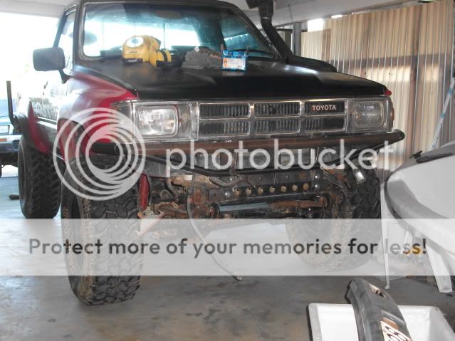

all tacked up now, ready for the old man to do all the welding, decided to keep it tight and follow lines of the grille and vehicle, not bad for my first time at doing bar work
muddyhilux
Posts: 1307
Location: auckland
Post by muddyhilux »
nice bar work mate,very tidy 8)

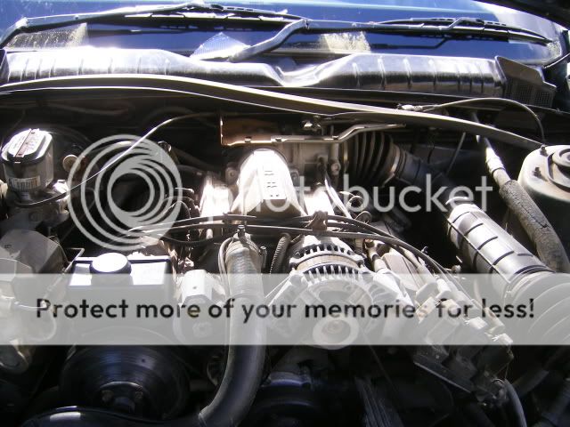

just went and looked at a VR comy with a mere 158ks on the clock, damaged but driveable, he will take $400.
Ill be able to make money when i sell the parts, free motor 8)
