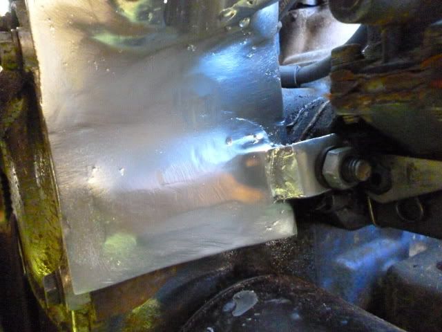

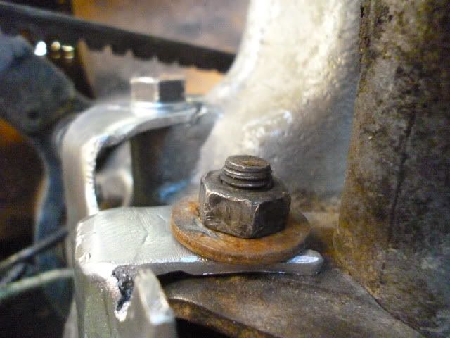

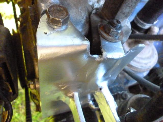

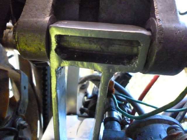

Rightyoh, the alty mounts are done for now. Look a bit shoddy, but I don't care.
Next is the alty wiring, then brakes, clutch etc later on.
Pics:
Bottom of mount:
Top right of mount (to dizzy pinch bolt), it's a prong type thing, so the mount can be pulled out (not up):
Main body of mount:
Top of mount:
The top mount looks basically the same, so no new pics of that.
It's all 5mm steel, except for the main body of the bottom mount, which is 3mm.

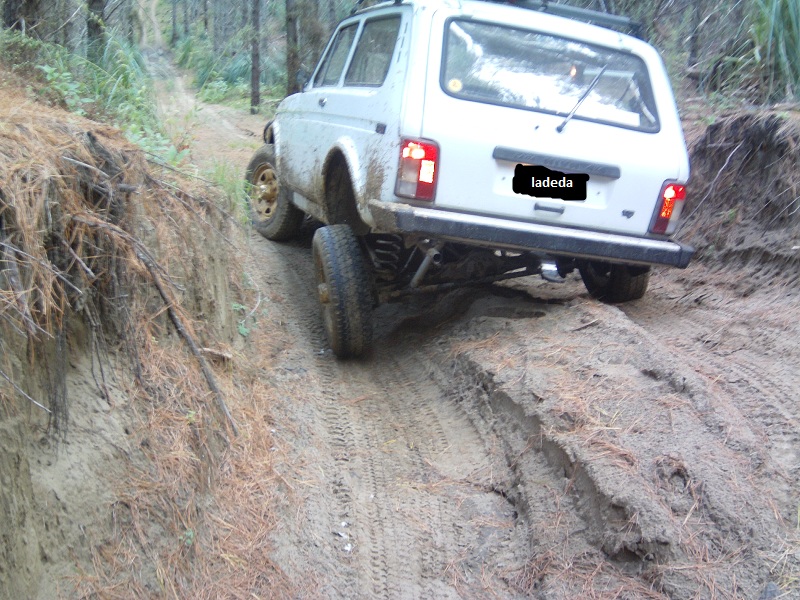

Re: 1990 Lada Niva
how what?
how did I get that much flex? longer shocks
how did I get to woodhill? I drove there
how did I actually manage to get a lada running long enough to take that pic???..................
I have no Idea
I have no Idea

Re: 1990 Lada Niva
ladeda wrote:how what?
I have no Idea![]()
Bahaha so true.
I'll have to get some longer shocks for mine. And are your springs captive? Or do they come loose at full flex?
And you got some shocks with the same compressed length but longer extended length right?
Oh and in relation to guard chopping, I didn't chop mine at all. I just beat the lower edge of the arch so that it is pointing upwards on the inside of the arch. It only rubs a little bit at the front now with those 30.5s

SP yea man longer extended and same length compressed. still hits bump stops before fully compressing shocks. cost me around 120 the pair I think. took orig one into appco and they matched it.
springs a bit loose only on full x axel by about an inch after having spacers in there. they relocate themself with no porb everytime tho. may oneday get some slightly longer springs. but tyres first.
with your wheels the rear of the rear arch and the front of the front arch hit on mine. i might just giv em da bash aswell for now just to get going and chop em up later down the track.
