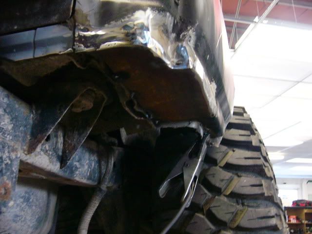

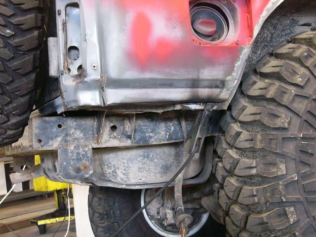

cut a rear guard 35mm and ramped 37" tyre just touched with 15mm left to bumpstop so going to extend bumpstop 25mm front end has 25mm to already extended bumpstop yet to cut guard so should work out as planned so far...........

well bumpstops done 45mm trim on rear guards so 37s tuck up nice just.... 25mm off front heaps of room there will do pics next week after welding of inner skin and 8mm rod to stiffen them..........

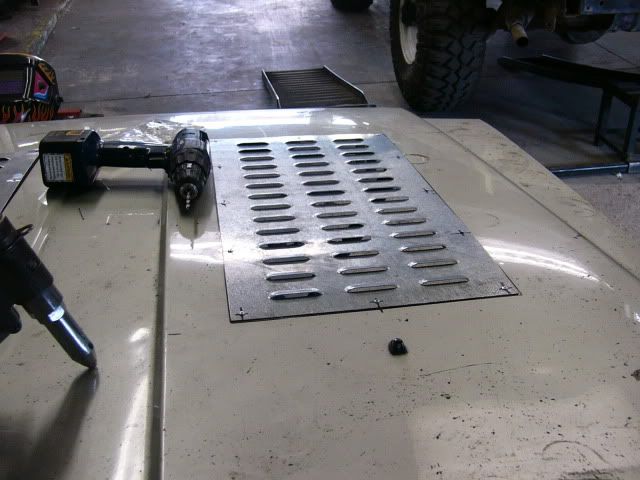

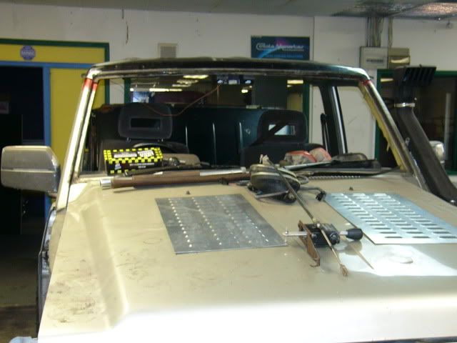

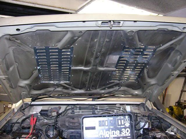

had a couple hours today so chopped lwb roof up to do this............
fark drilling spot welds is a pain........

Dude, those louvers are sweet.
Where did ya find those?

nup used to work for a crowd who makes em for electrical transformers so called a favor in just happens they do powder coating as well..........

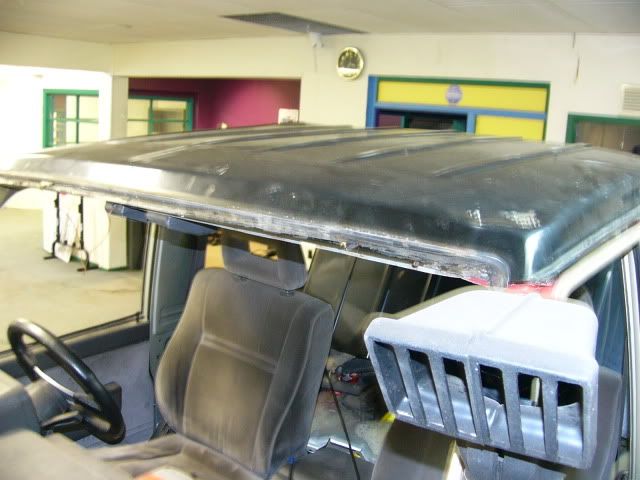

taz01 wrote:fark drilling spot welds is a pain........
Do you have a spot weld drill or have you just ground the angle down on a normal drillbit?

I remember seeing a spotweld drill bit thingy on tardeme a while back.. makes for drilling them out simple as.. May be worth ya while having a look..?

just used an 8mm drill CAREFULLY not to go too deep but not worried if i did as have too drill holes to plug weld roof on anyway also a brickies chisel sharpened works a treat cut though spots ya missed too
got anti vibe painted on inside today better now than trying to do it upside down ..........

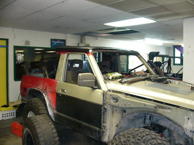

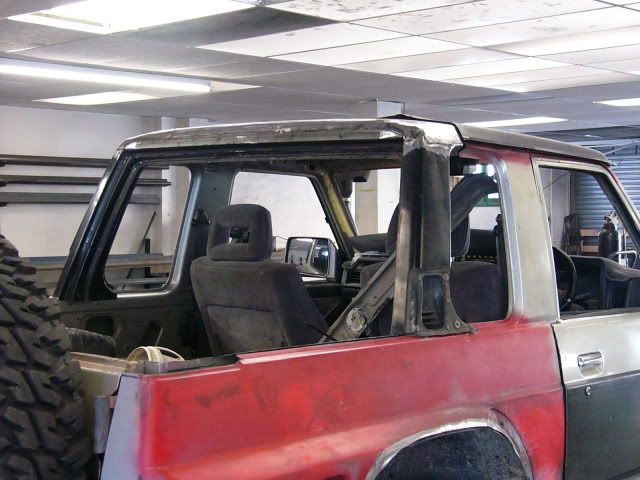

wee bit of progress this weekend............

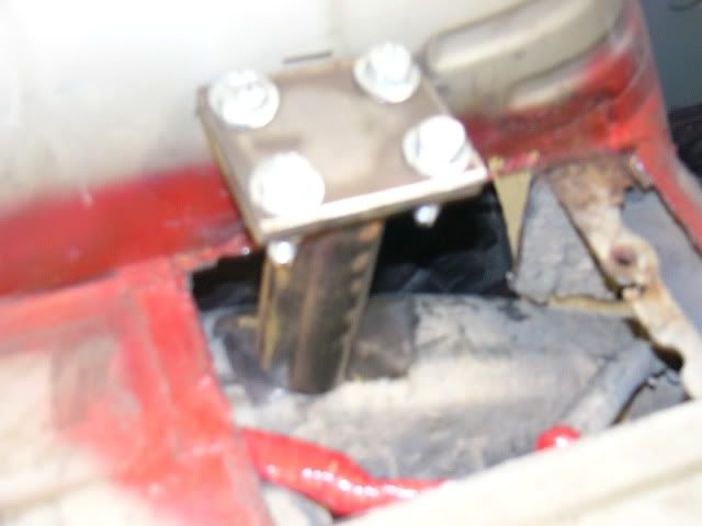

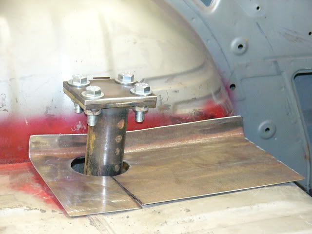

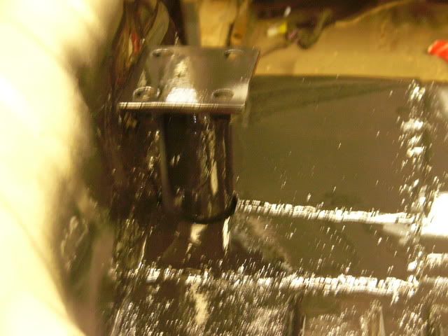

started brackets for internal cage only done 1 was chasing rust spots with welder..... :lol:
