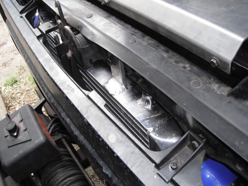

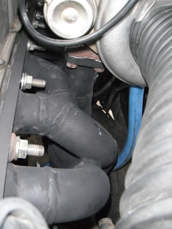

Just built this for a rice rocket. 4mm wall steam pipe. Thinking of setting up a jig for TD42 and making a few.

Ok...its finsihed...and photos are going to be posted soon...but they are only of the finished product.
Findings are...woohoo...its a heap better.....its goes very well now...and I am stoked. Next issue is the clutch......lol.......its slipping already.

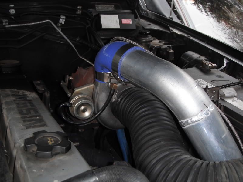

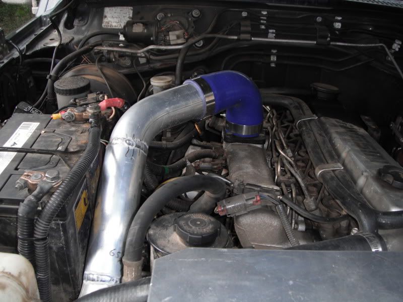

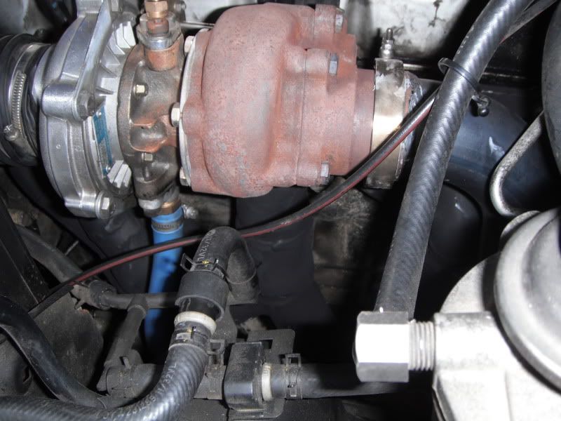

Finally....pictures...although its hard to take pics when its already in

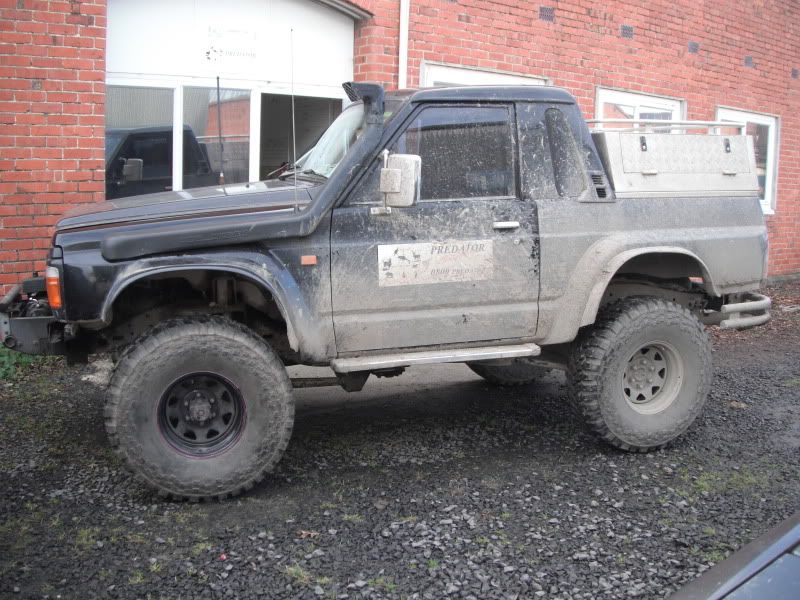

Ok.......I have the truck back..finsihed with new suspension.,.....body lift......bars need finishing...and thats it. I cant recommend Corey from Downtown Auto Wreckers enough.....his prices were amazing.....3k to build the manifold.......and intercool the truck...........complete with new 3inch exhaust all the way through......and 3.5k to redo suspension....body lift.......and install heavy duty clutch.

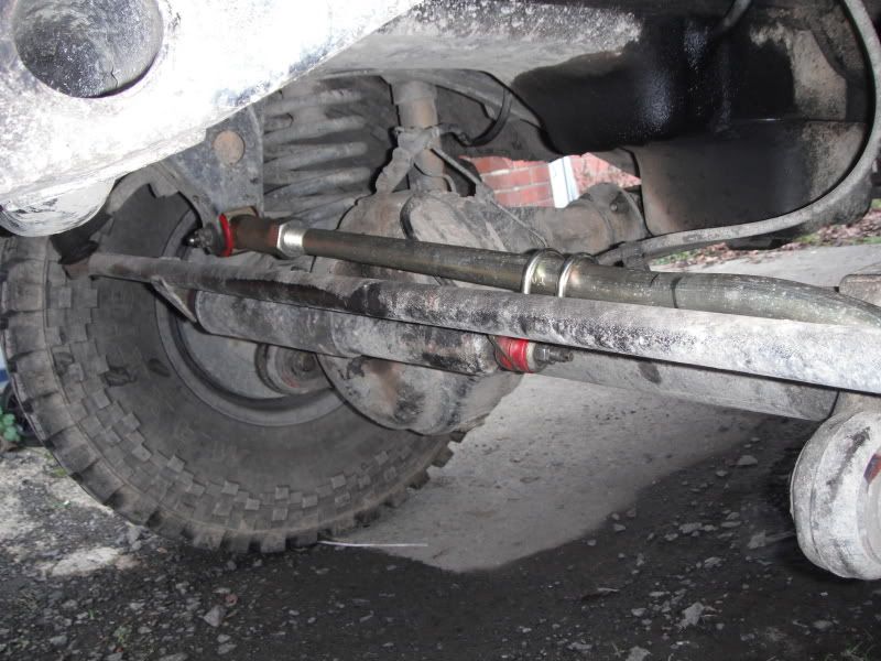

The red nolathane bushes in the panhard rods aren't very good and will chop out with use and give the "Nissan Death Wobble". Chuck some genuine Nissan rubber bushes at it soon.

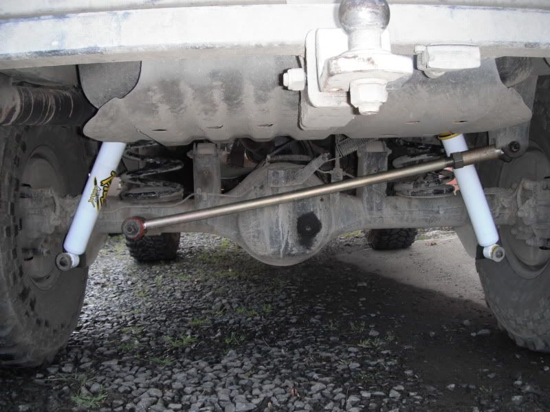

What susp lift has it got? Lift the bracket for the rear brake proportioning valve if the lift is more than 2".

Re: Sick of it....time for options
GQTROL wrote:The red nolathane bushes in the panhard rods aren't very good and will chop out with use and give the "Nissan Death Wobble". Chuck some genuine Nissan rubber bushes at it soon.
Cool...I will get that sorted....I presume they can just be sourced from a Nissan dealer?
And...."Rear brake proportioning valve"..???? HUH?? I will get Corey to look at it

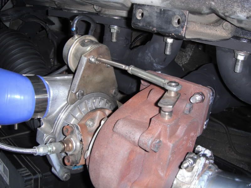

Get your injector pump done as well, then you will see POWERFULL!!!!

DieselBoy wrote:Get your injector pump done as well, then you will see POWERFULL!!!!
Ok...what am I getting done to it...just serviced...or??...Cheers
extreme_treeman wrote:Cool...I will get that sorted....I presume they can just be sourced from a Nissan dealer?
Bushes direct from Nissan. Do a search, I've posted the part numbers for them on here previously.
Proportioniing valve is the dog-legged shaped bracket on the top of the rear diff (in the 2nd to last pic) with spring attached. The more tension on the spring, the less bias to the rear brakes is applied. So lift the bracket where it attaches to the rear diff (those 2 bolts orientated vertically) to take some tension off the spring. Lift the bracket by the amount the susp is lifted. Most just take the spring and bracket off and chuck it away. Your call......
Re the injector pump, some folk modify them with a larger diameter rotor and plunger for increased fuel potential. But depending on the turbo, it can be a waste of time if you don't have the cfm to match the additional fuel. helps that you've already intercooled though. Standard GQ (Y60) pump uses 10mm plunger, early GU (Y61) uses 10mm also, later GU's use 11mm etc.....so simplest is to throw a late GU pump at it.
If you mod your standard pump, then can also add an aneroid to sweeten up the fuel delivery and reduce black smoke down low / from start off etc. Turbo pumps already have the aneroid.

Hi were abouts did you get your panhard rods from? They look gruntier than the efs ones I am about to buy.
Thanks Simon
GU patrol 35s ect.

They were sourced from Auckland (cost 1100).....Corey does however have a set there that are second hand for $600 if you are interested.
Mud Hog wrote:Hi were abouts did you get your panhard rods from? They look gruntier than the efs ones I am about to buy.
Thanks Simon
They look like Tough Dog units.....but they usually come with genuine Nissan bushes already in place.
