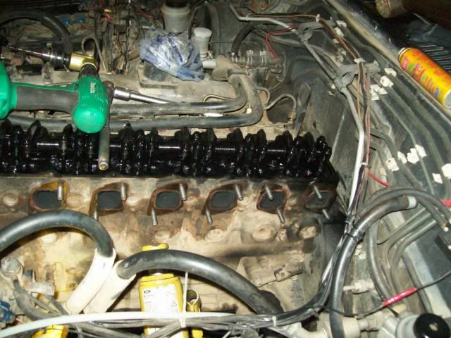

Mate I had a bunch of studs on my head snapped off. Ended up pulling the head and did 4!! Easy outs did not work even with the head off. Found drilling till close to stud size then put a tap in there and start tapping if your holes centered after about 1 - 2 full turns the whole stud turned then backed out the tap and the stud was stuck to it and wound out. Worked that way for 2 of the worst ones but your hole has to be central. good luck. Snapped studs really suck!! BTW I also have a water to air cooler and subaru rad etc if your interested. Cooler has never been used. Going to air to air.

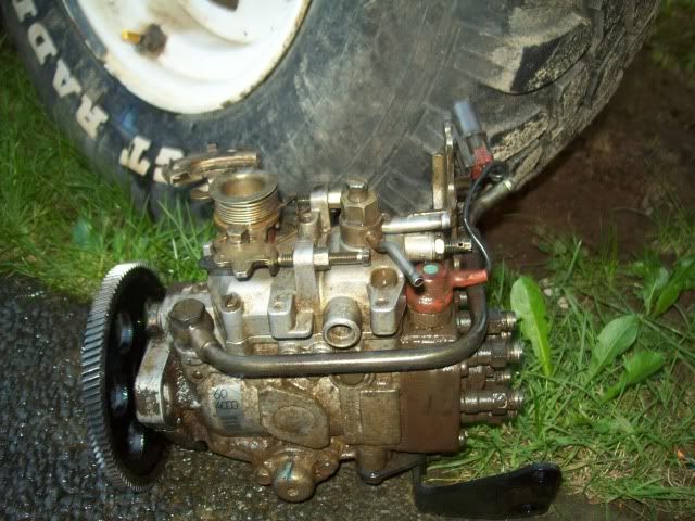

got the pump off better working in day light and warm

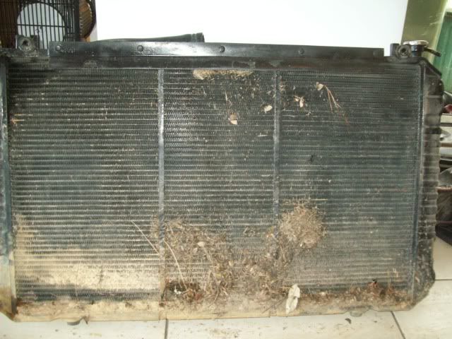

took radiator out as well full of crap the joys of bush bashing

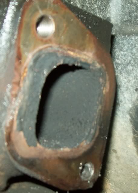

and where we are with that stud

had a talk to diesel mac next door, his idea undo engine mounts shove engine over to get better drilling angle,if all fails pull the engine rather than the head to get the stud out

coxsy wrote:the stud is two threads in, fa to weld to, so unless i go to bigger drills to get the whole stud out, its a fair pain in the butt, all so drain the radiator , and pull it out so i can get a puller in there for the drive gear,nothing has been touched on this engine for years
can try those reverse type drill outs instead
assuming you can actually get a drill in square, make a drill bush that bolts to the other holes, and aligns with the center of the broken bolt, and then drill out,
also studs generally work by the non threaded part "jamming" into the thread off the hole, drill Stud size or 0.5mm bigger approx 1mm deep, this should loosen the locking effect of the stud and enable it to wind out.

stud drilled and tapped, new studs in oil fed in manifold next , the list goes on

I hate to tell you this since you've got the stud out, but when my one broke it was further in than that and we welded to it. Built it up with weld first then welded a nut to it and it came out really quick and easy. All up once the manifold was off it took about 10 minutes.

been to see my diesel and pump guy, the pump starting to look like a pump not a tray of peices

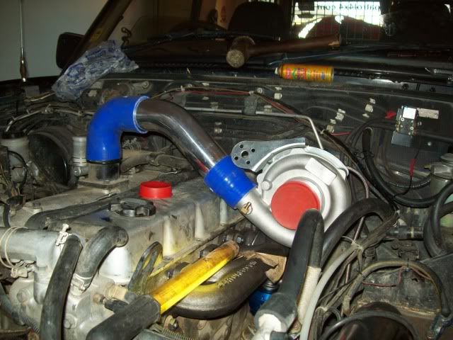

got my torrano air cleaner modded and welded the dump pipe up, got james to do a measure last night as i lay under neath with the bend to get the lenght added 20mm just in case lol 20mm to long and need to rotate it a bit but only tacked so no major, found the double zz timing marks today too

Re: my turbo fittment

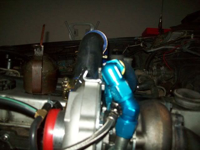

no need have enough room to get 2.5'' passed to shaft so running with that for awhile
had to add a 45* fitting to get the water house off the exhuast housing
and a view from underneath
its still temp sitting at the mo
